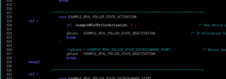

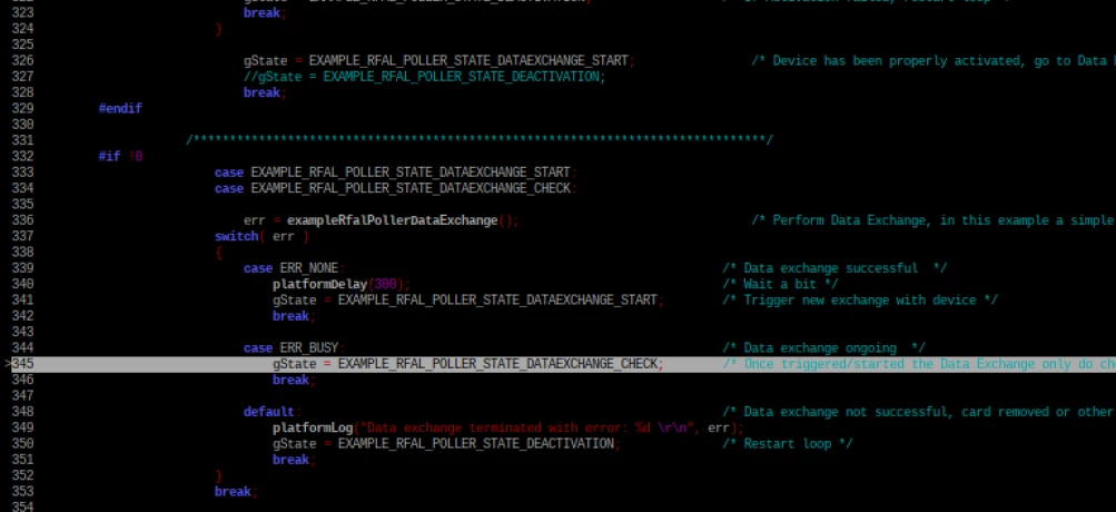

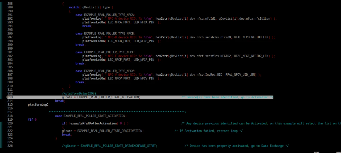

0693W00000QKb2wQAD.png I set a breakpoint at exampleRfalPollerRun and step through(actually "next" not "step"), and it seems like everything runs normally up to this point here, where collision avoidance completes and gState is set to activation:
0693W00000QKb49QAD.pngOn hitting the switch statement again, it should go here, Rfal activation. (That gState data exchange start line comes commented out, I'm assuming for demo mode?) But it doesn't even get there:

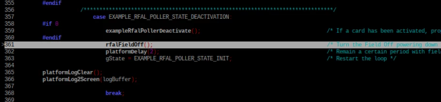

Instead it looks like the "#if 0" fails, and the program skips everything down to here, turning the field off, and from that point it just restarts the loop(edit, it's likely this is intentional, and just a way of block commenting stuff out):
By changing exampleRfalPollerRun to invert the #if 0 and uncommenting the activation line I can force it through, like so:0693W00000QKbBjQAL.pngBut even then, the data exchange just starts and throws a "busy" (err = 2 in exampleRfalPollerDataExchange) before exiting with error 4(time out).

The Polling demo by default basically lists the UID of the cards/tags identified.
Please be aware that that package was released ~5years ago and it may not be the best reference to base your work (also the drivers are outdated).
The demo has indeed some disabled/commented/excluded code by means of the preprocessor directive #if 0.
If this is somehow unclear to you, I would suggest to refer to additional documentation on the topic (e.g. GCC, Wikibooks).
If you enable those code blocks the demo will continue and activate a card.
In case it's a T4T, it will try to exchange an ISO7816 APDU.
As you are using an ST25TA, which NDEF formatted, the first command to be send should be a Select NDEF Application. You would need to update the APDU packet (t4tSelectReq) frame.
Nevertheless, that demo exchanges a single frame as an example, but it is not a complete implementation of NDEF or any other higher layer application.
Unlike others T4T have a complex organization of applications, files, data blocks, that need to be understood and navigated.
