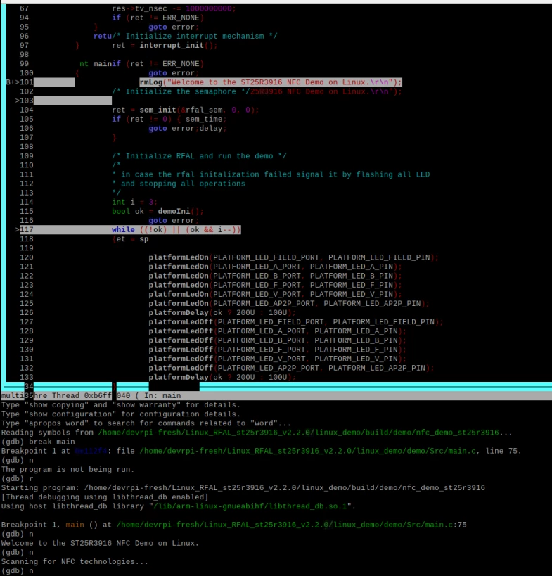

Ok, So I set a breakpoint at main in the built demo and stepped through- it's looping starting at line 117 as shown below. 0693W00000Nt4TnQAJ.png Running the executable seems to only bring up main.c- and GDB won't open st25r3916.c on it's own. I'm guessing the program jumps to st25r3916.c at some point? But I'm not getting there currently.
Brian TIDAL
June 29, 2022
if you do not feel confortable with gdb, I suggest you modify the demoIni() function in demo_polling.c file to add
platformLog("rfalNfcInitialize err = %d\r\n", err);
just after err = rfalNfcInitialize(); (line 182)
If you see err = 4 on the console, this means the IRQ handling is not working properly.
Rgds
BT

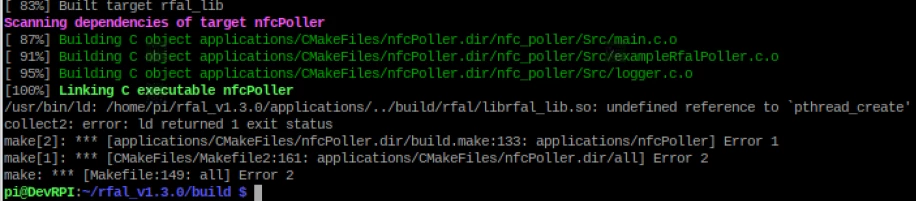

I've tried to build ST25R009 but it keeps throwing the below error, an undefined ref to "pthread_create":
0693W00000QKU7kQAH.pngMy process was first extracting the zip(.xz) file to the home directory, then running "cmake .." and "make" from within its build folder, similar to ST25R0013, which resulted in the output above.
After doing some research I updated pthread using apt-get(it was already the latest version), and tried "make -pthread" and "make -lpthread" when building, with no change.
Ulysses HERNIOSUS
July 5, 2022
please check if you have libpthread.so in your file system. Please also share CMakeLists.txt and the generated Makefile. Also share the output of the cmake call.
Best Regards, Ulysses

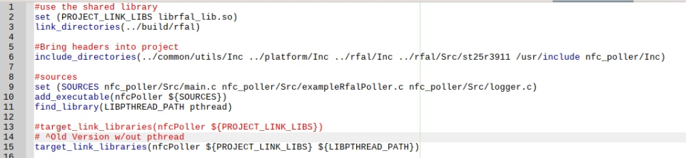

In .\en.STSW-ST25R009\rfal_v1.3.0\applications\CMakeLists.txt, can you add:
find_library(LIBPTHREAD_PATH pthread)
and modify the last line of the file to:
target_link_libraries(nfcPoller ${PROJECT_LINK_LIBS} ${LIBPTHREAD_PATH})
This should fix your issue (I cannot test on my side but this should be close to the solution)

JMilk.1
JMilk.1Author
July 5, 2022
Thank you! After making these revisions the tag was picked up by the NFC Poller! Below is the result:
0693W00000QKUeAQAX.pngHere is Cmakelists.txt:
0693W00000QKUeFQAX.pngAnd attached is the makefile>
