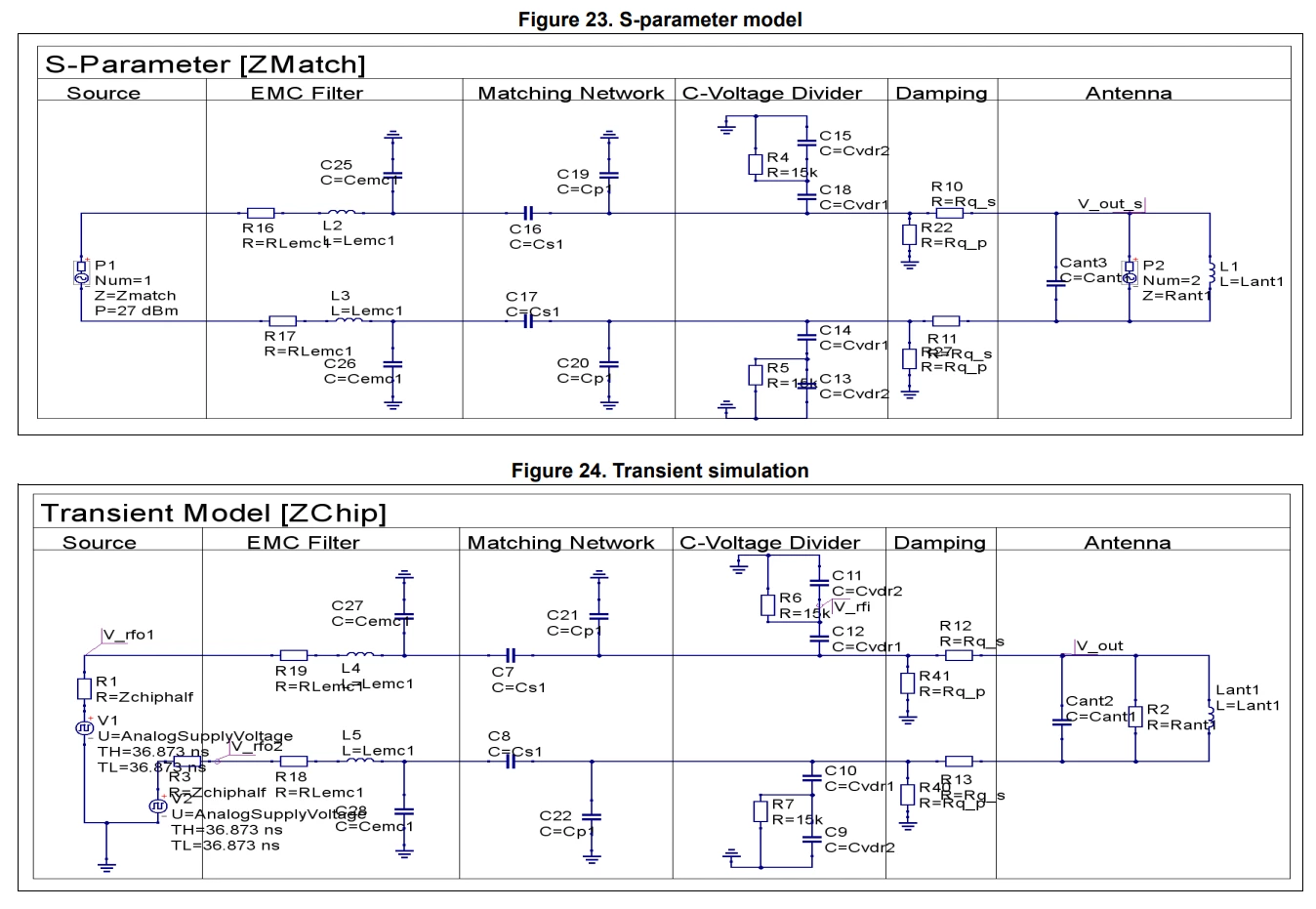

In AN4974 (antenna matching network for ST29R391x device), In chapter 6.2.1 in Simulation S-parameter and Transition model, what is the tool used for simulation in this case?
Best,
Dalik
Brian TIDAL
October 20, 2023
you can download the STSW-ST25R004 (Antenna Matching Tool for ST25R NFC/HF reader family) package to performs transient, AC, and S-parameter simulations of the calculated antenna schematic.
Rgds
BT
