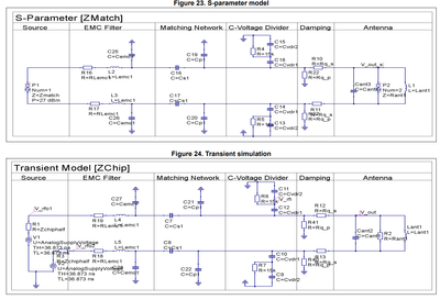

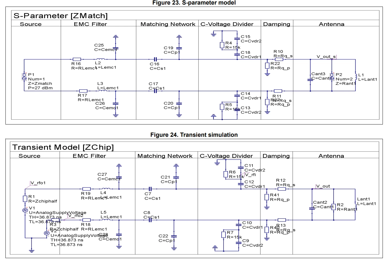

In AN4974 (antenna matching network for ST29R391x device), In chapter 6.2.1 in Simulation S-parameter and Transition model, what is the tool used for simulation in this case?

Hi Dalik,
Qucs is used (also comes included in our Antenna Matching tool(STSW-ST25R004).
BR, Ulysses
