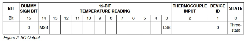

Hi @帅 罗​​,
25 is not the correct value expected from the sensor.
From the Datasheet :
"The first bit, D15, is a dummy sign bit and is always
zero. Bits D14–D3 contain the converted temperature in
the order of MSB to LSB. Bit D2 is normally low and
goes high when the thermocouple input is open. D1 is
low to provide a device ID for the MAX6675 and bit D0
is three-state.
_legacyfs_online_stmicro_images_0693W00000bkGrnQAE.pngIf you don't know the value read from the sensor you cannot determine if the error is coming from the conversion, or from the SPI read or other things.
Please use debug session or a console log to get the RAW value coming from the sensor.
Kind Regards.

Hi,@Rene Lenerve​
As far as I know, the data is composed of 12-bit precision and transmitted by SCK. As long as the data bits are needed, the 12-bit precision data will be transformed as follows to obtain accurate temperature data.
float MAX6675_ReadTemperature(void)
 return (MAX6675_ReadRawValue() *1024.0/4096);

Hi @帅 罗​,
Yes the temperature sensor is an ADC and data are transmitted through the SO line as the SCK is the clock, and what I'm asking since last messages is the value of the RAW value gets from the SO line.
Without it, I couldn't be of any help.

Hi,@Rene Lenerve​
I checked the instructions and I knew it was made up of 12 bits of data, but the actual raw value fluctuated between 0 and 0xff, so the MAX6675_ReadTemperature function converted it to a temperature measurement

Hi @帅 罗​​,
The raw value may be of 16 bit so you miss half of the data.
"D15, is a dummy sign bit and is always zero", "Bit D2 is normally low and
is three-state.
Max value "should be something like 0x7FF9.
Kind Regards.

Hi,@Rene Lenerve​
The ADC adds the cold-end diode voltage to the amplified thermocouple voltage and outputs the result of 12bit to the SO pin. For a series of zeros, the temperature is 0 ° C, and for a series of ones, the temperature is +1023.75 ° C.

Hi,@Rene Lenerve​
I found that the problem is caused by incorrect SPI initialization settings, which causes the data to be garbled.
