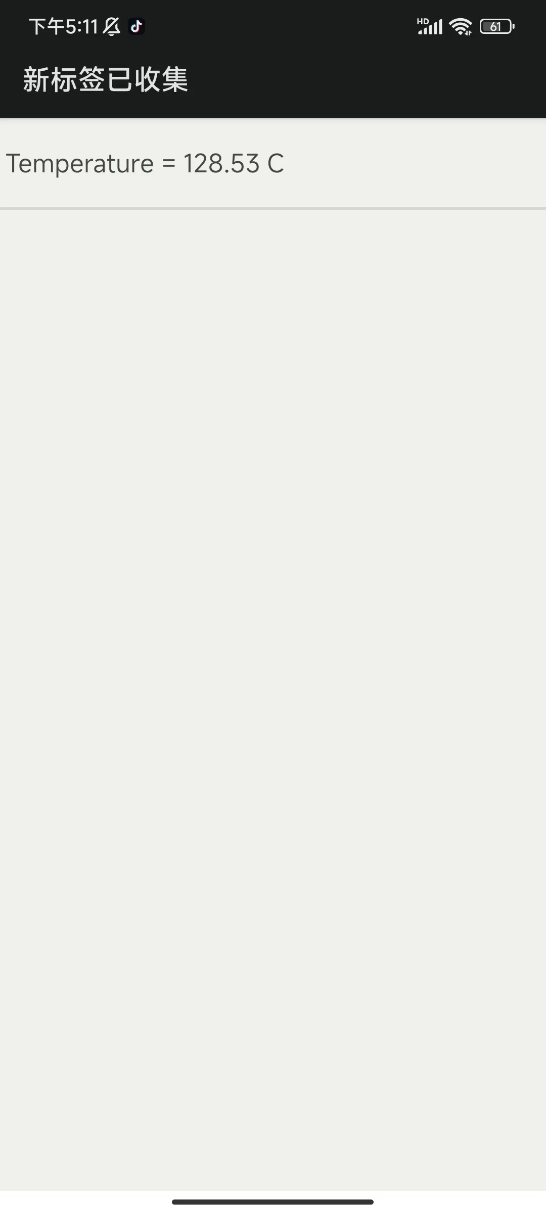

If my data collection is normal, will the following conversion methods affect the accuracy of data results?
float K_Temperature ; //K型热电�?� 温度值
char temperaturebuffer[30] = { 0xD1, 0x01, 0x1B, 0x54, 0x02, 0x65, 0x6E };
void MX_NFC7_NDEF_URI_Process(void)
	 /* Write NDEF to EEPROM */
	 HAL_Delay(1000);
	 K_Temperature=MAX6675_ReadTemperature(); //读�?�热电�?�温度值
	 sprintf(&temperaturebuffer[7], "Temperature = %.2f C", K_Temperature);
	 NfcTag_WriteNDEF(sizeof(temperaturebuffer) + 1, (uint8_t *)temperaturebuffer);

Schuyler
SchuylerAuthor

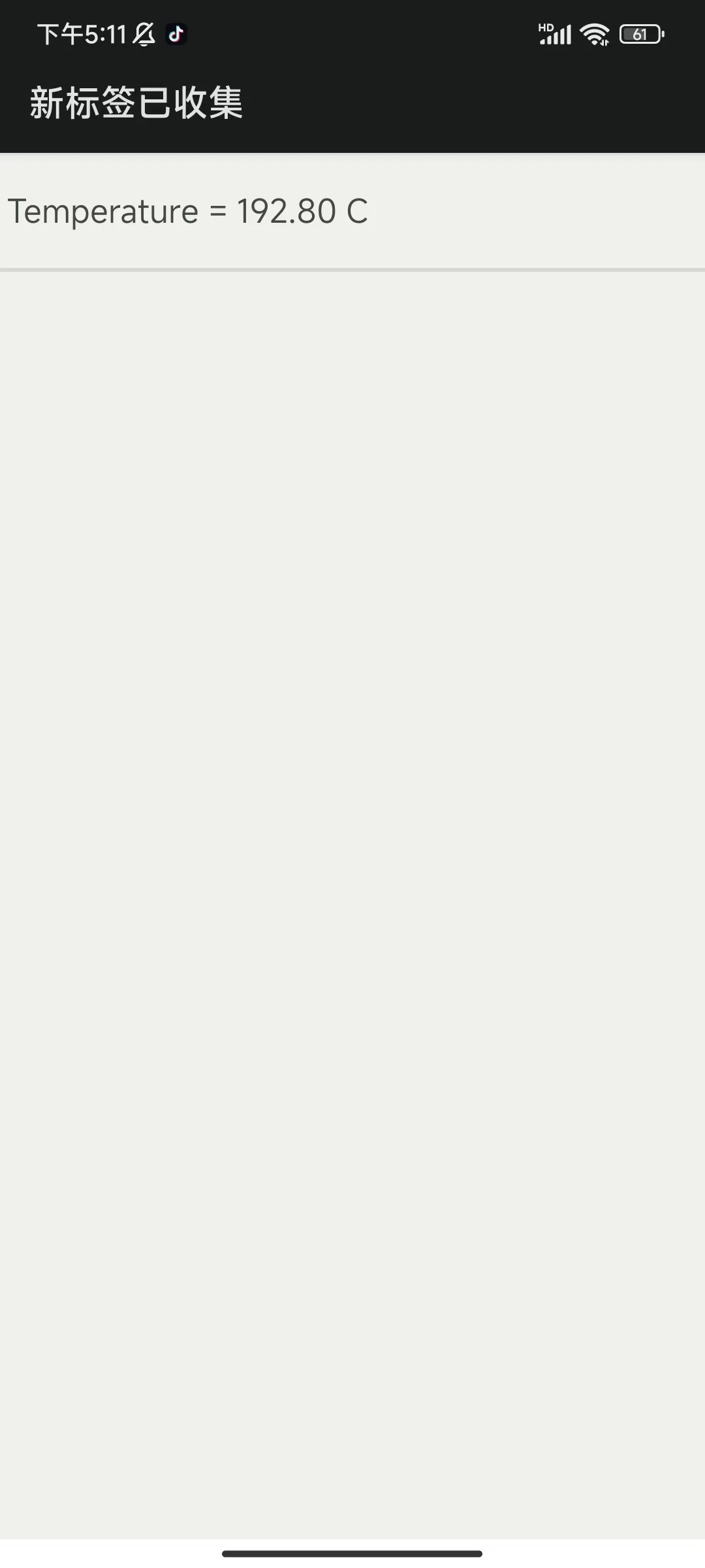

May 17, 2023
Hi,@Rene Lenerve​
That's not true,My sensor measures the air temperature, but the phone is reading several hundred degrees,so I think there is an error in data conversion or NFC reading the conversion string affects the data
Rene Lenerve
May 17, 2023
Hi @帅 罗​,
Can you give us this value read from the sensor?
Kind Regards.
Schuyler
SchuylerAuthor
May 17, 2023
Hi,@Rene Lenerve​
The data is read by the phone app and fluctuates in a three-digit range, with the correct number in the 20s.

Schuyler
SchuylerAuthor
May 17, 2023
Hi,@Rene Lenerve​
The value read from the sensor is about 25 degrees
