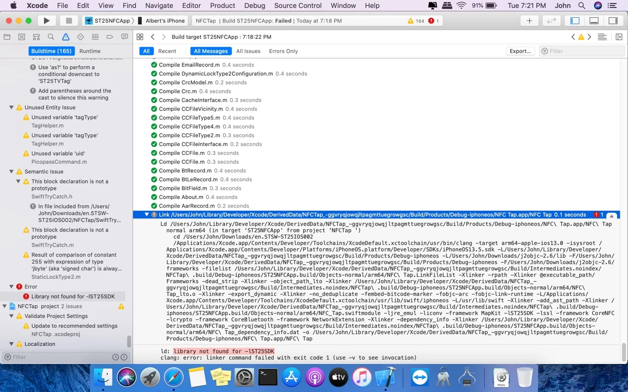

    AlbertCJohn
    July 7, 2020
    Thanks Vincent. The compilation issues are addressed.
    Now we are facing error: Library not found for -lST25SDK
    victor laraison
    July 7, 2020
    Please, check value of Library Path into build setting, and verify that libST25SDK.a exists in NFCTap/st25sdklib
    Let me know

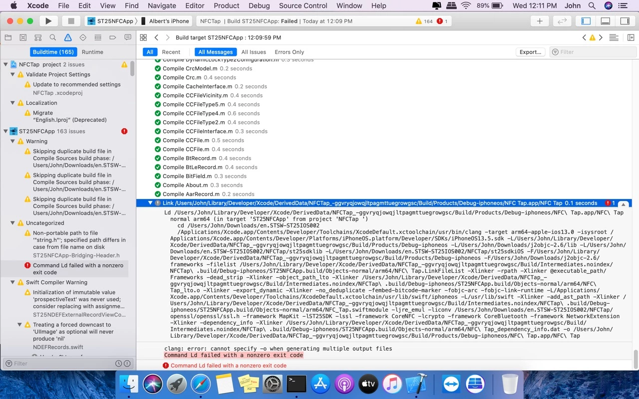

    AlbertCJohn
    July 8, 2020
    Hi Vincent, we are able to fix the library issue as per your advice.
    Here we are facing another issue in the process of building the app:
    Command Ld failed with a nonzero exit code
    AlbertCJohn
    July 8, 2020
    Hi Vincent, Do you have any suggestion to fix this issue?
    Issue: Command Ld failed with a nonzero exit code
    victor laraison
    July 9, 2020
    sorry , I was on leave yesterday...
    Sometimes , this issue happens in Xcode env for unknown reason..
    Please, Try the following :
    • Closing & Reopening Xcode
    • Cleaning Build Folder
    AlbertCJohn
    July 13, 2020
    Hi Vincent,
    Yes, Thanks for the advise.
    we are able to compile & test the App.
    Thanks,
    Albert John
