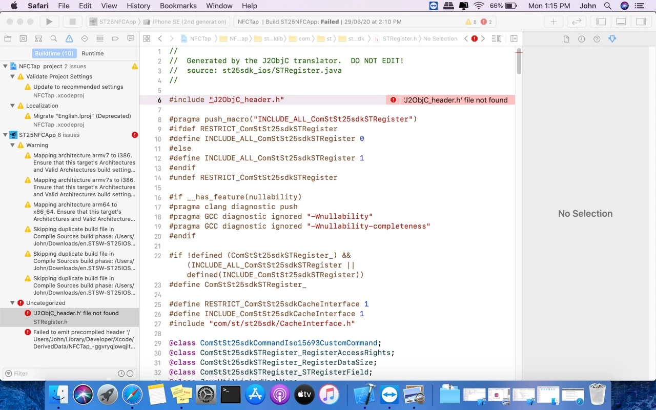

    AlbertCJohn
    July 6, 2020
    Thank for the reply Vincent
    Here is the issue I am facing
    'J2ObjC_header.h' file not found
    Failed to emit precompiled header '/Users/John/Library/Developer/Xcode/DerivedData/NFCTap_-ggvryqjowqjltpagmttuegrowgsc/Build/Intermediates.noindex/PrecompiledHeaders/ST25NFCApp-Bridging-Header-swift_WLJ36XJEPXM5-clang_1GHA8UW4ZC3V7.pch' for bridging header .
    AlbertCJohn
    July 6, 2020
    Screenshot of the issue
    victor laraison
    July 6, 2020
    hi Albert,
    The iOS NFC Tap uses the J2OBJC tool for translating Java into ObjC langage.
    So, you must download then install the j2objc into your environement.
    Download j2objc from https://github.com/google/j2objc/releases
    Go to the project setting of iOS NFC tap, then change J2OBJC_HOME environement variable.
    hope it helps.
    Thx and br,
    AlbertCJohn
    July 6, 2020
    Thanks for your reply, I will check and keep you updated. Thanks Again for your support

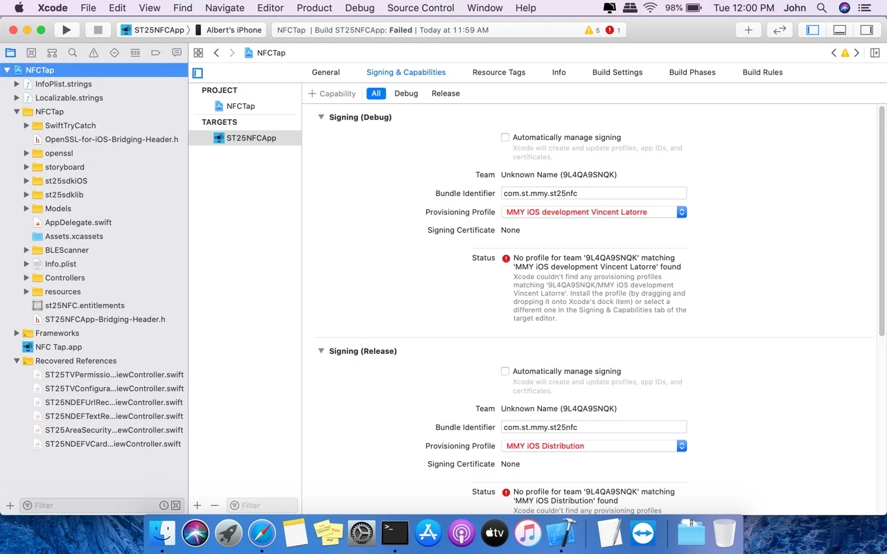

    Hi Vincent, I am facing this error
    AlbertCJohn
    July 7, 2020
    Attached Screenshot for reference
    AlbertCJohn
    July 7, 2020
    We couldn't change the team from Unknown Name (9L4QA9SNQK) and we are blocked in compiling the build to iPhone 11
    victor laraison
    July 7, 2020
    hi albert,
    You have to create your own provisioing profile from your Apple developer account.
    Here, you try to use mine, it is not the right one for you.
    Hope it clarifies.
    Br
    AlbertCJohn
    July 7, 2020
    Thanks fixed the issue.

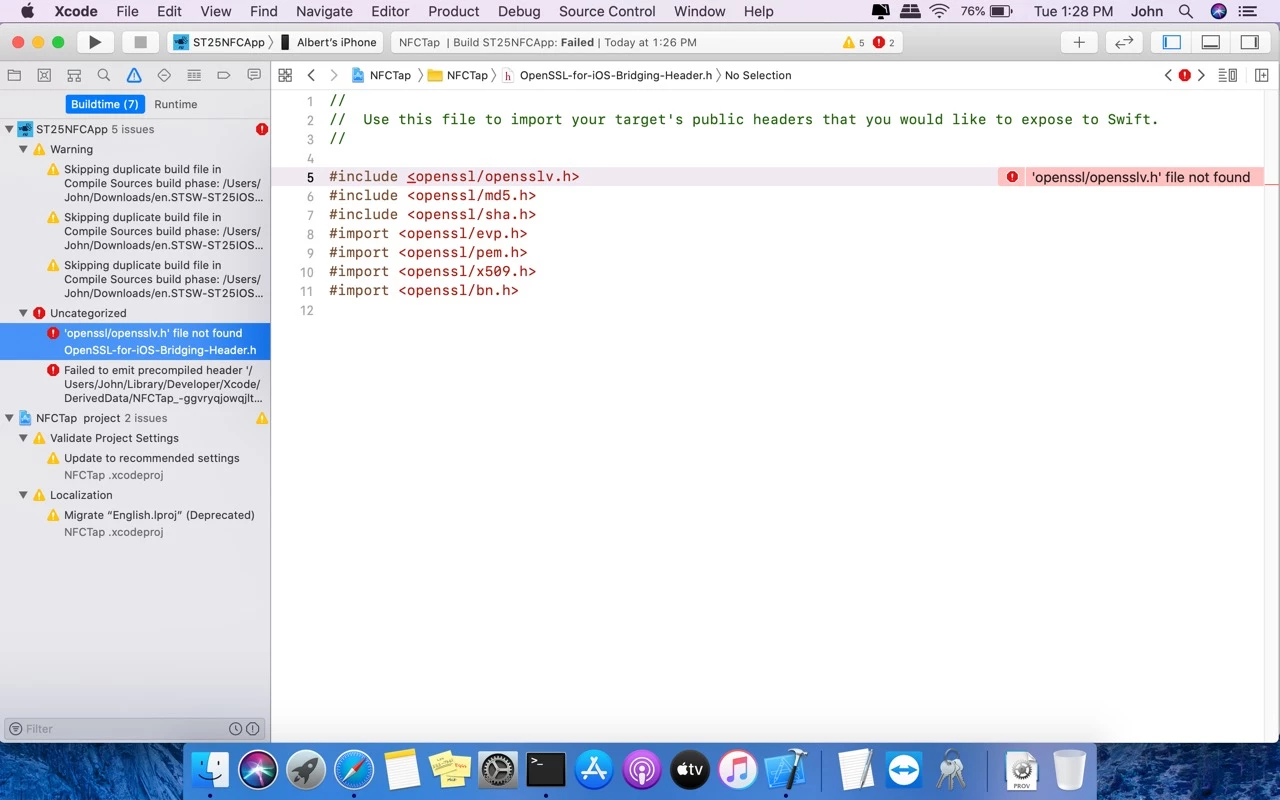

    we are hitting another compilation issue:
    'openssl/opensslv.h' file not found
