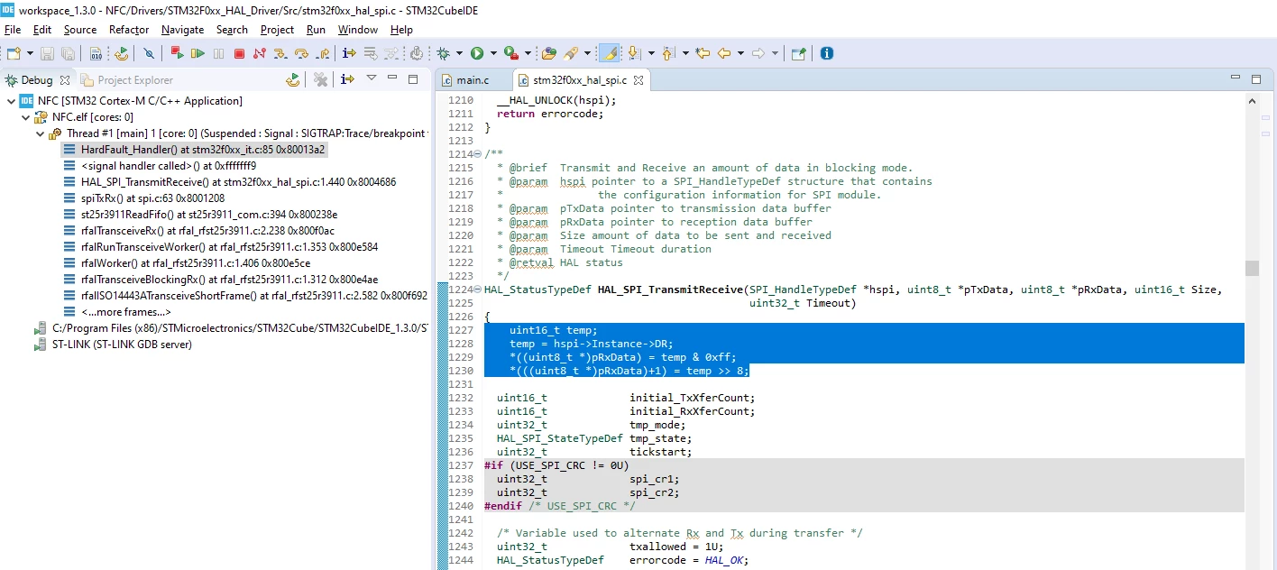

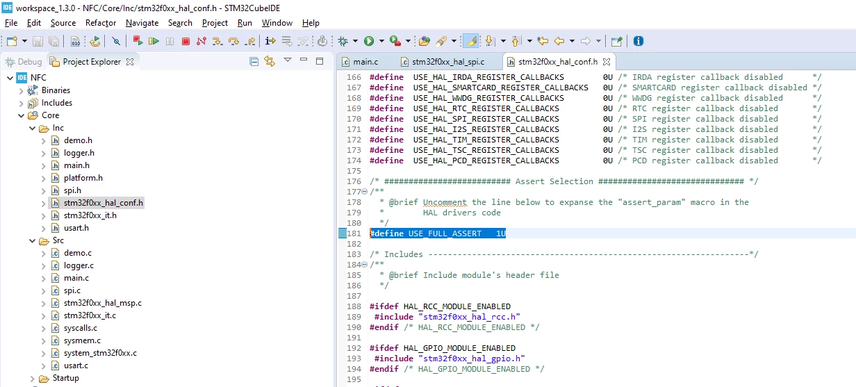

I tried to do it like I understand you, but no luck.
I change (uncomment #define section ) the ASSERT in "stm32f0xx_hal_conf.h" files because I didn't have file "stm32f0xx_hal_conf_template.h" (Picture above)
After that I insert the code you said at the beginning of the function "HAL_SPI_TransmitReceive()" (Picture above)
The problem is still not solved. Do you know what I did wrong. Belove I attached both changed documents.
thank you for your patience,
Domen
Ulysses HERNIOSUS
Jul 1, 2020 10:47 AM UTC
if you look at your screeshots (stacktrace) it tells you in which area of HAL_SPI_TransmitReceive() the hard fault gets triggered - one line before the mentioned line 1440. The code should replace that line.
This line which needs to be replaced was also mentioned in the post which I had referenced!
Problem is that even though the driver has uint8_t* on the interface, the driver actually needs it to always be uint16_t* aligned. Otherwise there will be a hard fault. With this workaround this issue (in this location) gets removed.
With USE_FULL_ASSERT actually in that function the assert_param(IS_SPI_16BIT_ALIGNED_ADDRESS(pRxData)); should have it. Of course after fixing the SPI driver code in this respect this line will not be needed anymore.

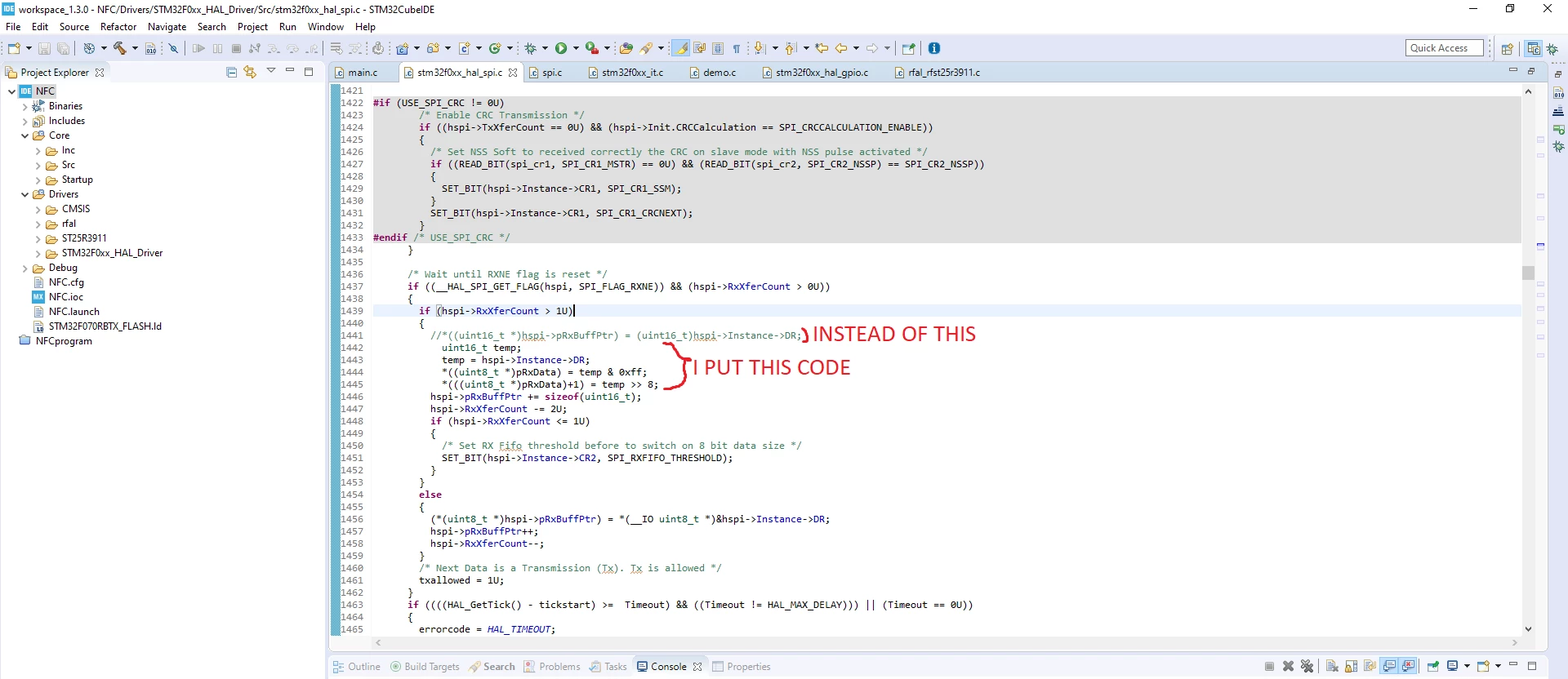

DIvan.1
DIvan.1Author
Jul 1, 2020 5:32 PM UTC
Hello, thanks for the knowledge.
Yes I found the place where the code need to go and put it there (picture below).
Now when I bring the tag type A close to the field I didn't get  hard fault BUT instead of LED typeA, the LED_TX turn on. It's the same with any of Tag types. Also the UART communication stop working after the message "Initialization succeeded..."
Any idea, did I missed something to change in HAL library?
Best,
Domen

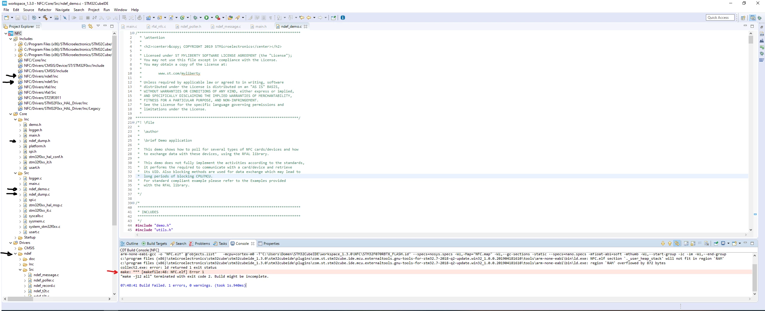

Now, I want to run your second example program (PollingTagDetectNdef). I took the same project and change the next things:
  1. Add NDEF library to the project folder
  2. In an IDE, add a path to this library
  3. in a folder Inc and Src add "ndef_dump.c", "ndef_dump.h" and "ndef_demo.c"
  4. Delete "demo.c" files. I think this file was just for previous example (detect differenttypes of tags). At first debuuger send me an error (few functions are decleared more than onec) so I delete this file.
  5. In an IDE, Refresh and clear the project.
(All this you can see in a picture below-black arrow)
After that I Rebuild the project and everytime i get an error you can see in the picture below-red arrow.
I try to change the name of the project, clear and rebuild the project, add the path again.... nothing solved the problem.
Do you have any idea what's wrong. I suspect that I forgot to add some path or include something.
I will be very happy any of your answers.
Best,
Domen
Ulysses HERNIOSUS
Jul 21, 2020 7:04 AM UTC
"region 'RAM' overflowed by 872 bytes"... does tell what's happening.
These demos are typically built for controllers having a bit more of RAM. You need to find ways of reducing that size. For doing so I recommend to first artificially increase the RAM in the .ld file. This way it will link and then you can inspect the map file what was allocated to RAM. Of course you will then need to change back the RAM size to what your device really has - otherwise application will crash.
My guess would be that you could somewhat safely reduce heap to zero and in platform.h limit all buffer sizes to 256.
Regards, Ulysses

Brian TIDAL
Jul 22, 2020 7:59 AM UTC
the NDEF demo has a quite big buffer for storing NDEF. This can be reduced. See DEMO_RAW_MESSAGE_BUF_LEN in ndef_demo.c. Feel free to reduce down to 1024 or 512.
Rgds
BT
DIvan.1
DIvan.1Author
Jul 22, 2020 8:43 AM UTC
Ulysses HERNIOSUS thanks for useful information
Brian TIDAL I change it and now It's working. Thank you very much! :D

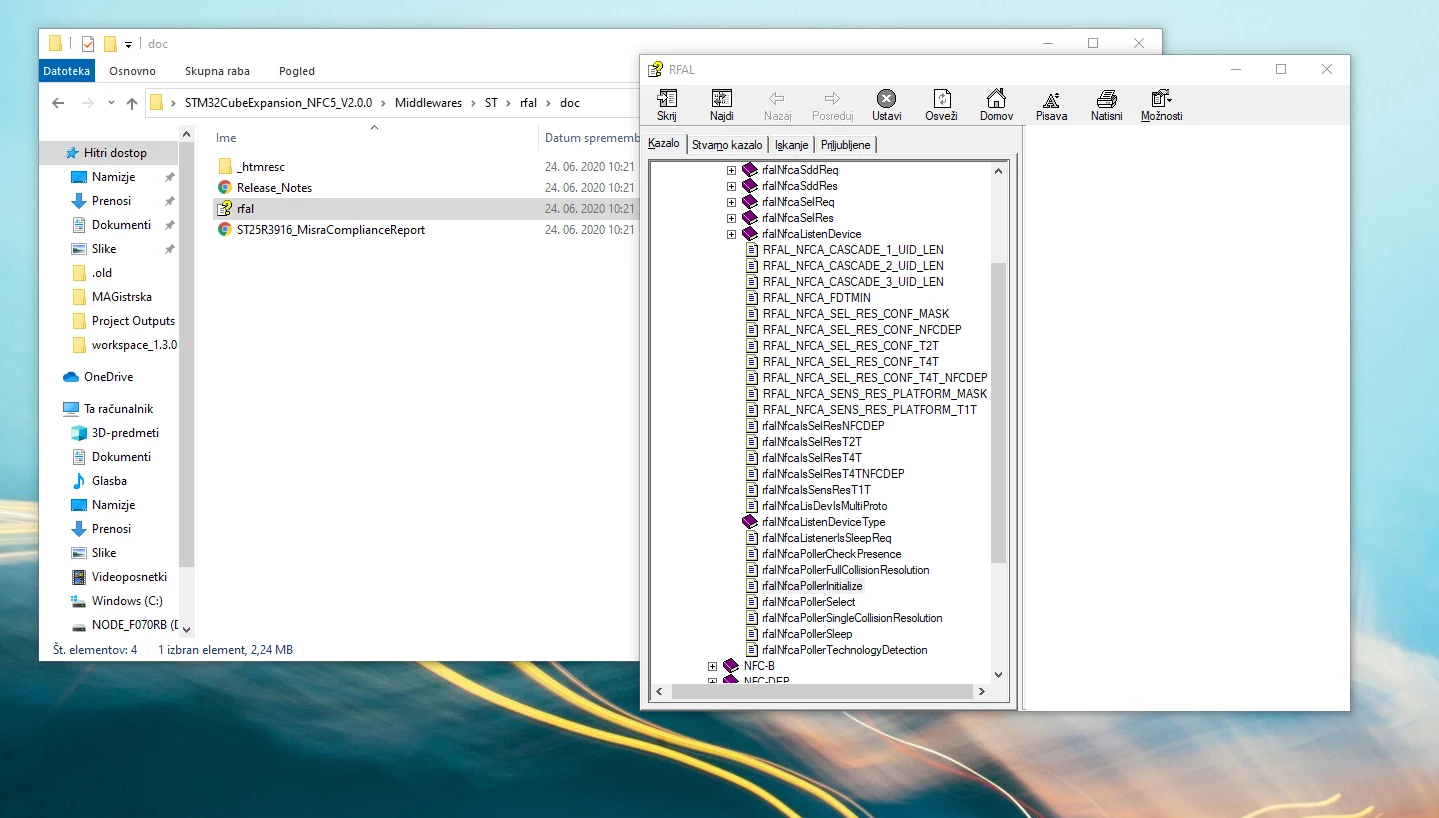

Now I'm trying to upgrade first example (detect the tag). I want to write something into a tag type A. Now "I found myself in a dead end" :face_with_tears_of_joy:
I don't know which functions needs to be used. Can you tell me if there is any guide for this and if there is maybe any other documentations how to use library or It's just this in the picture below?
