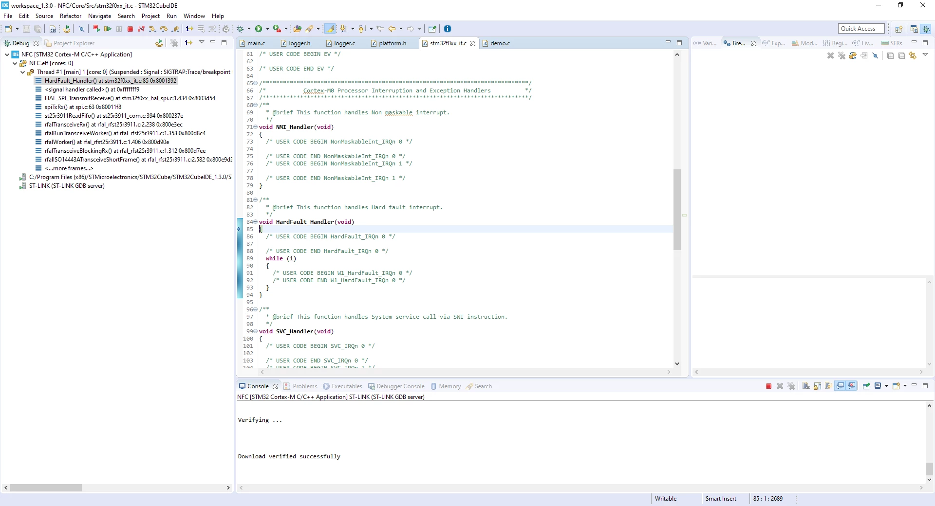

Do you have any idea why program stop working when I bring this tag or this close to NFC area. The program stop and show me this:0693W000001rmBbQAI.png
When I bring this yoursST25 stick tag close to NFC It's vorking good and the NFC-V led start blinking.
Have any idea?

Ulysses HERNIOSUS
Jun 30, 2020 6:32 AM UTC
Hi Domen,
most likely you are running into a limitation of STM32F0 HAL drivers not being able to handle un-aligned data. Please see:
https://community.st.com/s/question/0D50X00009q3eMwSAI/how-to-migrate-project-nfc5-v13-polling-from-stm43f401-to-stm32f072
A fix of the STM32F0 HAL drivers is being worked on but as I understand it will only appear in V1.11.1
Regards, Ulysses
DIvan.1
DIvan.1Author
Jun 30, 2020 7:24 AM UTC
Thanks for sending me a link but sorry I don't know what did you mean with the post in the link.
1) Where to change "USE_FULL_ASSERT to 1"
2) and what do you mean with this code:
>> uint16_t temp;
 >> temp = hspi->Instance->DR;
 >> *((uint8_t *)pRxData) = temp & 0xff;
 >> *(((uint8_t *)pRxData)+1) = temp >> 8;
do I need to change it or what, because in my code I can't find this or at least similar code.
Sorry for not understanding you but I can't figure out.
Best,
Domen
Ulysses HERNIOSUS
Jun 30, 2020 7:50 AM UTC
please search your code including HAL drivers! Your screenshot shows a function HAL_SPI_TransmitReceive(). The code needs to go into this function. I expect this function to be implemented in stm32f0xx_hal_spi.c.
For the assert, you typically find that in stm32f0xx_hal_conf_template.h
Regards, Ulysses
