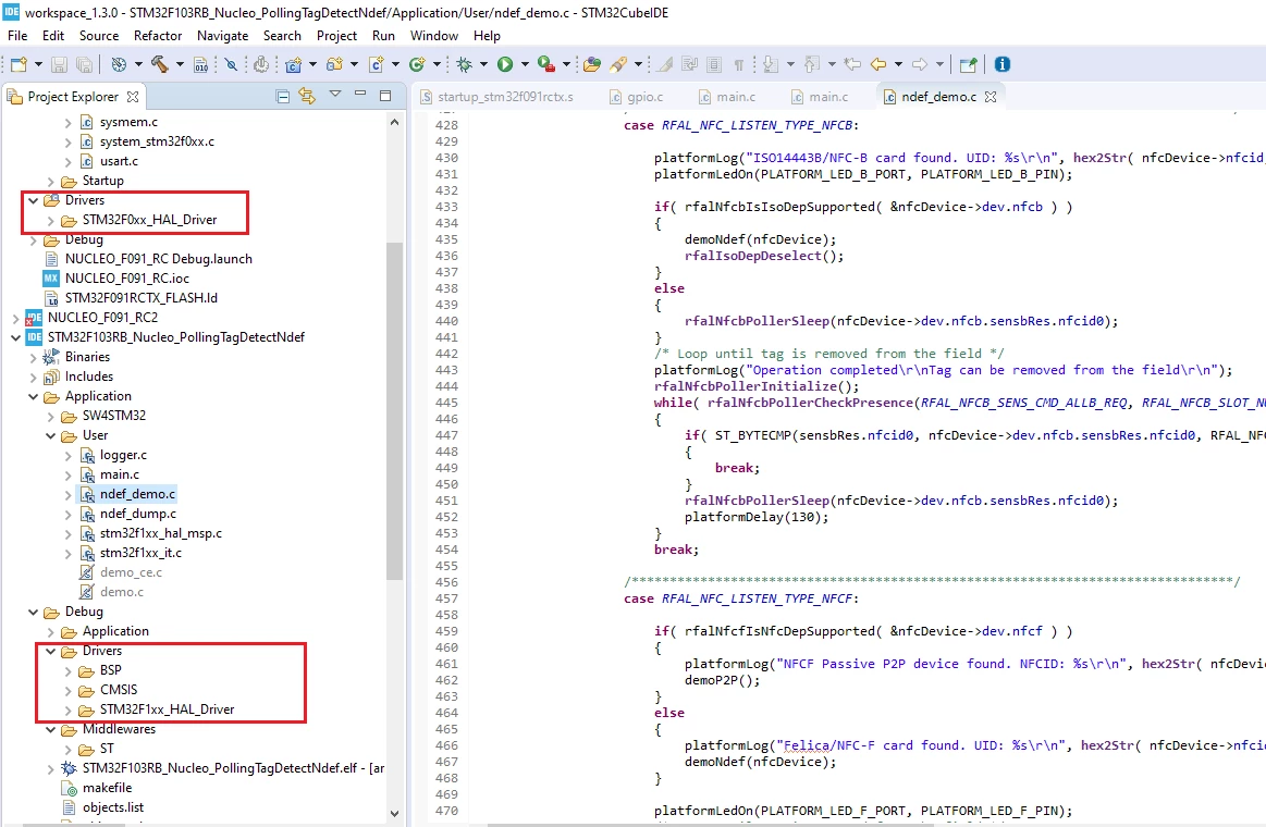

    To illustrate what i am trying to do at the moment, is to execute the ndef_demo.c sample. Here , am on the F103 example. Obviously, I have to do some changes to adpat it, but i can't see wich part I have to change. I can notice the HAL drivers are differents, but there aren't used.

    actually HAL is being used from spi.c (HAL_SPI_TransmitReceive()).
    Please debug through the above mentioned functions to see if you are able to receive the chip ID. If you don't receive it you will need to check the Pin configuration CubeMX to see if the used SPI block is connected to the right pins for the shield.
    At some point you may want to observe with a logic analyzer / scope.
    Regards, Ulysses

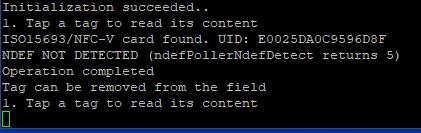

    So a couple days after my last message, I am currently working on a NUCLEO-F103RB, wich is compatible with one of the application on the X CUBE NFC package. So when I run the application "STM32F103RB_Nucleo_PollingTagDetectNdef", it's working fine. I can tag different NFC devices, and read there UID.
    Now, i'm trying to read the NDEF message present on the NFC tag. I checked the compatibility ISO/IEC 14443 Type A and B, so the application should work with my NFC Device.

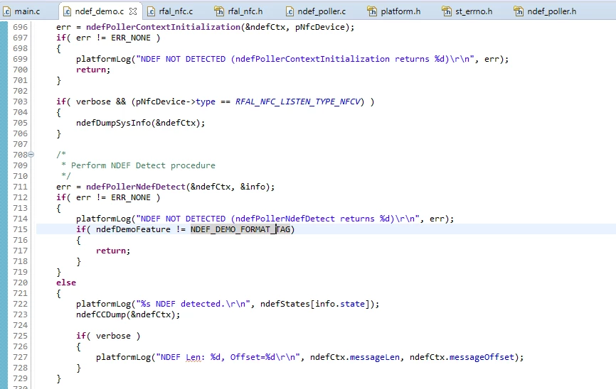

    But for the moment, an error is showing up on the terminal when I aml reading with the NFC Nucleon NFC03A1 :
    Obviously, i made some research and trying to find out what is this error.0693W000000U5mjQAC.png

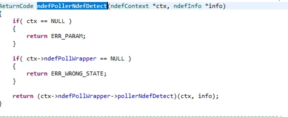

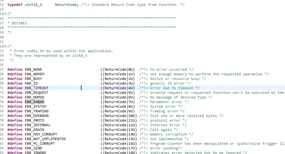

    So the function ndefPollerNdefDetect  will able to determine if there is an error, and what kind, by returning an integer.
    Based on the "Return Code", I am currently receiving the line "#define ERR_REQUEST            ((ReturnCode)5U) /*!< invalid request or requested function can't be executed at the moment */"
    The problem is : why ?
    I am using compatible NFC device, and i didn't modified the original code of the application, shouldn't it works ?

    the application will try to read NFC Forum formatted T2T, T3T, T4T and T5T.
    Generally the different tags will not automatically be able to act as one of these tag types. Even if a tag is compatible it still needs to be formatted: Write an NFC Forum Capability Container (CC) to the tag.
    IMO if NDEF Detect fails it can simply mean no CC was detected. Which tag are you using?
    For ST25TV you could use the ST25NFC Android app to properly format.
    Regards, Ulysses
