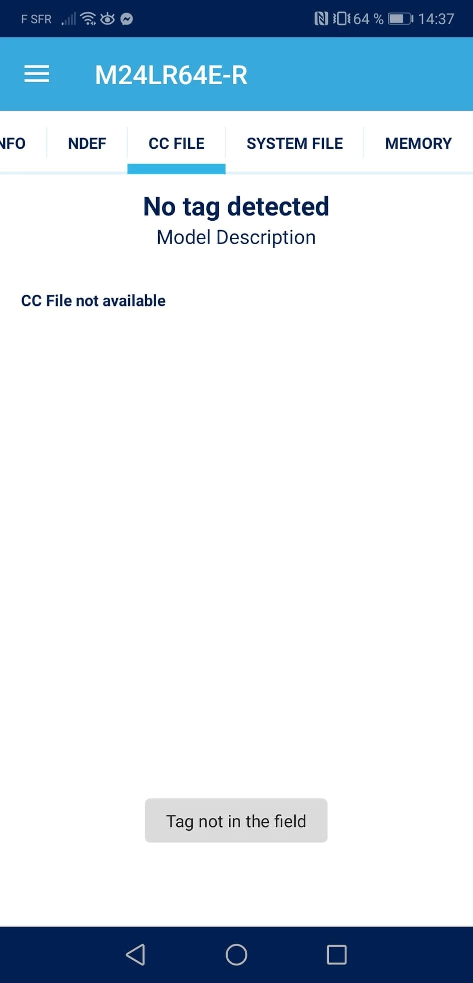

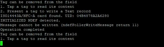

    I download the ST25 application. I am using 2 differents NFC device :

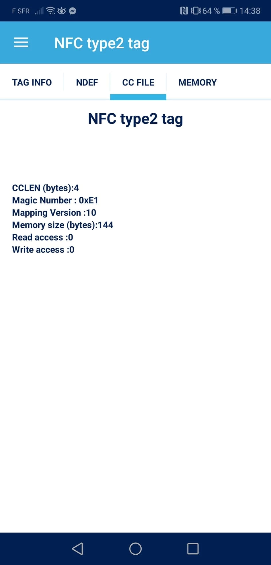

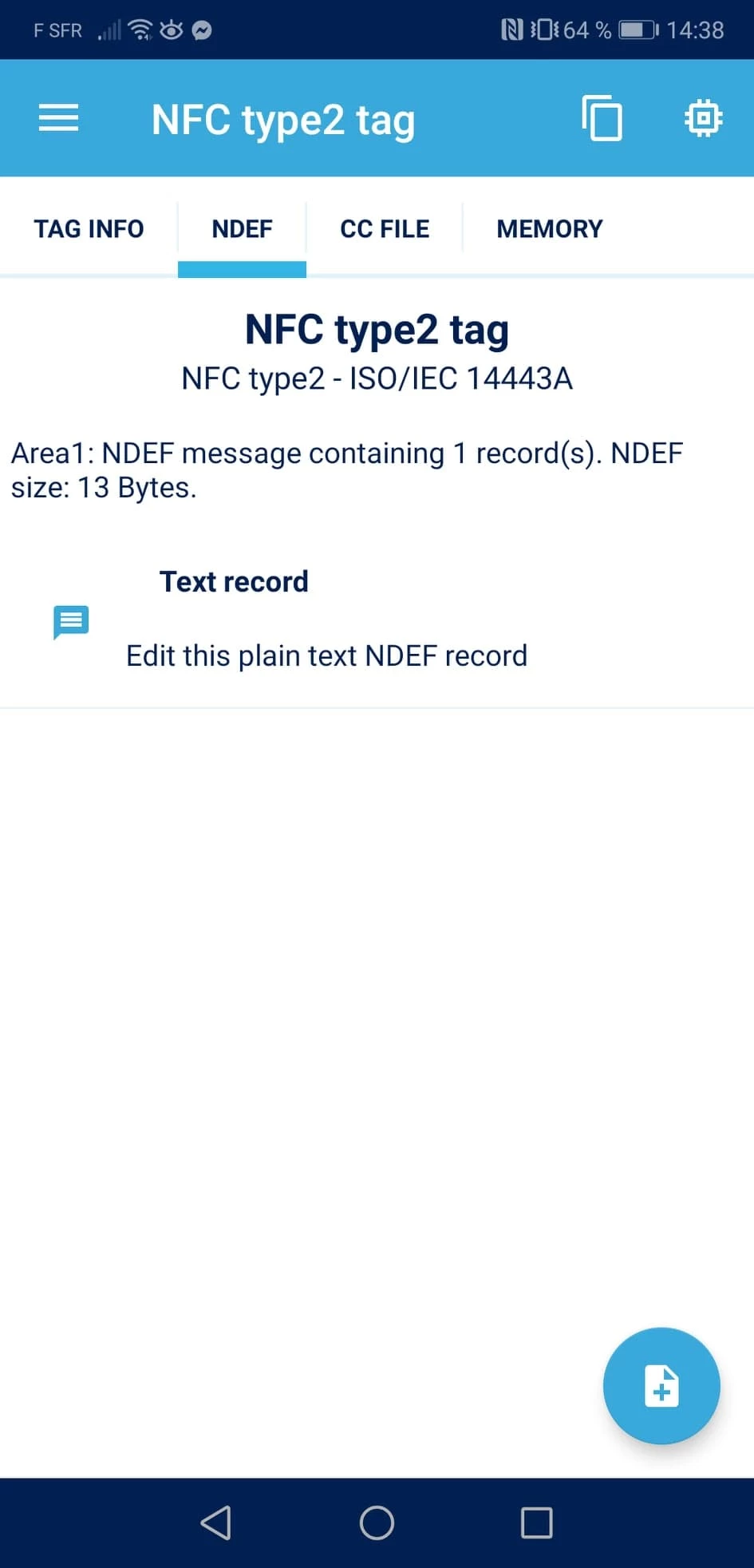

    • A standard NFC type 2 tag ISO 14443A. I can write and read on it from the application. As you can see below, it looks like a CC file has been created when i write a simple NDEF message on it :
    The Ndef message i wrote on it :
    The CC file create automatically I suppose, because I didn't do it manually

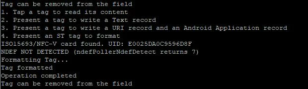

    At the moment, I have the famous error 5 with this one too.

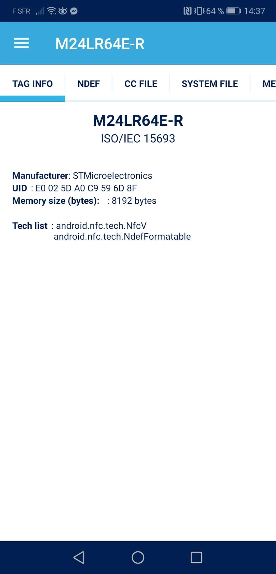

    In my final application, I will have to read data on the M24LR64E-R, made by ST too.
    Indeed here, there is no CC file created (i didn't wrote on it).
    Maybe you could explain me how to create CC file ?

    Brian TIDAL
    March 18, 2020
    Hi Karim,
    for the M24LR, you can either format it with the X-CUBE-NFC3 ndef_demo (press the blue button until menu 4 is displayed) or you can format it through the Android app (write an NDEF on this tag).
    For the T2T tag, can you dump the contain of the tag memory and provide to us for analysis?

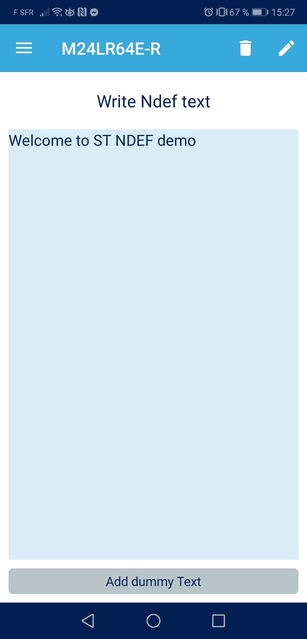

    I can format it like you explained to me , by using the application :
    Then when I try to read it, the NDEF status looks ok :
    Then, I tried to write from the application an NDEF message, a simple text, but when i try to read it throug the application, it doesn't work again :
    But when I try to write from the app and to read it, it looks to works :
    Do you have any ideas why i can't read NDEF message i would insert from the app ?

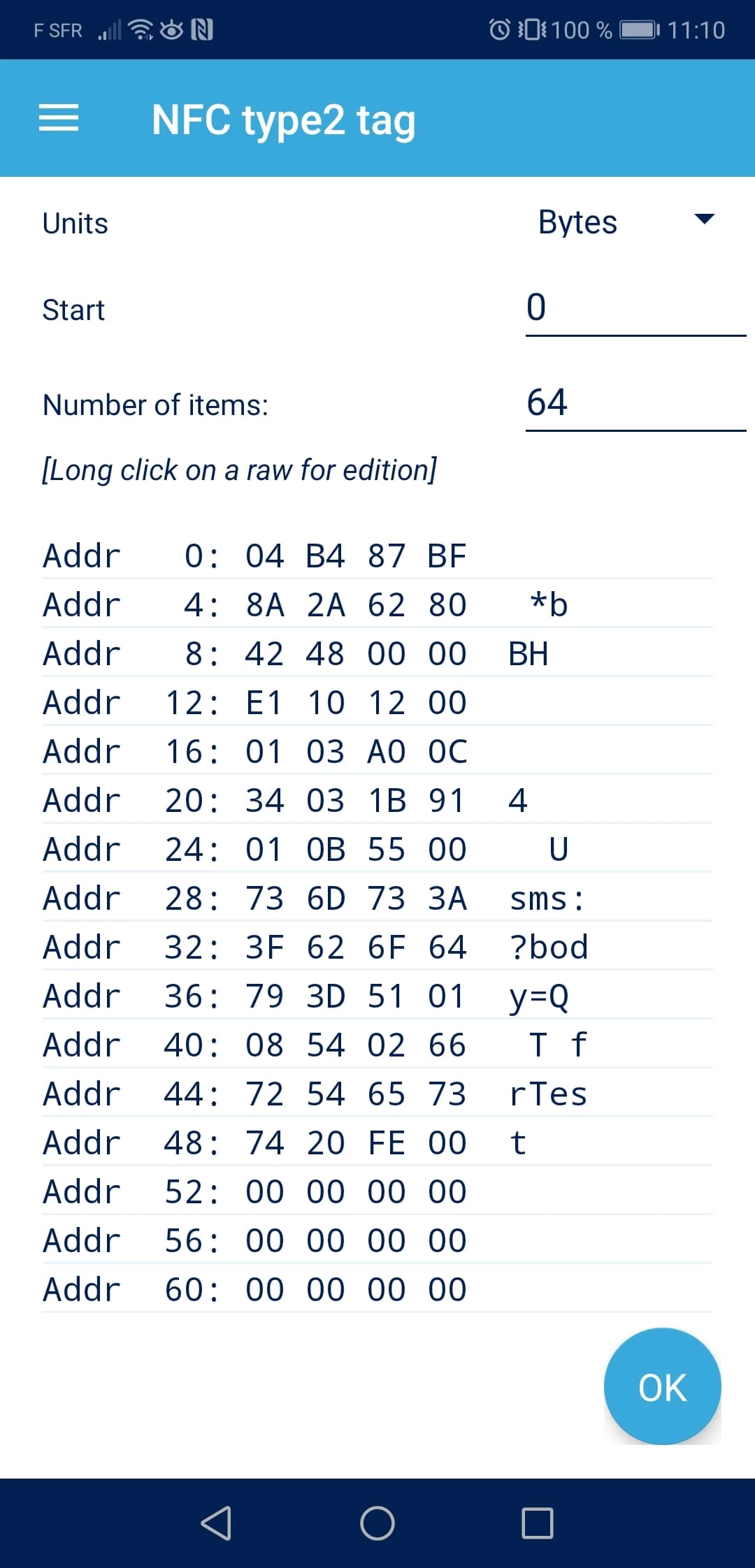

    For the memory of the T2T tag, here it is :

    Brian TIDAL
    March 23, 2020
    Hi Karim,
    the content of the T2T tag memory is incorrect at address 16. Please try to write 03 00 FE 00 in this block with the Android app and retry to perform NDEF read and NDEF write from X-CUBE-NFC3 STM32 application.

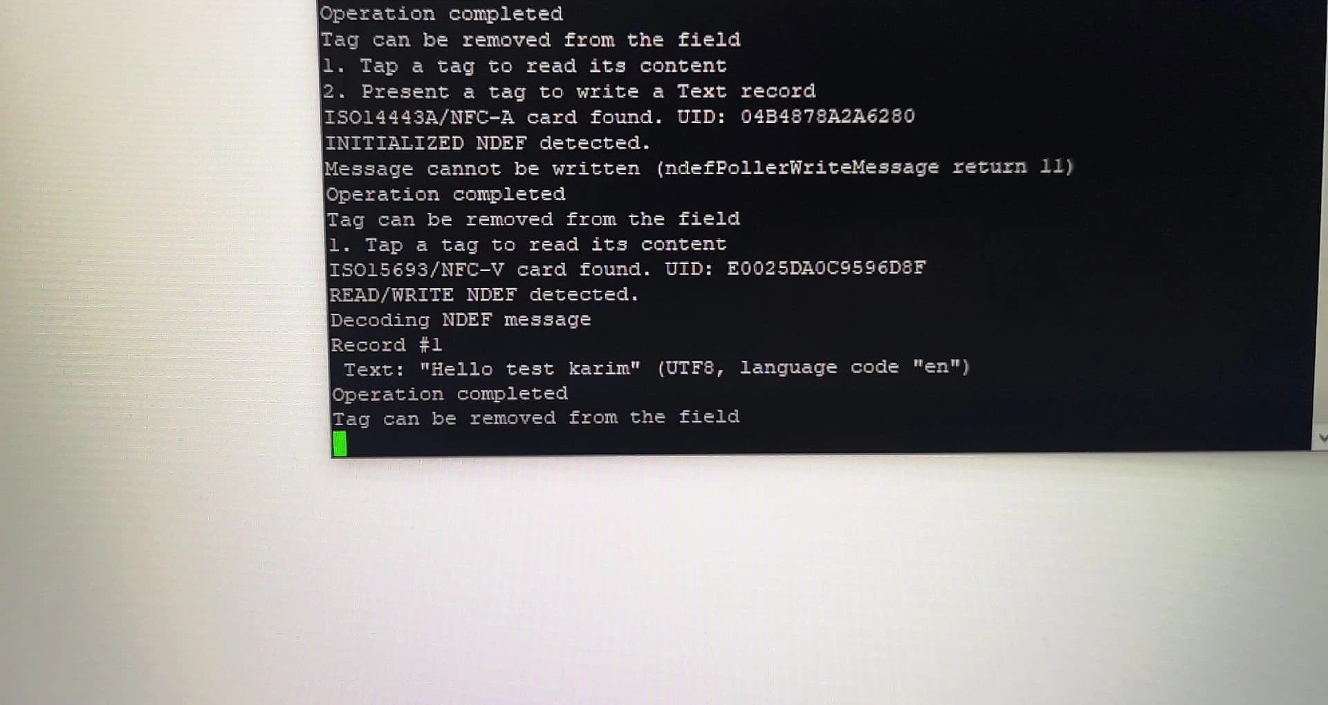

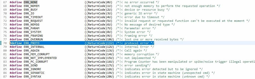

    You were right ! I don't understand why, but i just change the adress memory like you told me, and then the NDEF status has changed when I am trying to read it from  X-CUBE-NFC3 STM32 application:0693W000000UWCsQAO.jpg
    And now it's an protocol error wich is coming according to the returned integer :
    I will have to change an another parameter i guess .
    Sorry for my last message, after reading back myself I wasn't very clear :
    I wanted to mean, I can write and read properly from X-CUBE-NFC3 STM32 application, but i can't read NDEF message on X-CUBE-NFC3 STM32 application that I wrote from Android application. After studies, I think when I write ndef message from android app, the M24 is formatted again, so it can't be read from X-CUBE-NFC3 STM32 application (with good format)
    Thanks you again a lot for your great help and reactivity.

    KBens.1
    KBens.1Author
    March 23, 2020
    Ok my bad for the second part, finally after formating from X PACKAGE application, i can write from Android app, and read the message on X PACKAGE ! :grinning_face:

    Regarding the T2T issue: a Control Lock TLV was present in the tag (01 03 A0 0C 34) . This feature is not supported as of today by the current NDEF stack and therefore the tag was rejected. That's why I've suggested to replace this with the NDEF TLV (03 00) followed by the terminator TLV. Can you share the tag model and tag manufacturer?

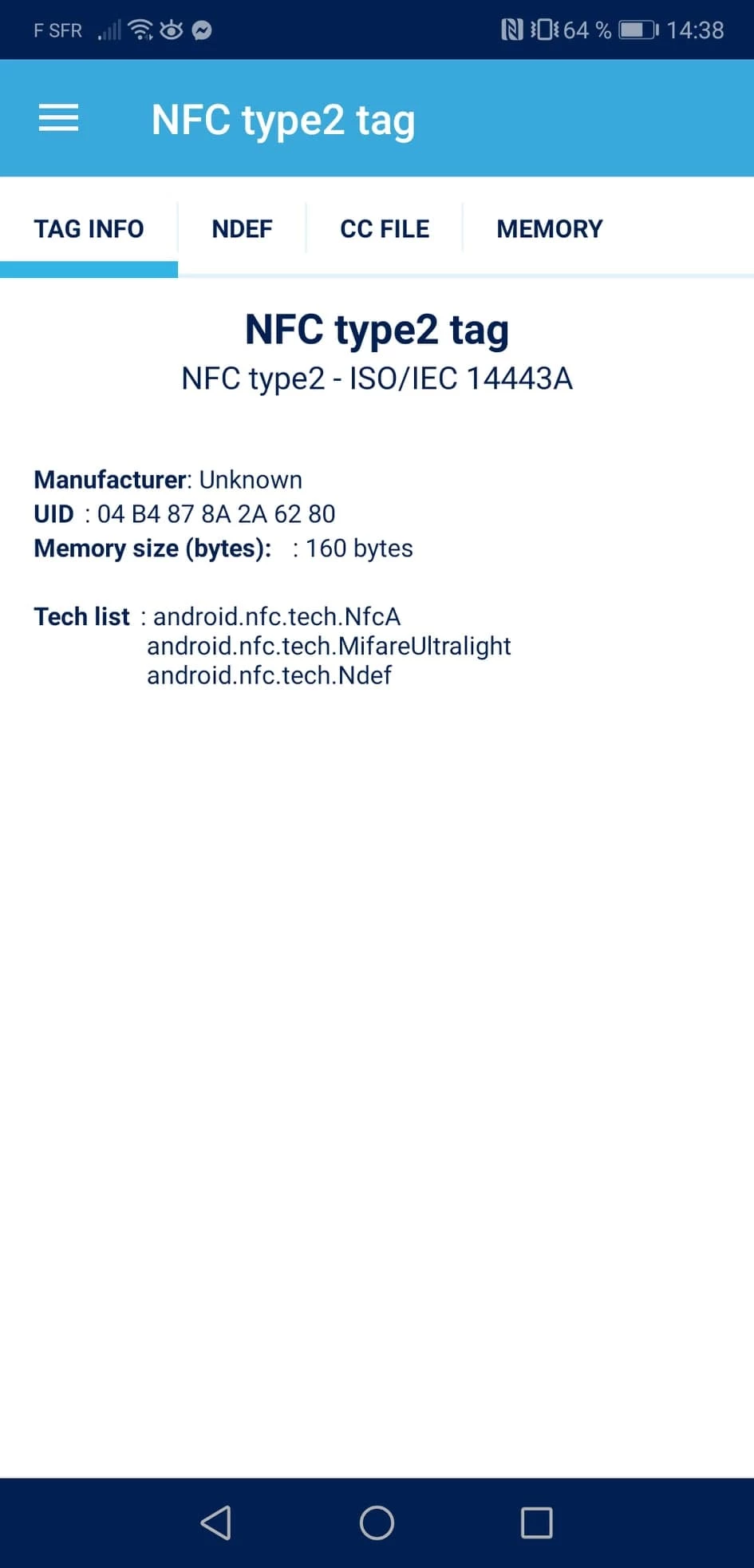

    March 23, 2020
    Hi Brian ,
    Yes it's my fault, I wasn't very clear about my explications. Thanks to you now I have more knowledge about RFID to explain my situation :

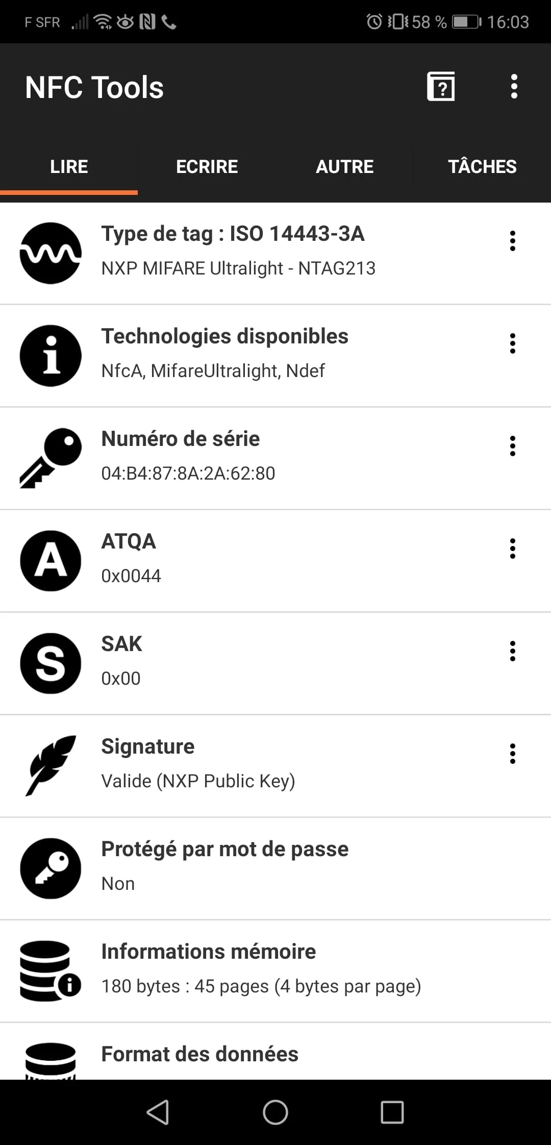

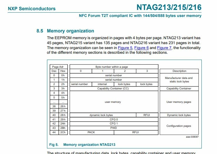

    Regarding the T2T issue ;
    According to the NFC tool android application, it's an NXP MIFARE Ultralight- NTAG 213
    But i don't understand how you manage to find the Control lock TLV on adress 16, because when I study the data sheet , it's only for user memory :
    https://www.nxp.com/docs/en/data-sheet/NTAG213_215_216.pdf

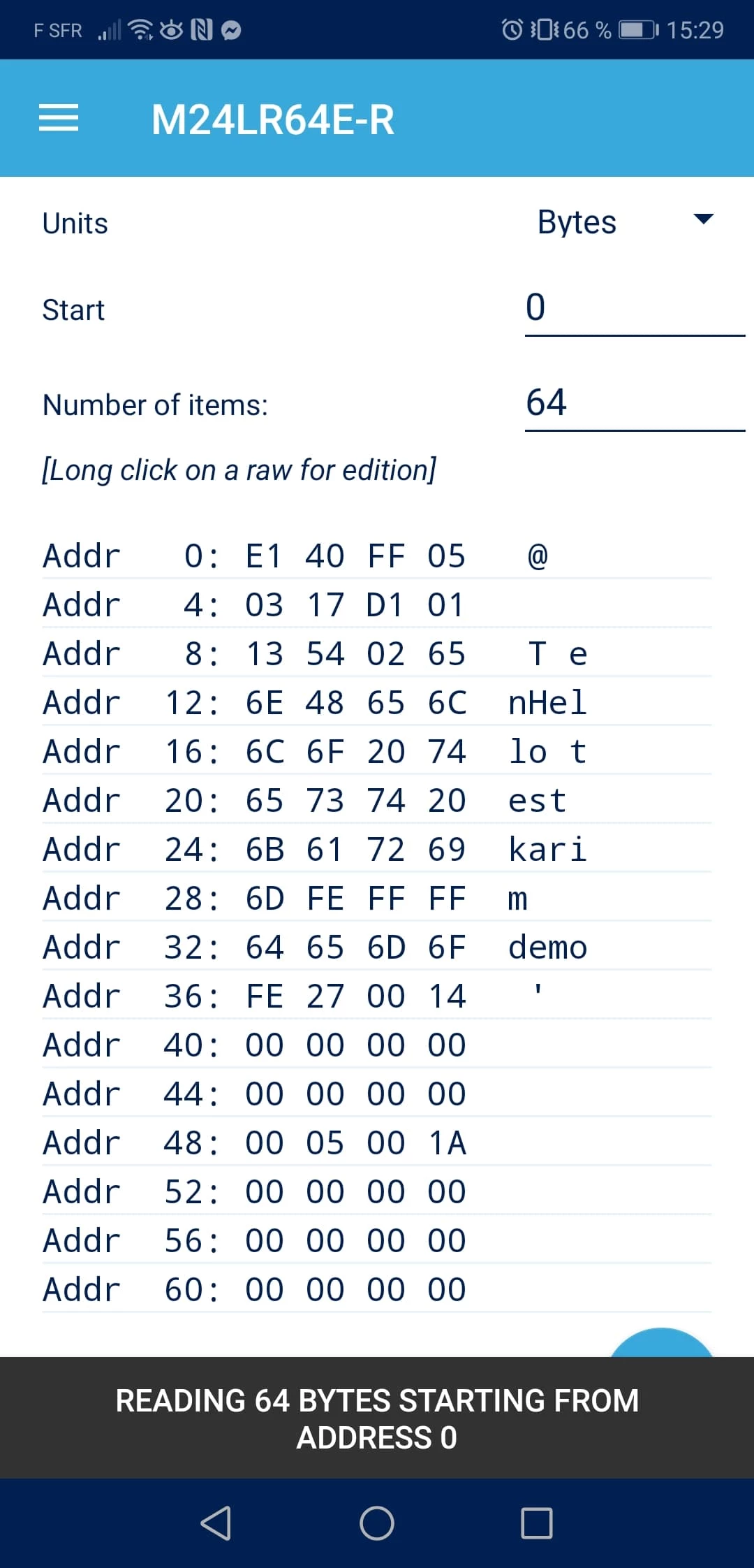

    Regarding the M24LR (T5T)

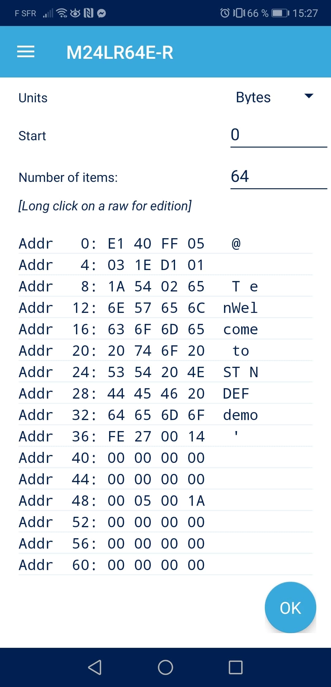

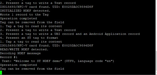

    After formating from X PACKAGE application, and write through X PACKAGE application too, i can read on the android application :
    And the memory :
    Then i tried to modify the message and read back the memory again :
    And when I try to read it back on the X PACKAGE application, it's working fine :
    But, i am now trying to understand why the adress n°05; 06; 07 has changed when i modified the message.
    Thanks,
    Best regards,
    Karim
    Brian TIDAL
    March 24, 2020
    Hi Karim,
    for T2T: as per the NFC Forum Technical Specification T2T v1.0, different TLV can be present after the Capability Container: Null TLV, Lock Control TLV, Memory Control TLV, etc.
    For the M24LR, the NDEF TLV starts at address 4:
    • 0x03 is the T-field for a NDEF Message TLV
    • 0x1E/0x17 is the L-field. As your message has a different size than the initial message, the L-field has changed
    For more information, see:
    • Type 2 Tag Technical Specification Version 1.0
    • Type 5 Tag Technical Specification Version 1.0
    • NFC Data Exchange Format Technical Specification Version 1.0
    Rgds
    BT

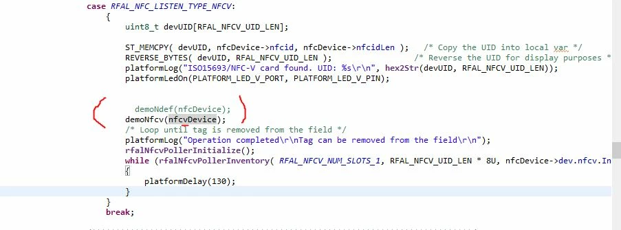

    KBens.1
    KBens.1Author
    May 11, 2020

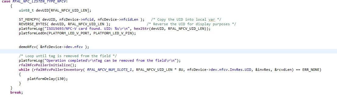

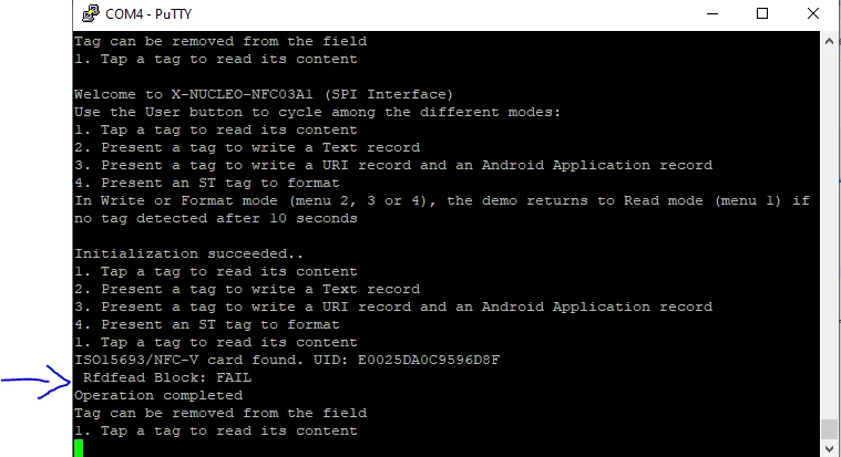

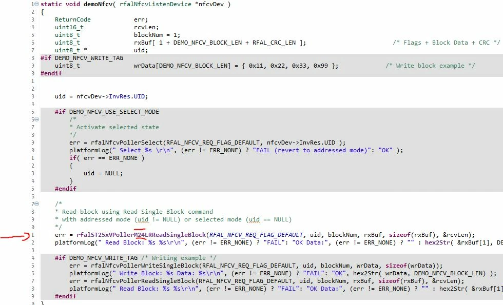

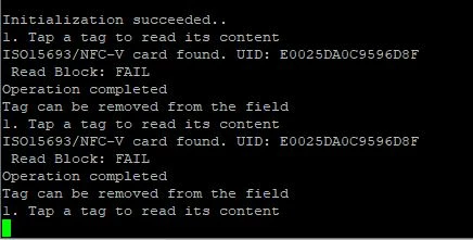

    Thanks you again for your advice. I studied the rfal_st25xv.c librarie to understand how I could manage to read and write into the memory blocks. As you noticed me, the demoNfcv() as been created to do so. I tried to use it,I copied/pasted it to the ndef_demo.c file, because i can't run it from the demo.c file (wich has been like excluded from the project) :
    I am still using the M24 tag, so I am calling the function at the right place, when an ISO15693 has been detected.
    As you can see i have put the demoNfcv function.
    And now i got a read block error, but no error code is returned, so i can't understand why it is failling :
    Best Regards,
    Karim
    Brian TIDAL
    May 11, 2020
    Hi Karim,
    the demoNfcv uses rfalNfcvPollerReadSingleBlock() whereas a M24LR64 tags has a extended block number coding.
    rfalNfcvPollerReadSingleBlock() works for standard ISO15693 tags whereas rfalST25xVPollerM24LRReadSingleBlock has to be used for M24LR64 or M24LR16 tags.
    If you want to read a block from a M24LR16 or M24LR64 tag, you just need to replace rfalNfcvPollerReadSingleBlock by rfalST25xVPollerM24LRReadSingleBlock in the demoNfcv.
    Rgds
    BT
    KBens.1
    KBens.1Author
    May 12, 2020
    Hello Brian,

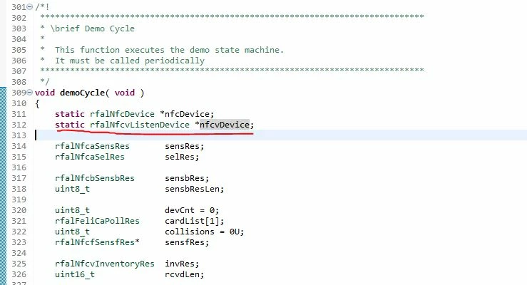

    I tried to replace rfalNfcvPollerReadSingleBlock()  by the rfalST25xVPollerM24LRReadSingleBlock function. Here in the code (ndef_demo.c) :
    I added a static variable with the asked structure :
    And I just replaced the demoNdef(nfcDevice) originally in the code by the demoNfcv() .
    No error or warining during compilation, but when I am trying to read through the application, still got read block fail :
    Best regards,
    Karim
    Brian TIDAL
    May 12, 2020
    your nfcvDevice variable is not initialized... the proper way is to used nfcDevice that is initialized thanks to rfalNfcGetActiveDevice( &nfcDevice );
    The proper call to demoNfcv is:
    demoNfcv( &nfcDevice->dev.nfcv );
    See demo.c.
    Rgds
    BT
    KBens.1
    KBens.1Author
    May 12, 2020
    Thanks a lot, it worked fine ! :)
    Best regards,
