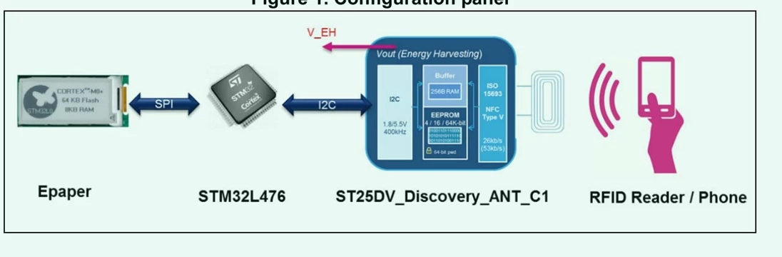

I want to know how to show how to use the energy harvesting feature based on the ST25DV-I2C-04K in combination with an STM32L476 MCU.I have noticed that there is a code named EH energy collection, can you power L476 to make it run normally?

I think 47.1mW could be too much power, and you also have to add the power requiered by the STM32.
If you look at the  curves in the application note a I recommended in a previous post, you can see that EH will not deliver more than 30mW in best conditions.
But I think the best is for you to try. Maybe the MAX6675 is consuming less than the 47mW (this may be a maximum in some high temp conditions).
Best regards.
26 replies
JL. Lebon
May 24, 2023
Yes, it would be possible to power a STM32L476, but with some conditions.
ST25DV is able to deliver at best 20mW of EH, and only in best conditions.
Best conditions means a good coupling between readers antenna and tag antenna (larger antennas are better). The reader need to be powerful enough (don't expect to do this with a smartphone, a dedicated reader is needed like ST25R3911 or ST25R3916).
Usually, a tank capacitor of a few uF helps a lot with current surge peak.
The STM32 must be configured to consume the less power possible and Vdd should be as low as possible (1.8V is ok).
Best regards.

There are two modes for EH:
  • EH on boot
  • EH on demand
EH on boot means that the power will be delivered on the VEH pin as soon as the ST25DV is powered by the reader (assuming the reader is delivering enough power for both the ST25DV and the external device). It is started automatically and requires no action.
EH on demand means that power is delivered on the VEH pin only when enabled by a command (write in a dynamic register). It is a temporary setting (needs to be re-enabled after each boot).
In your case if you don't want to press any button, you would probably go for EH on boot.
In the code, it is also called "EH static configuration". If you long press the button, it should activate EH at boot. This setting is no-volatile, so once it is done, it will resist to reboots.

Rene Lenerve
May 29, 2023
Hi @帅 罗​,
What you want is just activate the EH at boot which will deliver EH on VEH pin, to do that you just have to reset the EH_MODE register. Please have a look on the Datasheet to understand this feature.
To do that you have 2 possibilities, by RF command or through I²C bus.
  • With RF command, send the Write Dynamic Configuration (describe in the Datasheet §7.6.29).
  • With I²C bus, just write to the register at address 0002h and reset the bit corresponding for EH_MODE (refer to the DataSheet for more details).
The code example proposed with the NFC7 package uses the button to demonstrate both state for the EH MODE (static or dynamic), you can use only one configuration for your purpose:
For example this part is sufficient for what you want to do :

Rene Lenerve
May 31, 2023
Hi @帅 罗​​,
If you run the example on the STM32L476 nucleo board and NFC07 expansion board, you will have the information with the Green Led and Blue Led. If the Green Led is on it means the EH is always available even after a Power ON. If the Green Led is off the EH is only available when the blue Led is on.
To activate the EH at boot (Green Led on), press the User button (blue button) on the Nucleo STM32L476 board for more than 2 seconds.
To activate the EH on demand only (Blue Led on), press the User button (blue button) on the Nucleo STM32L476 board for less than 2 seconds.
Another way to check is to read the EH_MODE register, through I²C or through RF (Smartphone).
I hope this will help you.
Kind Regards.
