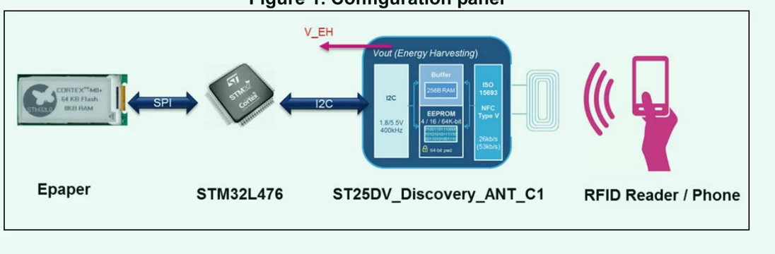

Hi,@Rene Lenerve​
I need to use RF to make ST25 power stm32, so as to achieve the purpose of MCU working normally,and I have noticed that the official explanation has this case, as shown in the picture below. So what should I do to make st25 power MCU?Is there any way or suggestion?
Kind Regards.

Hi,@Rene Lenerve​
I need your help,I made the blue LED of ST25 light up through EH, which means active mode has been started. So can I disconnect the power supply and measure the voltage of the EH pin only with RF? Or how can I use EH pin energy to power other low power chips?
kind Regards.
Rene Lenerve
June 5, 2023
Hi @帅 罗​,
If the blue Led is turned on, it means that the EH is available only for the current connection and will be off if you remove the field.
So, you need to press the button during 2 seconds and wait the Green and Blue Led are on. Then you can remove the power supply. Now when you approach an RF reader, the EH pin will deliver power that you can measure.
Hope this will help you.

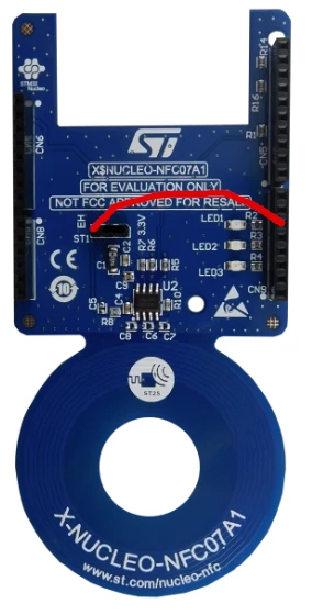

Hi @Schuyler (Community Member)​,
The Leds on the NFC07 expansion board are not wired to work with EH. To use the EH feature with other component you need to wired the ST1 pin 3 to another component to see this feature in live.
In other terms you need to design your own board for that.
But if you just want to make a try, one possible solution would be to connect the ST1 pin3 (EH pin) to the Arduino connector CN9#6 (as the picture below). and when you approach the RF field it will turn on the Green Led. (without STM32L476 Nucleo board connected).
If you allow me to give you one advice, I think you should read the documentation more thoroughly to understand how this feature works.
I hope this will help you.

Schuyler
SchuylerAuthor
June 6, 2023
Hi,@Rene Lenerve​
Thank you for your reply. According to your tips, I have successfully lit the LED through RF, but is the reason for the blinking all the time because of the AC output? Moreover, I have measured the output of the pin. In the case of AC, the voltage is about 0.2V. Is this normal?
Kind Regards.
