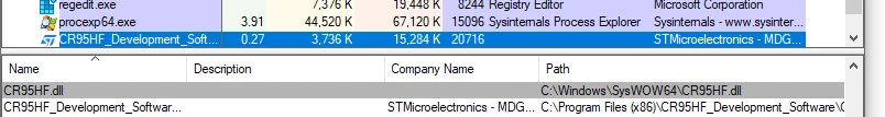

    I've eliminated python's ctypes from the root cause list. By compiling this library under linux(the one for which source code is available) and running it in C++ code I was able to reproduce the same issue. How can I verify if windows app is using the same DLL? Maybe it does something differently?
    Maybe transceiver board STM firmware have a bug and doesn't slice/concatenate messages correctly?
    Is it possible to get older STM firmware revisions?
    Brian TIDAL
    Mar 15, 2021 12:38 PM UTC
    I confirm that the  PC software executable for DEMO-CR95HF-A board uses the CR95HF.dll.
    You can use Process Explorer to see DLL info:
    The  PC software executable for DEMO-CR95HF-A board runs the CR95HF DLL from C:\Windows\SysWOW64
    The  PC software executable for DEMO-CR95HF-A board communicates thanks to the CR95HF DLL with the transceiver board through HID USB using 64 bytes frames. As this is working with PC software, we can conclude that the transceiver board firmware is able to properly slice and concatenate the 64 bytes USB frames.
    Can you install Process Explorer and check the DLL being used in your environment?
    Rgds
    BT
    LKowa.2
    LKowa.2Author
    Mar 15, 2021 3:26 PM UTC
    I can confirm that my PC software uses the same DLL - the one from C:\Windows\SysWOW64.
    I did compare this ddl with dll in my python project - the are the same, same size and creation date. Only modification date is different (dll from SysWOW is from Dec 2017), but even after replacing this dll I have the same issue.
    How can we be sure that slicing and concatenating messages is being done by a DLL, and not by PC software itself?
    I've tried to find slicing/concatenating functions in CR95HF C++ Library for Linux User https://www.st.com/en/embedded-software/stsw-95hf004.html
    without success. Could You point me to it?
    Brian TIDAL
    Mar 15, 2021 5:07 PM UTC
    the frame fragmentation/defragmentation is done inside the Windows DLL but only for the CR95HFDll_SendReceive API. If you use CR95HFDll_STCmd API + 04, it will not be fragmented/defragmented. Make sure to use CR95HFDll_SendReceive rather than CR95HFDll_STCmd.
