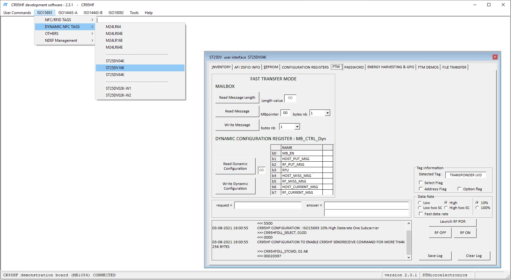

    Brian TIDAL
    Mar 8, 2021 6:09 PM UTC
    the  PC software executable for DEMO-CR95HF-A board has an ISO15693-->Dynamic NFC Tags-->ST25DVxxK menu where you can easily send Read Message / Write Message / Read MB_Ctrl_Dyn command. Use the Inentory tab (click on Anticollision to find your tag) then go to FTM tab.
    You can also go in the Toolbox menu and check the DLL version. If you still have issue, try un uninstall and then re-install .
    Rgds
    BT
    LKowa.2
    LKowa.2Author
    Mar 8, 2021 10:55 PM UTC
    maybe I'm doing something differently or I missed something...
    I've tried to connect via PC software executable for DEMO-CR95HF-A board and done these steps:
    1. checked inventory
    2. presented password on PASSWORD tab
    3. set MB_MODE static register to 1 on CONFIGURATION REGISTERS
    4. set GPO on ENERGY HARVESTING & GPO
    5. verified that by checking VCC_ON bit in EH_Ctrl_Dyn register(Read Dynamic Configuration)
    6. switched to FTM tab, clicked on read message length, and read message to verify that MB is empty
    7. clicked on write message and sent simple 00h.
    This is what I've got:
    03-08-2021 23:23:19 WRITE MESSAGE (MB_Dyn Bytes)
    >>> CR95HFDLL_SENDRECEIVE, 02AA020000
    <<< 8005010F68EE00
    Going through a shorter route: Inventory->Write msg, gives the same result 010F.
    Could You share Your's log file from CR95HF app?

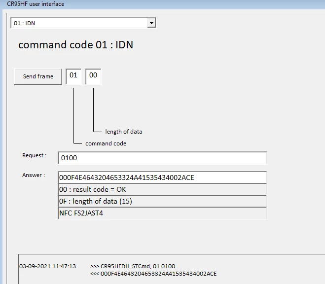

    LKowa.2
    LKowa.2Author
    Mar 9, 2021 10:20 AM UTC
    following Your guide I was able to send and read single msg in windows app. Unfortunatelly, supposedly I cannot write MB message longer than 56 bytes with this board:
    Could it be, that ST sells this kit with 2 different IC's?
    Ok, I checked that IC FS2JAST2 is obsolete and I found that You wrote in another topic that board with rev. B has correct IC- FS2JAST4.
    IDN command confirms that:
    I'll try again ;)

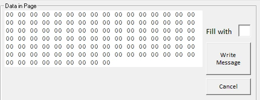

    LKowa.2Author
    Mar 9, 2021 1:58 PM UTC
    no, I have a board labeled MB1054 B-02 A20080013. This board was once recognized as QJC.
    I have uninstalled and installed again windows app (4th time :) ) and for now board is being recognized properly.
    I'm trying to automate all commands using built-in script tool. Strangely enough, while most of the time I don't get all data from MB - I was able to get full command from mailbox 2 times(in about 100 tries). I'll test it more tonight. Hopefully I'll find the golden sequence :)
    Side note, I tried to do everything manually, but by the time I write whole message in this box:0693W000008wPX3QAM.pngEH_Dyn_Reg VCC bit goes to 0 and my tag is no longer in FTM mode(as I said, it has a very aggressive power saving management).
