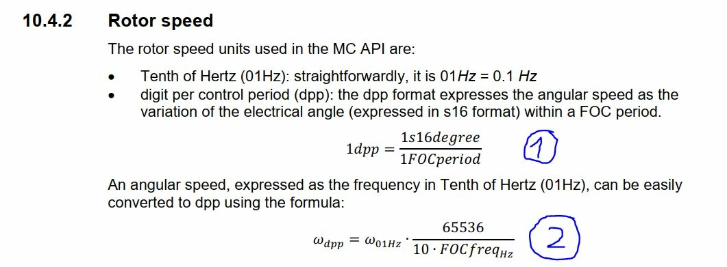

Hello~ my friends.
For rotor speed calculation, I have two problems
  1. How can you convert from equa (1) to equa (2)? If you know please explain a little detail for me.
  2. For rotor speed computation, why we use 0.1 Hz of frequency? why we don't use others frequency like 1Hz, 5Hz, or 10Hz...?
These above question make me curious. So, if you know, please tell me know. Thank you so much.

Let me try to better explain how the conversion between the two speed format is performed.
In formula 1, you have the definition of a dpp unit:
Electrical angle is expressed using a 16 bit integer (i.e. 1 rad = 65536) and the FOC frequency is used as timebase. This is your new "unit" for the speed calculations.
In formula 2, you have the conversion between the two units, let me split it in two intermediate conversions:
[dpp] = 65536 / FOCfreq [rad/s] --> 1 rad per second is equal to 65536/FOCfreq dpp
[rad/s] = 1/10 [rad * Hz/10] --> 1 rad by tenth of Hz is equal to 0.1 rad per second (i.e. rad by Hz)
then
[dpp] = [rad/s] * 65536 / FOCfreq = [rad * Hz/10] * 1/10 * 65536 / FOCfreq
All these unusual formats allows integer calculations instead of fixed point or floating point ones.
