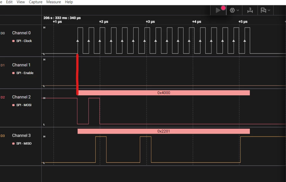

We are having SPI interface between TI C2000 MCU (TMS320F28P659DK8-Q1) and High Side Driver(L9026) the Our Target Board. Here are some observations regarding SPI communication. MISO(L9026) is not responding, not giving
  1. We are able to send data in L9026 & MISO is responding.
  2. Supply voltage of VDDIO=3.3V, VBATT=12V, IDLE (HIGH)=3.3V, IN0(HIGH)=IN1(HIGH)=3.3V,(All voltages are within the limit as per L9026 datasheet). I have attached the logs for that.
  3. We Sent in MOSI CFG_1: 0x8900 (put device in active mode, frame counter = 0).
  4. We sent in MOSI STA_1:0x4403 , but the response is 0x2201, not able to read device status register.
  5. We also checked in Idle mode too Supply voltage of VDDIO=3.3V, VBATT=12V, IDLE (HIGH)=3.3V, IN0(LOW)=IN1(LOW)=0V, in all the cases response not able to read device status register. I have attached the logs for that.

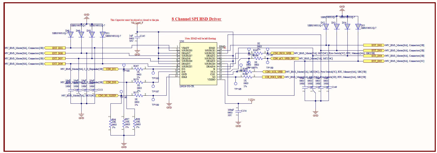

Please show the schematic of how you have the L9026 connected to the MCU.

Jan 15, 2026 1:28 PM UTC
Your master has incorrect CPHA=1. Data is changing on rising edge, it should be changing on falling edge.

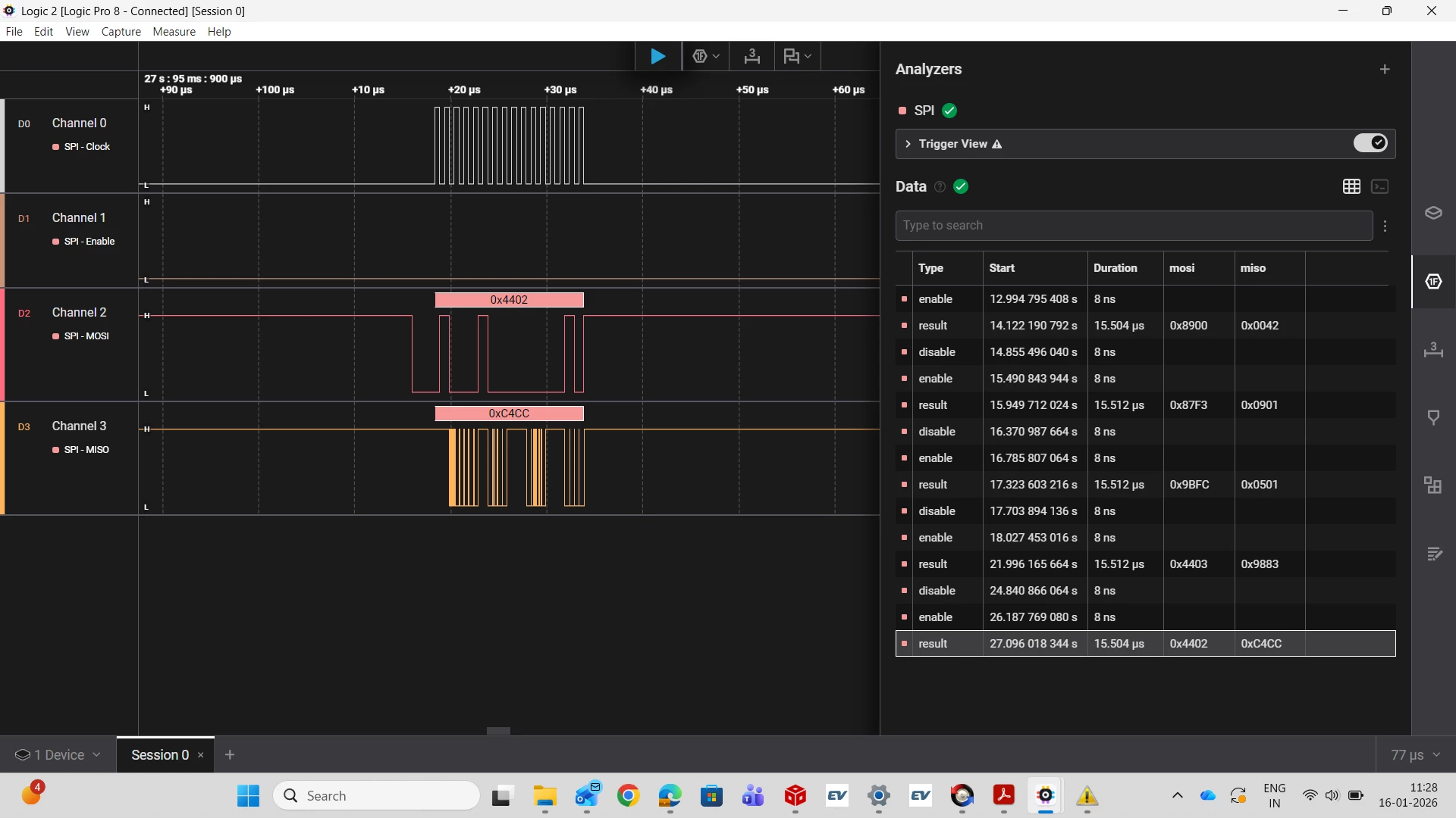

Hi, Thanks for your response. Now L9026 is working. one observation, when we are sending MOSI 0x4403, in MISO response is showing 0xC4CC(1100 0100 1100 1100) . 1 ERR error bit, ‘1’ if an error happened in the previous transmission. What type of error is happening ?
I have attached log & zip file for your reference.
Excellent. So please mark the solution - on the post which provided the answer (not this one).
That's a new question - please start a new thread for that.
