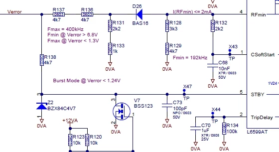

L6599AT Questions Q1: STBY pin does not stop pulses on gate drive outputs. Q2: Datasheet confusion for: (a) Soft-Start, (b) LINE.
Question 1:
In our circuit Pin 5 STBY is pulled down to 0V to instantly stop pulses on gate drives. But sometimes when STBY=0V we still see pulses at the gate driver outputs LVG, HVG. The datasheet does not mention that gate pulses may still happen.
I have noticed a similar question here:
https://community.st.com/s/question/0D50X0000AuqowSSQQ/how-to-disable-l6599-output
The answer to that question from Central Support suggests that using Pin 5 STBY is not a reliable way to stop gate drive. So then: what is the **best** way to immediately turn off both gate drivers? However, please note that we do **not** want to latch the L6599 off since this would require a power-cycle on VCC to restore gate drive pulses (eg: pin 8 DISABLE is not suitable, since it latches the chip OFF and requires VCC to go below ULVO level to re-start the chip. We simply want to shut-down & allow the re-start of gate-drive with a control logic signal. Our circuit schematic is below, to stop gate drive the STBY (pin 5) is being pulled down to 0V by V7, this has been confirmed with scope probe on V7 drain (X47).

Question 1
The pin STBY stops immediately the gate drivers, there is only a condition that could override the STBY signal: if the Css pin voltage is < 3V the STBY pin voltage is ignored. Therefore I suggest to double check that during normal operation the Css voltage is 2 V, as it should be after the soft start end.
The STBY is not intended to be used to stop the operation of the L6599A because this pin is designed to managed the burst mode of the converter, thus when the pin is released the converter restarts without any soft start, and this can be a dangerous transition for the converter.
To stop L6599A operation and restart operation safely it is recommended to pull down the LINE pin, it stops the L6599A and discharge the Css capacitor; in this way at next restart the converter will be soft started.

FBaro.11
FBaro.11Author
May 6, 2021 12:52 AM UTC
Hello Cristiana,
thank you for your detailed response. I have a question about your answer under Question 1.
You wrote: "if the Css pin voltage is < 3V the STBY pin voltage is ignored. "
Is the "< 3V" a typo - did you mean, perhaps, "< 0.3V" ?
I have other comments regarding the other responses, but perhaps it is best to deal with this one first, to prevent any further confusion.
Cristiana SCARAMEL
May 19, 2021 12:22 PM UTC
Hello @FBaro.1​ ,
Yes, it is typo.
The correct number is <0.3V, thus the correct statement is: “if the Css pin voltage is < 0.3V the STBY pin voltage is ignored.
"If you feel a post has answered your question, please click ""Accept as Solution"""
