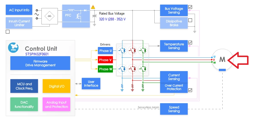

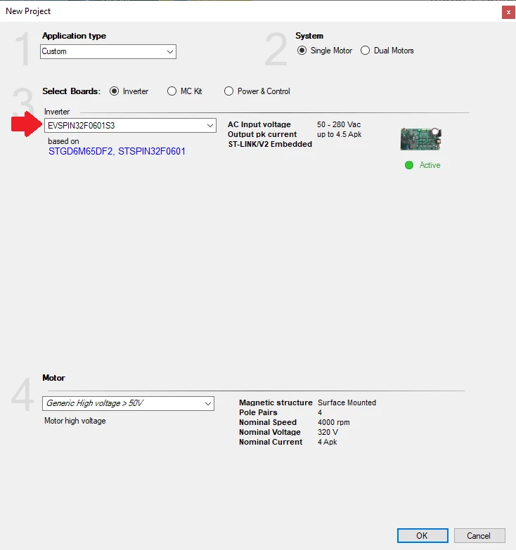

Open the ST Motor Control Workbench and click on new project. Select the board as shown in the figure below.
0693W00000592A1QAI.pngThen, click ok and in the project click on the motor: there you can customize the motor's parameters.
0693W00000592B9QAI.pngLet me ask you some more details about your description:

- Pole 4, in the tool you need to set the pole pairs, so in your case 2
