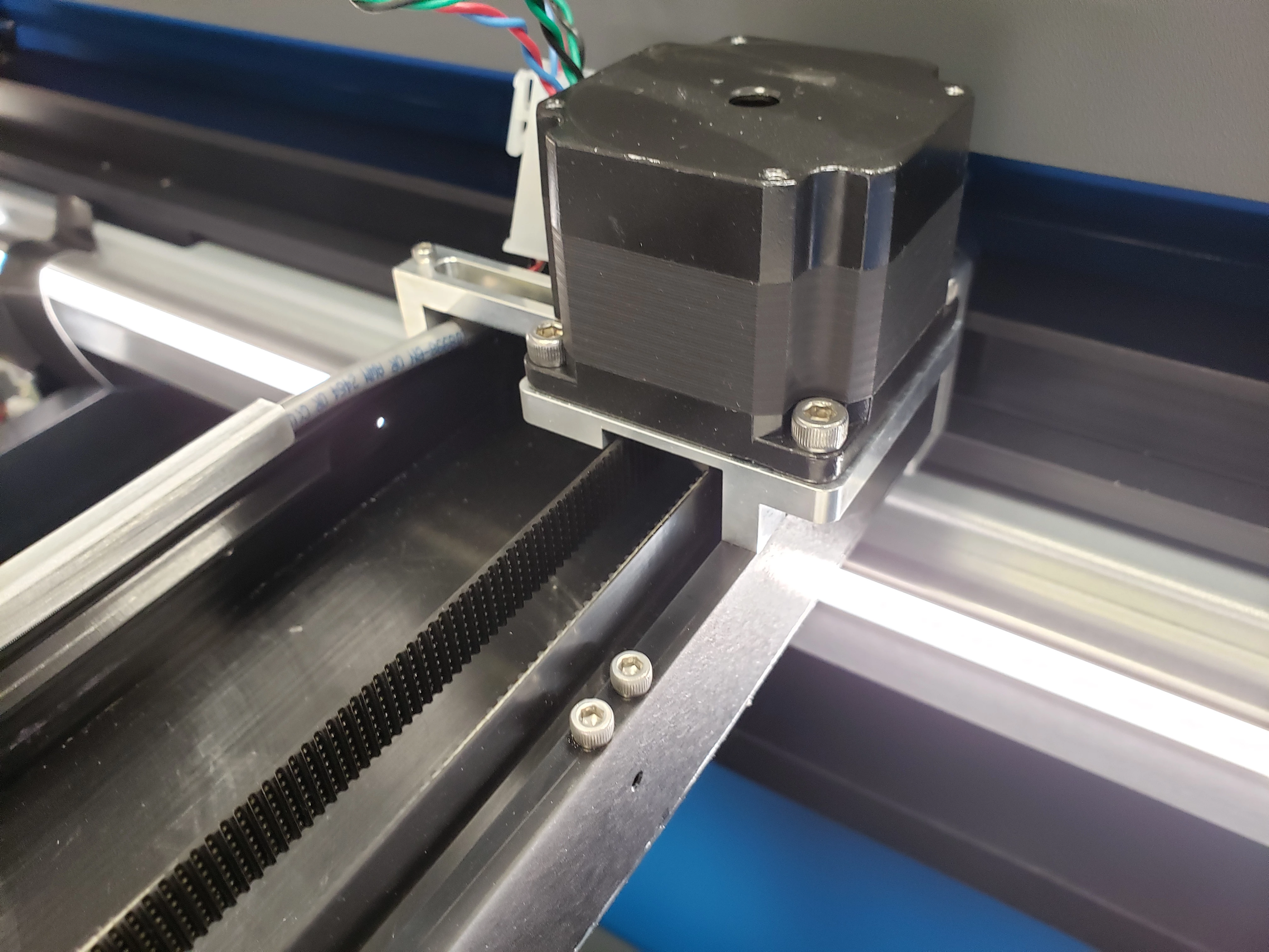

I am trying to do laser engraving with a POWERSTEP01. But I get high frequency oscillations on my motor.
I am in current control mode, and the stepper motor is using about 3 amps.
Is there anything I can do to reduce these oscillations.
Also note that the white line is about 0.010" thick.
I am using x16 microstepping, and I currently have 1600 microsteps per inch of resolution.

And further the used motor and the parameters, you use for initialization :) A picture of your mechanical setup could be also helpful (ball screws ? belt driven ? linear bearings ? moved masses ? ... and so on ... )

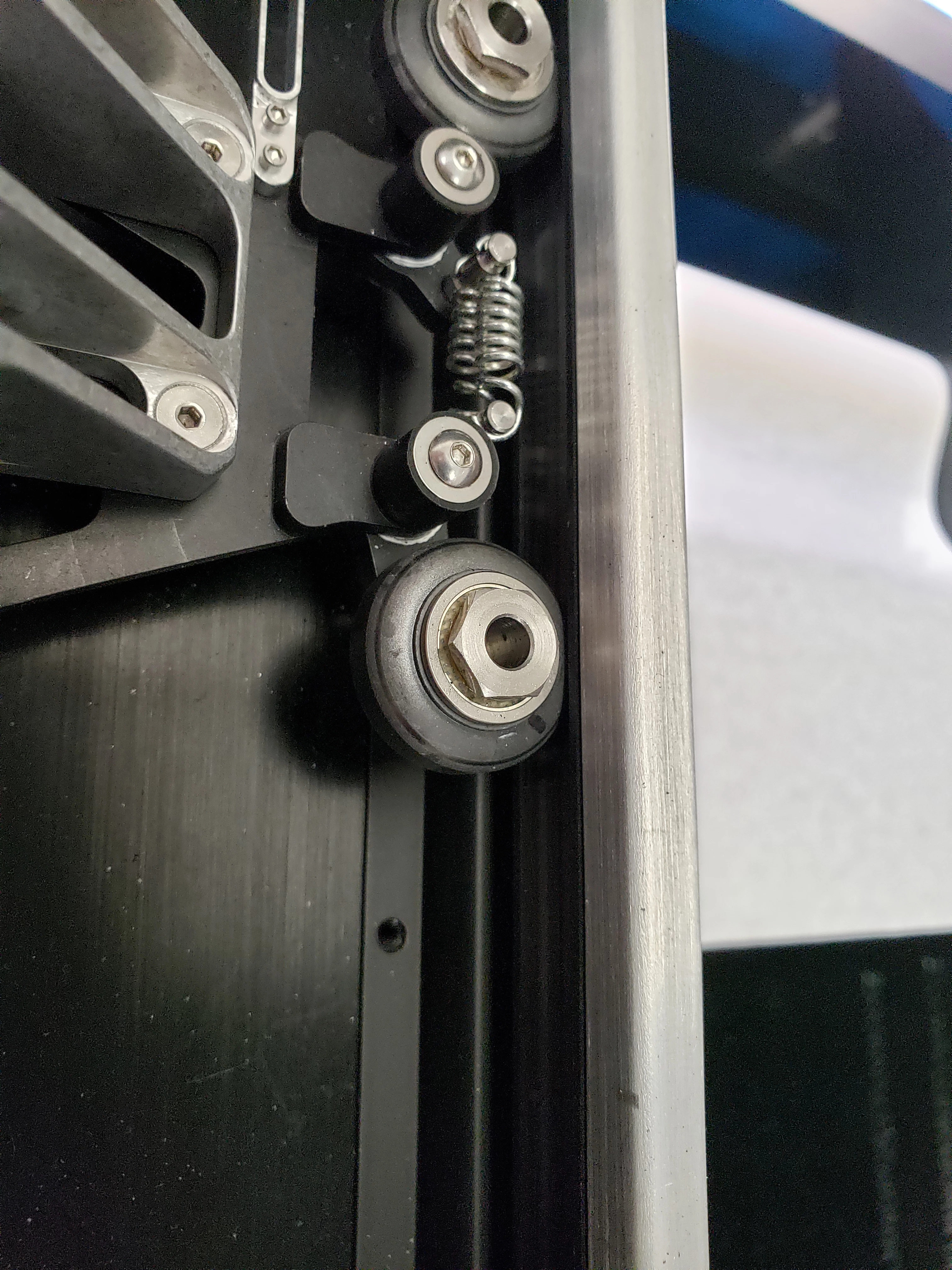

0693W000000Wc9QQAS.jpg0693W000000WcB1QAK.jpgThe application is a laser engraver.
The movements are made with an XY gantry on rolling wheels in a track, using a stepper motor attached directly to a belt drive,
We have other systems that don't have this problem.
