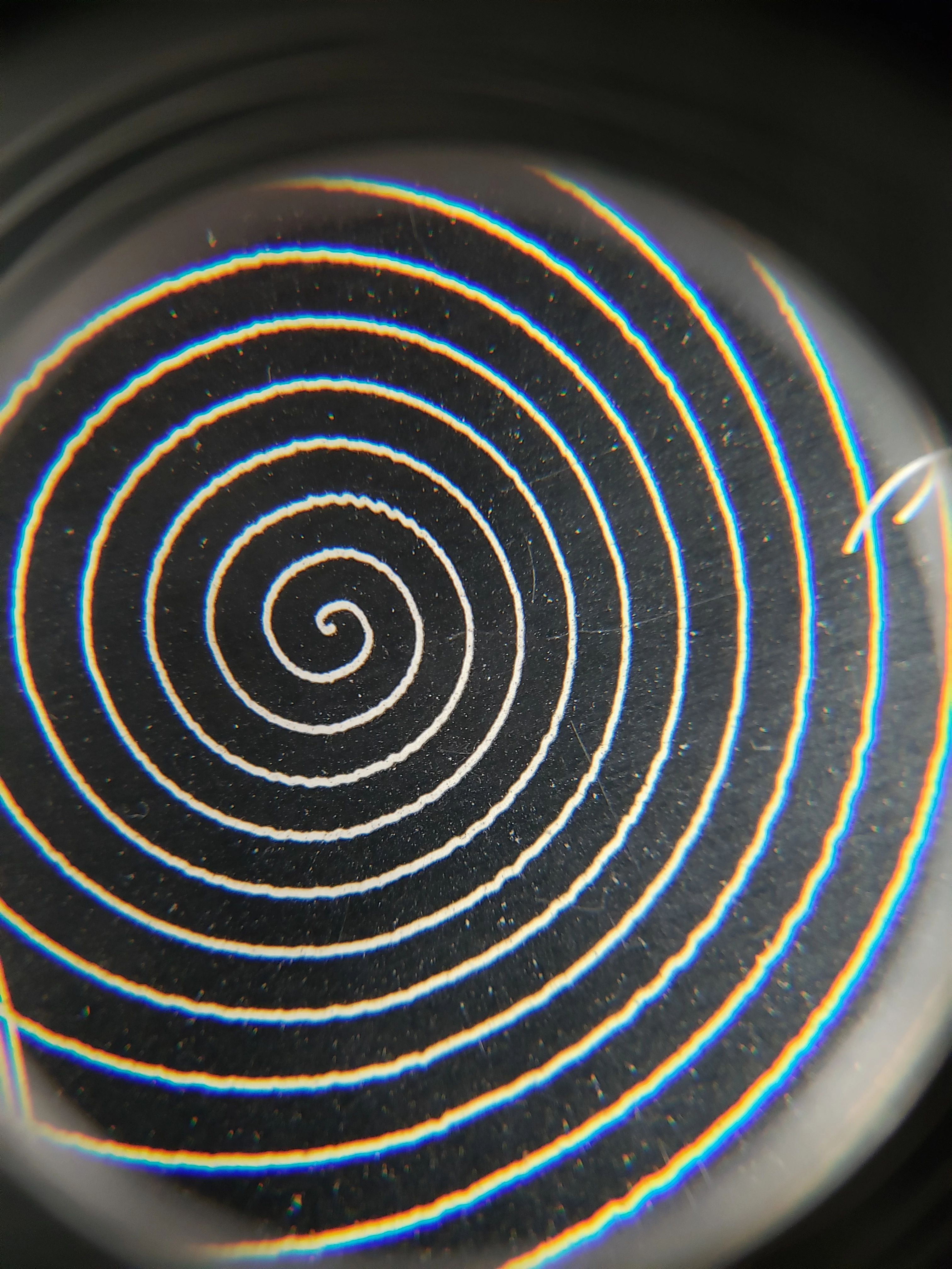

I am trying to do laser engraving with a POWERSTEP01. But I get high frequency oscillations on my motor.
I am in current control mode, and the stepper motor is using about 3 amps.
Is there anything I can do to reduce these oscillations.
Also note that the white line is about 0.010" thick.
I am using x16 microstepping, and I currently have 1600 microsteps per inch of resolution.

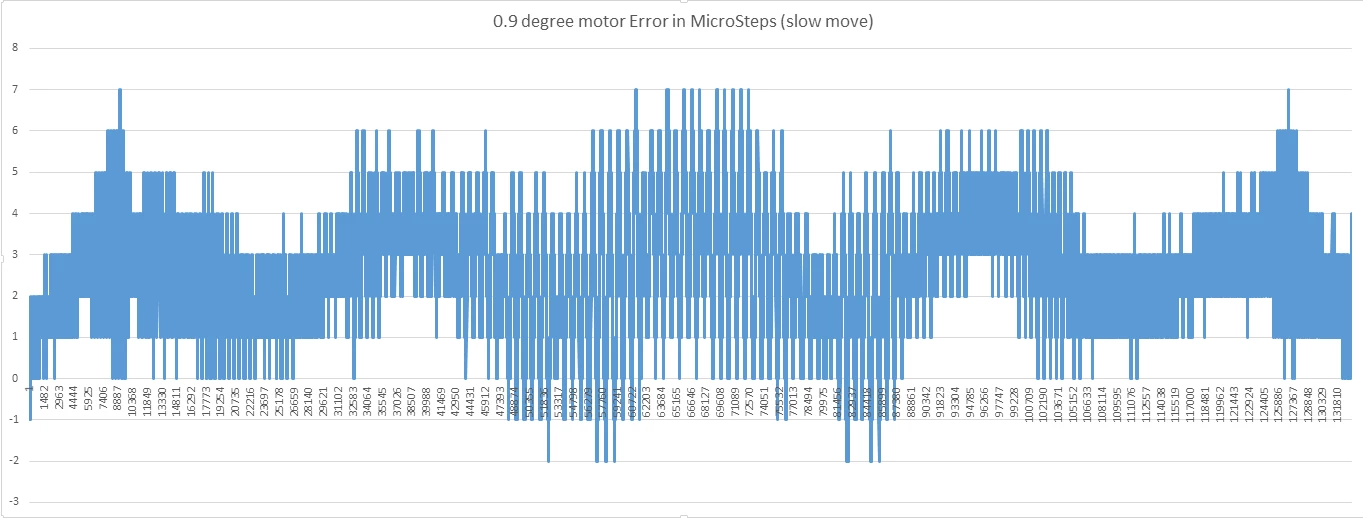

I attached an optical encoder to my stepper motor, and then captured my step pin, and the quadrature data using high speed logic analyzer,
I moved a distance of 6 inches in this plot.
I then plotted the difference in microsteps between my microstep position and encoder position (translated to microsteps).
Does this look normal? Is this normal stepper motor resonance? For x16 microstepping in current mode, I am off from -2 to 7 microsteps.
with a very high frequency oscillation. This definitely explains the oscillations I see in the laser engraving.
