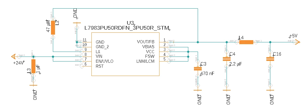

I'm trying to design an voltage regulator on a motor control board. I want an output voltage of 5 VDC and the input voltage is 24 VDC. Because of heat production i was thinking about using a switching regulator like the L7983 followed by an L7805. But I'm unsure if the frequency of the switching regulator will effect the output signal of the L7805. I need the 5V for the microcontroller and the current sense amplifier.
Or is there an easier way?
Thank you very much

    FKamm.2
    FKamm.2Author
    May 4, 2022
    Hello Peter,
    so the result is the circuit diagramm in the picture. Could you please have a look at it?
    I want to use the 1000 kHz, therefore i connectet FSW to VCC. And because i want to use the LNM i connected it also to VCC.
    Do i have to calculate the whole PI-filter, or just the L4 because C4 = 2.2µF (from the datasheet) and C16 has to be equal?
    VOUT will be +5 V and will be connected to the other parts like the INA and the microcontroller.
    Do i have to add another capacitor to filter the input voltage?
    Thank you very much.
    best wishes,
    Fabian
    Peter BENSCH
    May 5, 2022
    • You have drawn L3 with 1µF at the input by mistake - this should be a capacitor, otherwise you would have a short circuit.
    • VBIAS should not be connected to VCC (3.3V), but to VOUT (which is also mentioned in table 8), because the voltage difference to SWO Threshold (3.2V) is somewhat small.
    The output voltage at pin 1 (VOUT) can supply the microcontroller, while the +5V at C16 is fed to your analog measurement circuit.
    C4/L4/C16 form the Pi filter. The values of L4 and C16 result from the desired attenuation: for a cut-off frequency of e.g. 100Hz you will need about 100mH and 22µF.
    Please choose the saturation current of the inductors L4 and L2 larger than their peak current, because otherwise the inductance collapses and the function of regulator and the filter is no longer guaranteed. C16 should either be a ceramic MLCC only, or a parallel connection of e.g. 22µF tantalum and 0.47..10µF MLCC.
    Regards
    /Peter
    FKamm.2
    FKamm.2Author
    May 5, 2022
    oh, yes that was a drawing mistake.
    thank you very much! i dont have a contact person for these questions in my company, sorry for the detailed questions.
    Wouldnt it be better to supply the microcontroller after the pi-filter because of electromagnetic interference?
    So that the path of the pulsed signal is as short as possible?
    Do you think the 1000 kHz are a good compromise? A higher frequency will lead to a smaller ripple voltage, but a frequency
    choosen too high is bad because of the electromagnetic interference.
    Regards,
    Fabian
    Peter BENSCH
    May 5, 2022
    The supply of the mcu should be taken before the filter, because otherwise you will have the ripple caused by the switching currents of the mcu fully on the analogue supply. This is exactly the case you want to avoid, right?
    You can think of your circuit like this:
    1. the output voltage at pin 1 (VOUT) supplies the digital section, e.g. the mcu
    2. the +5V at C16 supplies the analog circuitry
    BTW: an mcu with 5V supply? Sounds like an old one.
    Regards
    /Peter

    Peter BENSCH
    May 5, 2022
    I forgot to answer your last question: 1MHz could well be a sensible frequency, but of course it also has disadvantages. EMI is an issue that can be dealt with by a very well thought-out layout (current paths GND and input/output voltage, especially the nets VIN and LX).
    Another issue is the choice of passive components, as this also has a great influence on the EMI generated. Here, L2 should be emphasised, whose construction contributes significantly, which is why a magnetically shielded inductors should be used.
    Of course, you can also use a lower switching frequency such as 200kHz, but this requires larger component values for L2, C4 and L4, which in turn increase their mechanical size.
