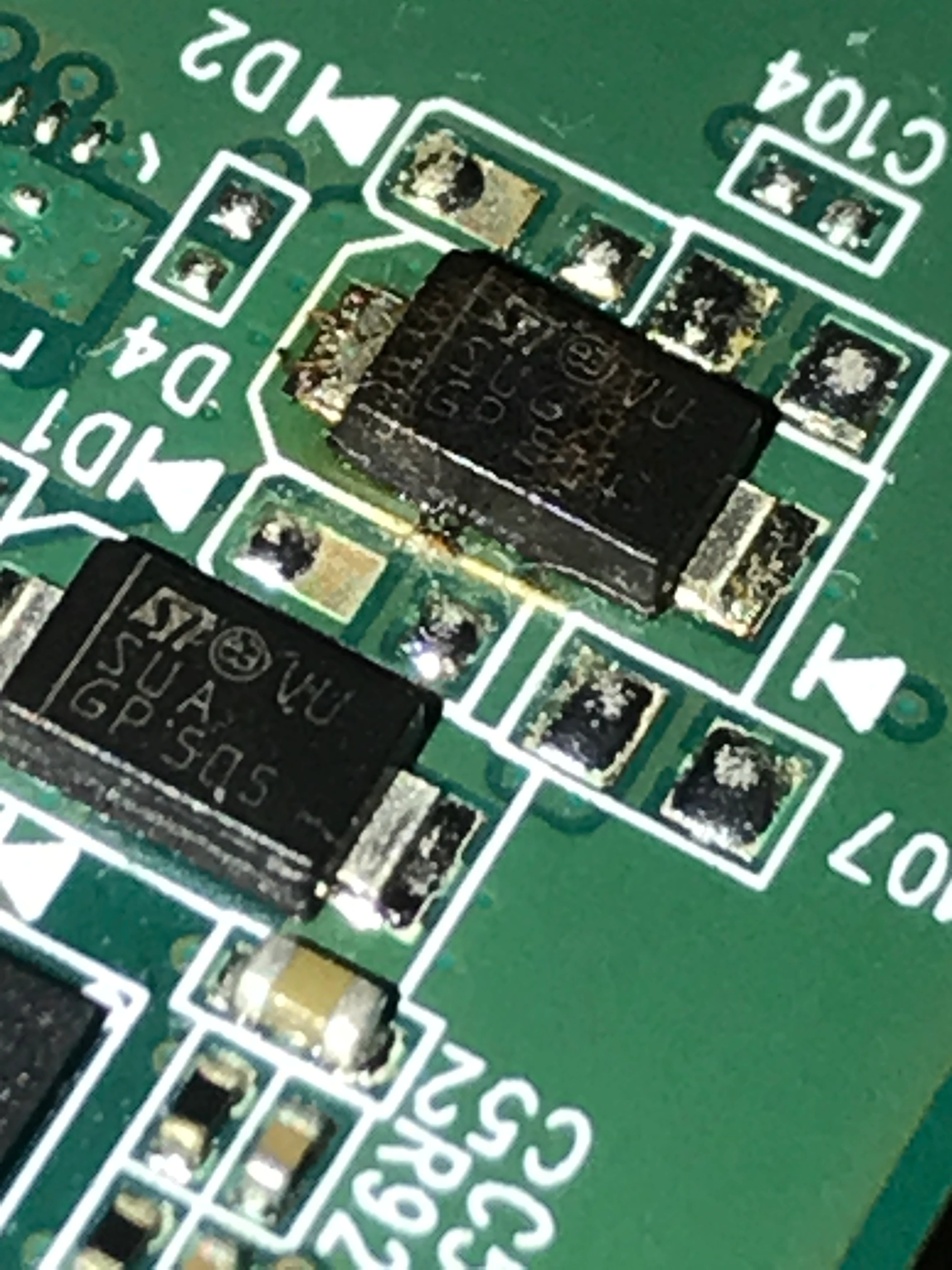

Could help me identify this HDD (Hard Drive PCB) TVS diode part? SUG SUA
Hi ,
Could help me to identify the model of this TVs diode
it’s from WD external 4TB HDD
Thanks in advance.

"the marking is SUA, which corresponds to the SMA6F5.0A-TR, which can be found today with 6AI marking."
https://community.st.com/t5/other-hardware/hi-could-you-please-help-me-identify-this-diode/td-p/197883

Thanks for reply ,
What about the first TVs Diode which stands with SUG marking ?

As it is it shows up in my feed, I'm Ok with it, and the more times we answer the better the chance of a direct Google Hit for the self-service customers
These particular diodes being a pain due to lack of marking documentation, and the markings changing from current issue parts.
ST STMICRO DIODE SUA SUG MARK MARKING
HARD DRIVE DIODES
600W TVS
OLD: SUA SMA6F5.0A NEW: 6AI
OLD: SUG SMA6F13A NEW: 6AY
