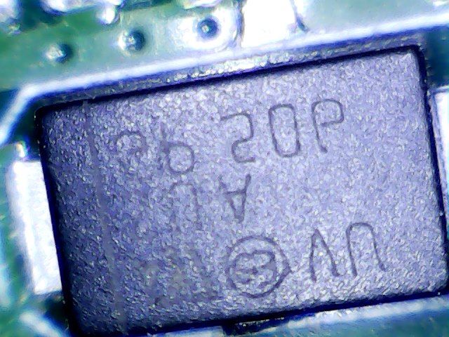

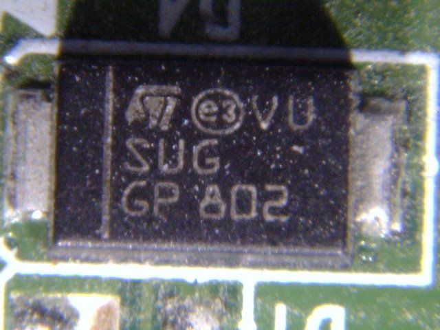

I am having difficulty locating information regarding some diodes. These diodes are either zener or TVS.
Can anyone help me identify it? A link to a cross reference information page would be really helpful.
Will be looking to source them for repair projects.
Thank you for your time and efforts.

Welcome @Kazit,
marking SUG stands for the SMA6F13A-TR, SUA for the SMA6F5.0A-TR.
Both are obsolete, but can be replaced by SMA6J13A-TR and SMA6J5.0A-TR.
