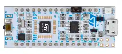

As for using Nucleo... how I suppose to fit it inside device on photos I posted? Rhetorical question.
Use a Nucleo 32?
https://www.st.com/en/evaluation-tools/stm32-nucleo-boards/products.html?querycriteria=productId=LN1847$$1574=Nucleo-32
