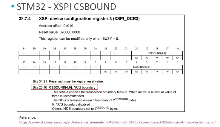

Concerning the doc you shared is there any modification to be done in Cube MX
Thanks
Alex - APMemory
February 4, 2026
Good to and thanks for the confirmation using the "OB9" version successfully
you can use the "OBR" & "OB9" version with the same configuration.
The report is advising a second point, which is the recommendation to use the CSBOUND function, rather the  RBX read option (row boundary crossing). if your SW is already done, no need to change, but if not, this is a better habit to take.
Cross-page access: Method 1: By PSRAM RBX(Row Boundary Crossing) feature if available
Single-page access: Method 2: By controller page-boundary setting if available   => RECOMMENDED
