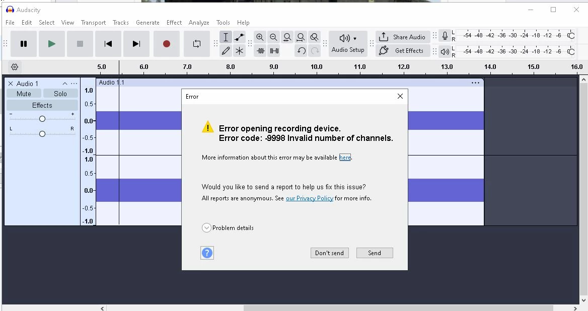

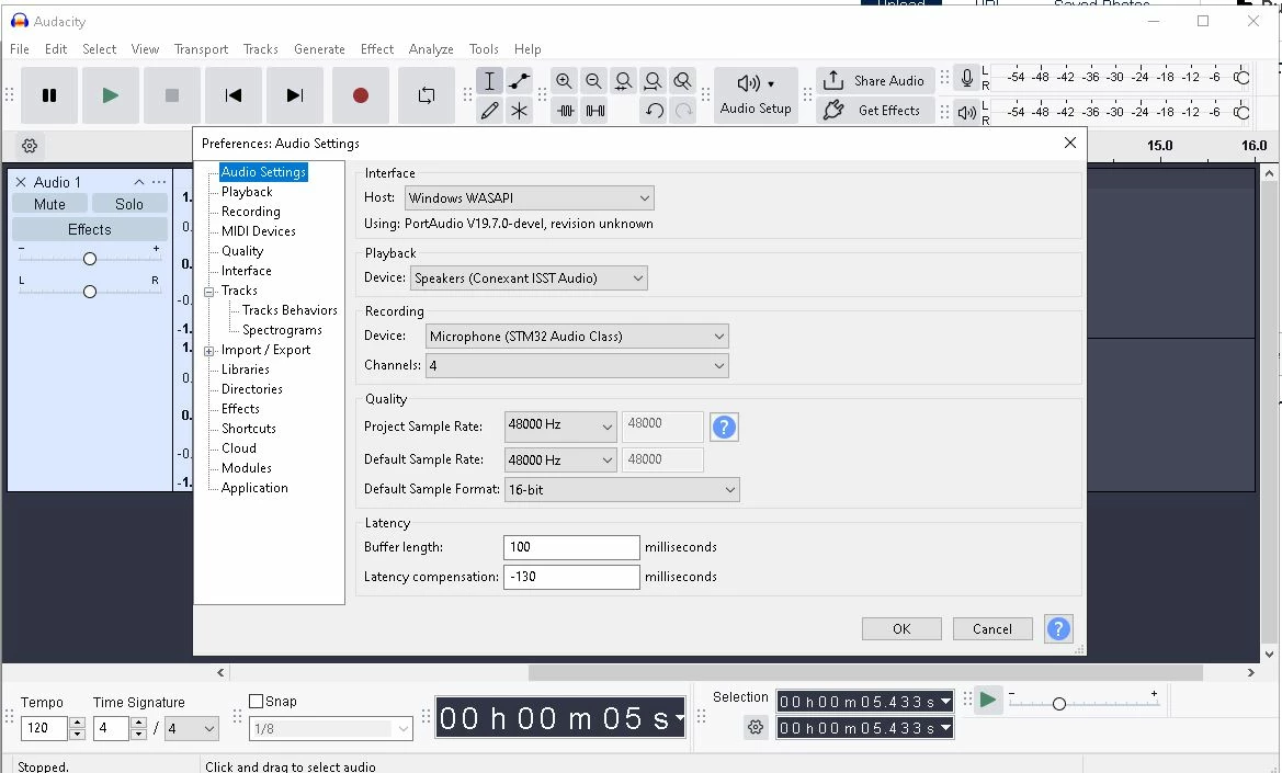

I am implementing a USB Audio Class 1.0 microphone on an STM32 (Full-Speed only).
The device enumerates correctly on Windows and appears as a 4-channel microphone in the Sound Control Panel, but no WASAPI-based application can open the input stream.
When using Audacity with WASAPI, the device exposes only 1–2 input channels and recording cannot be started.

Setup:
  • STM32 USB Device (FS)
  • UAC 1.0, Isochronous IN (microphone)
  • PCM, 48 kHz, 16 bit, 4 channels
  • Iso IN Endpoint: Adaptive
  • Windows 11

You see? Same problem. I also got same issue  on STM32H743iitAudiosity.JPGAudiosity_1.JPG
