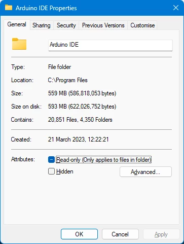

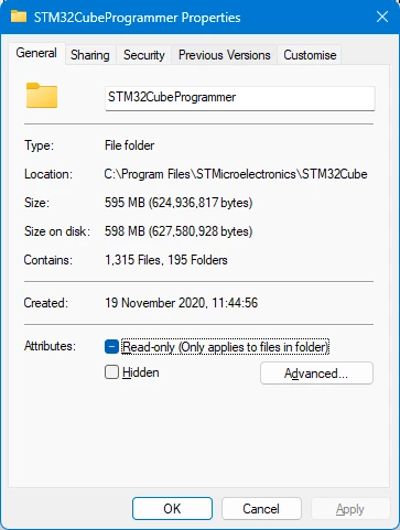

83.5 MiB is very small for a partition these days!
On Windows, the CubeProgrammer installation is nearly 600MB:
and Arduino IDE is 600MB:

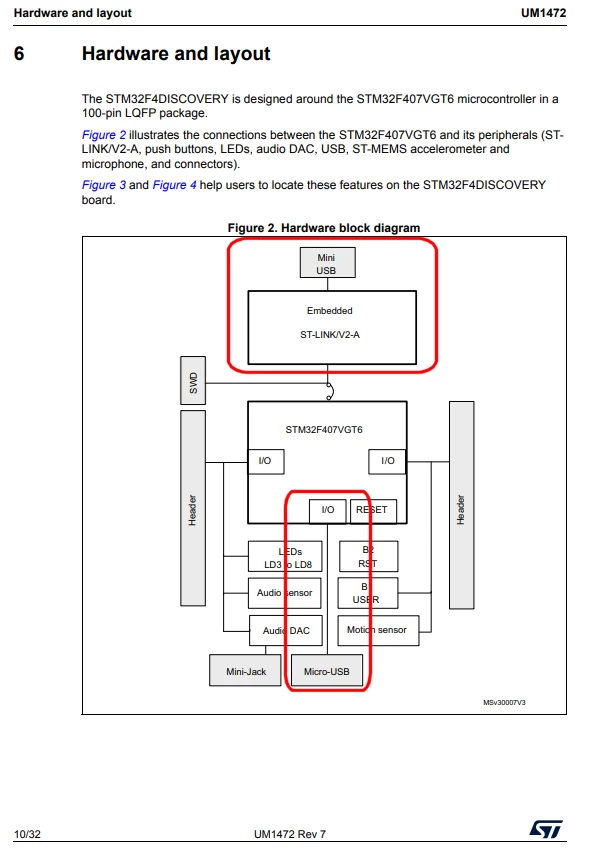

The Discovery-F4 board has two USB ports, one for the debugger module (ST-Link), and the other connected to the '407 processor. Unless you explicitly put code into the '407 that uses the USB port, it does nothing.
You talk to the board and power it through the miniUSB port, CN1.
CN5, the microUSB connector, is for your user application and should not be used to power the board. It is connected to the large chip, the '407, U4.
With two cables attached, you'll likely only see three new USB devices, a serial port, a virtual disk drive, and an ST-Link debugger that are provided by chip U2. The serial port COULD be connected between U4 and U2 and there are instructions on embedded.fm to show you how. The disk drive can be used to load programs into U4 in a drag/drop manner. The ST-Link is a debugger module that helps you load and run programs in U4.

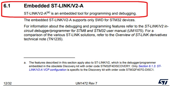

@SElli.11 this is all described in the User Manual:
https://www.st.com/resource/en/user_manual/um1472-discovery-kit-with-stm32f407vg-mcu-stmicroelectronics.pdf#page=10
via: https://www.st.com/en/evaluation-tools/stm32f4discovery.html#documentation

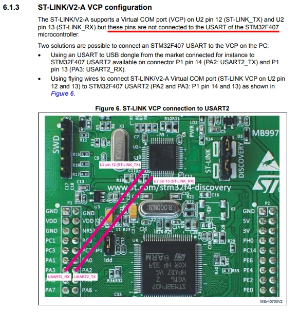

On this board, note that the ST-Link's Virtual COM Port (VCP) is not connected to the Target MCU - you have to wire that manually yourself:
