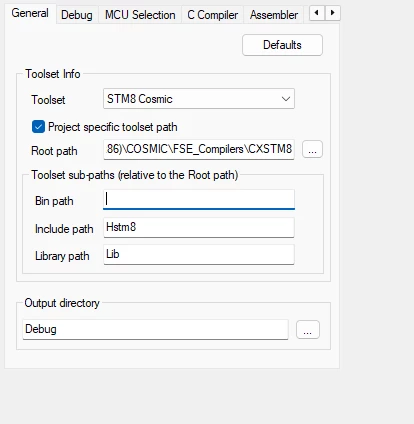

I am working on a project using an STM8S003F3 MCU with ST Visual Develop (STVD), Cosmic C Compiler, an
d a clone ST-Link V2 programmer.

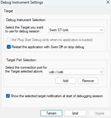

I am having an issue with debugging. When attempting to start a debug session in STVD, I get the following error:
Connection error (usb://usb): swim error [30006]: comm init error: chip does not answer.
Important details:
  • If I open ST Visual Programmer (STVP) and perform a few Read/Write attempts, STVP eventually starts working and can read and program the chip without issues.
  • However, after doing this, only programming works—debugging in STVD still fails completely.
  • Additionally, in STVP, the Erase button is grayed out and disabled.
  • Signal levels and waveforms look fine at a quick glance on the scope (though I haven't done an in-depth signal integrity check yet).
  • I have used a similar ST-Link clone setup before without any issues.
Could this be caused by the ST-Link clone, or is it possible that the STM8 chip itself is a counterfeit/clone? Has anyone experienced a similar issue or have any advice on how to solve this?
