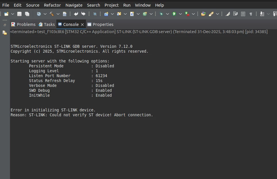

I was working on STM32F103C8T6 Bluepill board. I was using this board with ST-LinkV2 to connect with CubeIDE. When i tried to flash a sample LED blink program via CubeIDE, it gave an error saying 'Target not found'. But at the same time i was able to connect this board via cube programmer using same ST-Link and write sample LED code into the board.

so from link to robu ....  read the comments, before buy (next time.) :
So its probably a real fake : STM32F103 written on it , but other chip inside.
And your Chinese st-link probably also, thats why IDE telling: could not verfy ST device.
What you could do now:
- for simple test and learning you can make programs with IDE , but flash the clone with CubeProgrammer.
- no debug possible , no connect in IDE
- for better behaviour, debug in IDE etc. , buy a cheap nucleo board (genuine from STM) , like this:
https://robu.in/product/nucleo-f303re/
+ here also the st-link attached, can separate even.

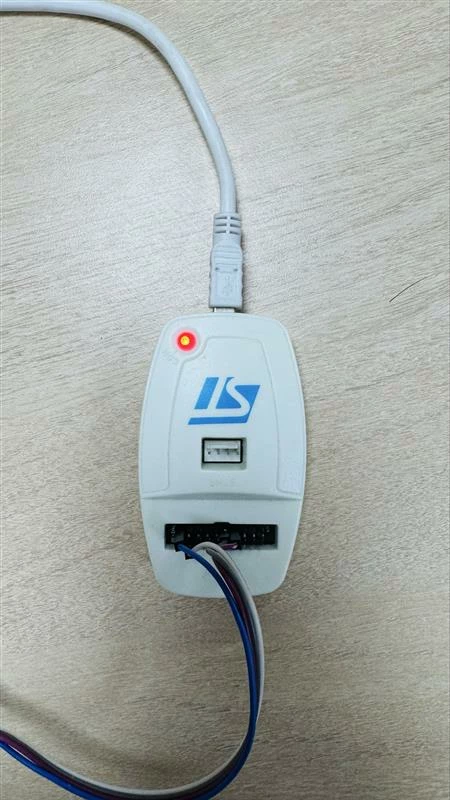

Note that "Blue Pill" is not an ST product, and likely contains a fake STM32.

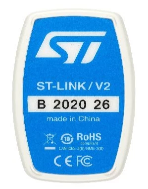

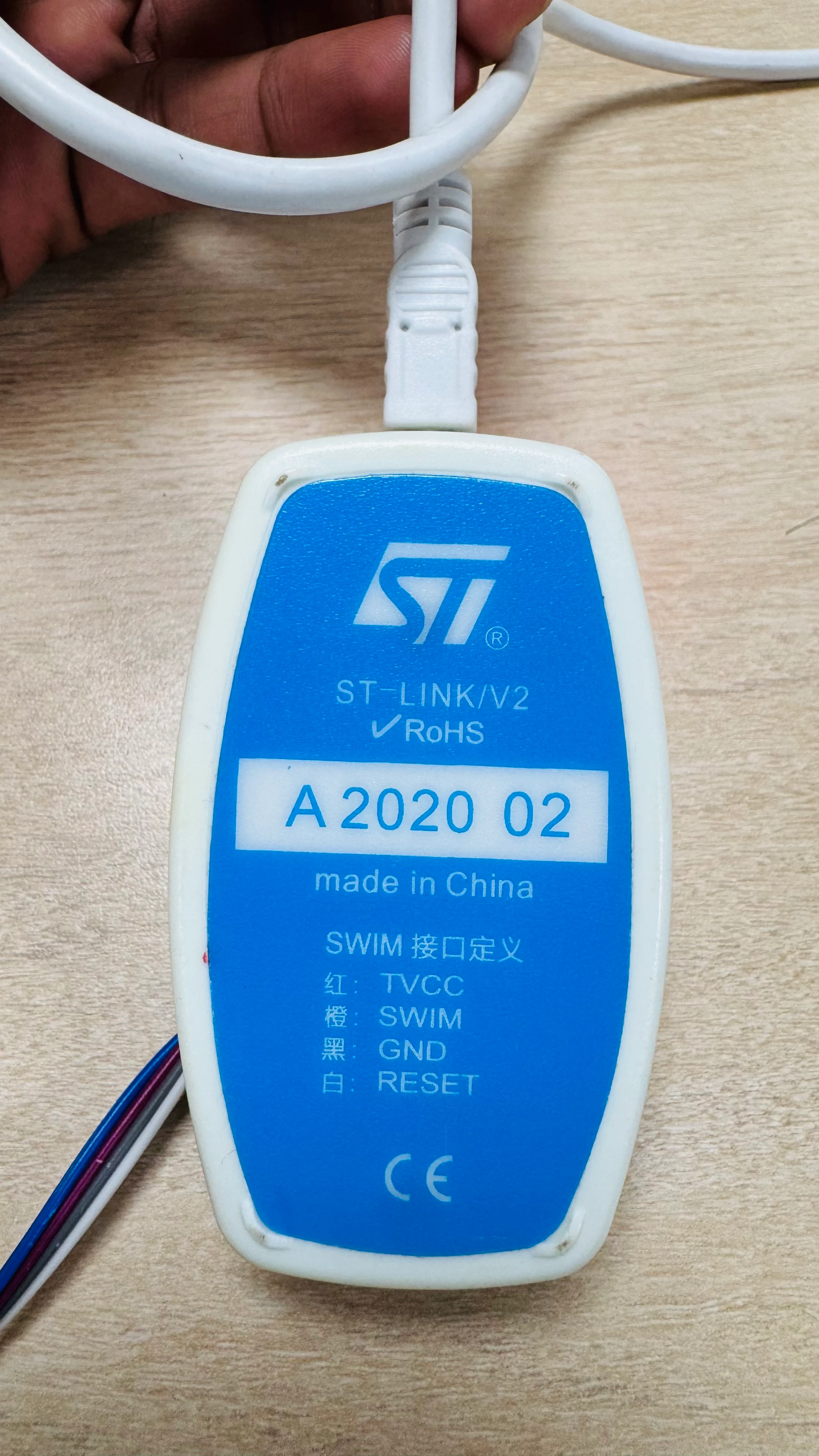

Also, are you using a genuine ST-Link, or a clone/fake?
How to recognize a genuine ST-LINK/V2 versus a cloned one. TL;DR: if it looks like a USB memory stick, it's a clone.

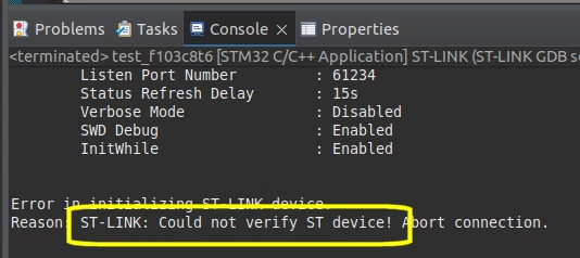

Please show the full error message, and log.
It is common that CubeIDE will refuse to work with clone chips & ST-Links; CubeProgrammer may be more forgiving.

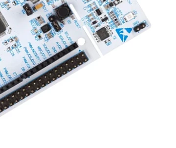

ST's NUCLEO-F103RB gives you:
  • A genuine STM32
  • A genuine ST-Link
  • Actual support
  • Ready-to-go examples
  • etc, etc, ...
I would certainly recommend this as a better option for a beginner and, by the time you've bought a Blue Pill plus separate ST-Link, it may not even be any (or much) more expensive!

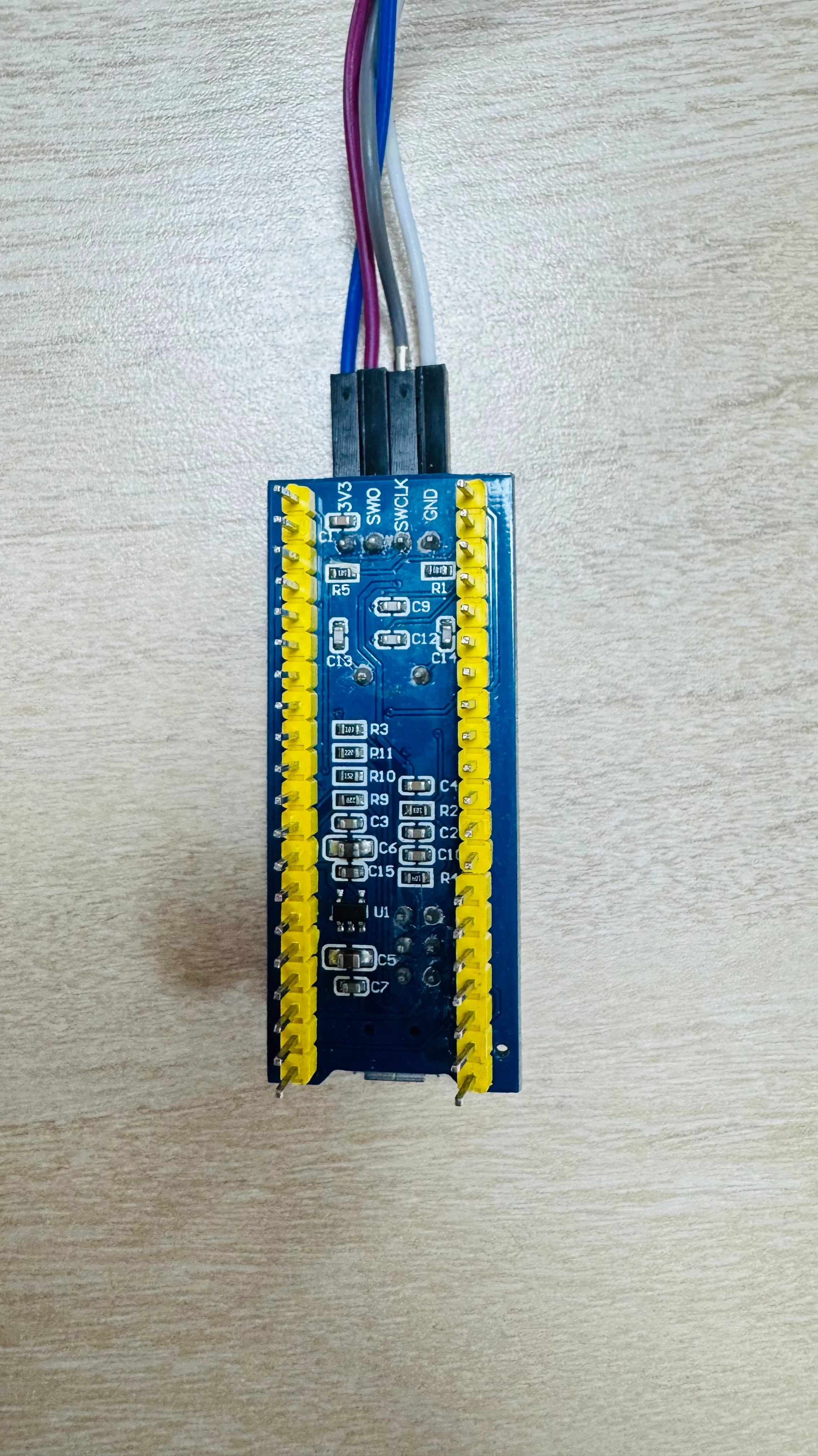

Dec 31, 2025 10:38 AM UTC
I am using genuine ST-Link(photo attached).
Error message from CubeIDE and photo of Bluepill board attached.
I am using CubeIDE Version: 2.0.0 and CubeMX Version 6.16.1 on Linux 22.04.

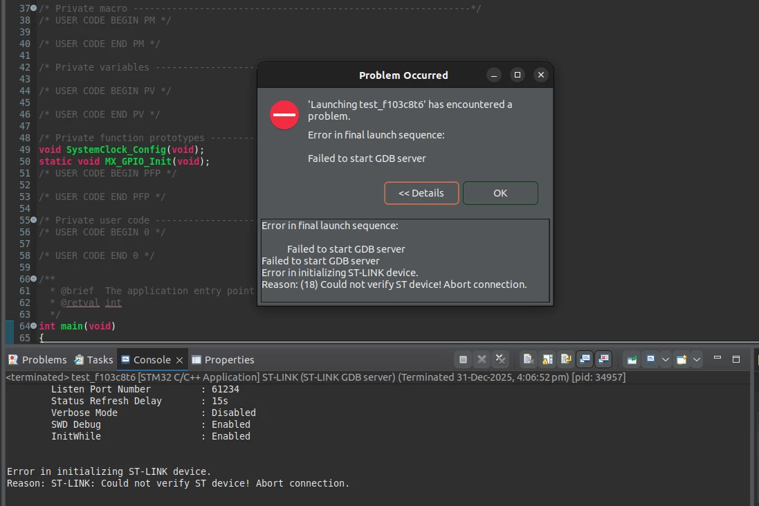

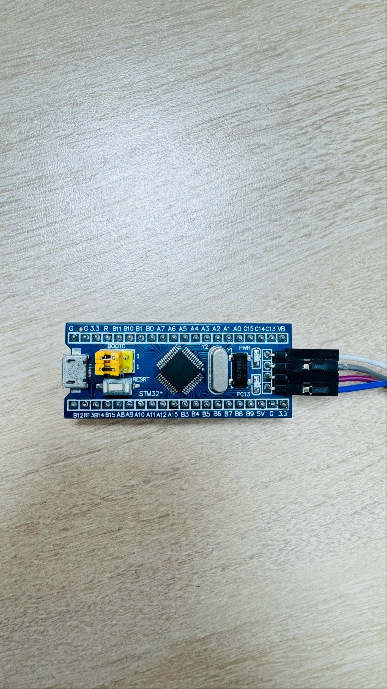

product I am using : https://robu.in/product/stm32f103c8t6-minimum-system-board-microcomputer-stm32-arm-core-board/Image.jpegImage (1).jpegImage (2).jpegImage (3).jpegissue facing while trying to debug - GDB issueissue facing while trying to debug - GDB issue
I am also facing a GBD error while trying to debug
Andrew Neil
Dec 31, 2025 10:59 AM UTC
Your photo does not match the How to recognize a genuine ST-LINK/V2 versus a cloned one article:
I think that is to be expected with a fake STM32 and/or clone ST-Link.
Again, I would strongly recommend that you at least start with a genuine ST board,  so that you can gain familiarity with the product & tools using known-good hardware - without having to worry about all the extra unknowns with fakes/clones.

AScha.3

1. was the board + st-link working before, or is this first test ?
2. IDE checking for "fake" target, thats almost just other manufacturer of F103-similar chip, CubeProgrammer more "forgiving"  , also works with F103-similar chip.
3. show good pic of F103 on bluepill board, if possible .
4. show link, where /what you buyed as bluepill + st-link .
Dec 31, 2025 10:39 AM UTC
I have replied in @Andrew Neil comment with details you have requested for.

Also, "3. show good pic of F103 on bluepill board" means a good closeup of the MCU chip so that we can see exactly what's written on it.
This diagnostic may also help to see what MCU is actually on your board:
https://mecrisp-stellaris-folkdoc.sourceforge.io/bluepill-diagnostics-v1.6.html#diags-1-6

Dec 31, 2025 11:14 AM UTC
Why do I feel your ST-Link connections are wrong?!
Could you please verify that once.

@kiranraj_k_r - Yet another advantage of a Nucleo board: the ST-Link (and VCP) is already connected - so no chance of getting that wrong!
