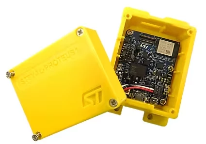

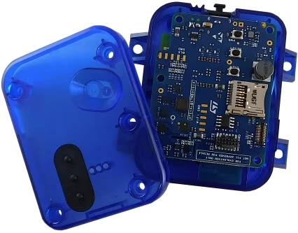

If you want a ready-made unit to do this part, consider:
STEVAL-PROTEUS1 - Industrial sensor evaluation kit for condition monitoring based on the 2.4 GHz STM32WB5MMG module
STEVAL-STWINBX1 - STWIN.box - SensorTile Wireless Industrial Node Development Kit

STEVAL-STWINKT1B
Meanwhile, it's an NRND product (not recommended for new design).
