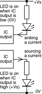

Hi Usualy I see terms called pushpull configuration,open drain, pull up ,pull down and so on.what are the difference between them

These are general electronics terms - nothing specific to STM32 or even ST:
PS:
It is conventional to refer to the supply voltage as "up" and ground as "down"; hence:
  • A Pull-Up pulls "up" to the supply voltage;
  • A Pull-Down pulls "down" to ground.
Again, nothing specific to STM32.
PPS:
Source/Sourcing and Sink/Sinking are also common terms relevant here:
https://electronicsclub.info/ics.htm#:~:text=Sinking%20and%20sourcing%20current
  • A Push-Pull output can both source and sink;
  • An Open-Drain (or Open-Collector) output can only sink.
