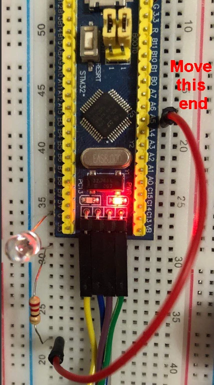

I used the settings and code below for a simple project: Blink an external DIP LED using the blue pill:
In Pinout & Configuration:
- PA5 => GPIO_Output
- user label: LED
The wire connections (like screenshot below):
PA5 pin => Resistor => Long leg (anode) of LED
Short leg (cathode) => GND on Blue Pill
And finally code:
while (1)
HAL_GPIO_TogglePin(LED_GPIO_Port, LED_Pin);
HAL_Delay(500);
/* USER CODE END WHILE */
/* USER CODE BEGIN 3 */
}But the LED doesn't turn on!
What could be the reason?
The .ioc file is also attached.
