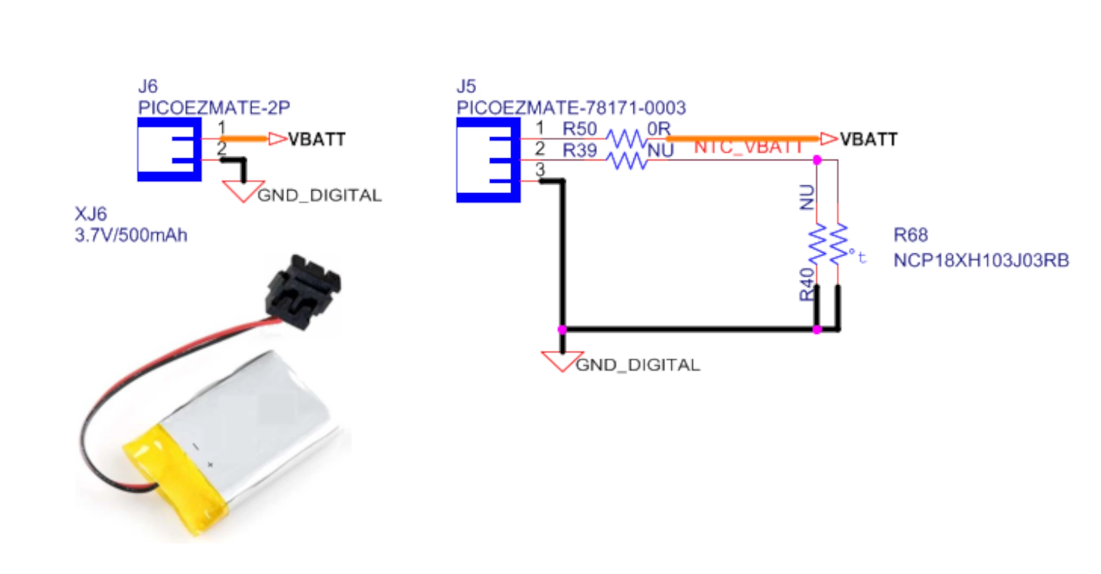

Where can i get the download for the updated SensorTileBox firmware, SENSORTILE.BOX_v341.bin?
I captured it when the device asked for the update but the file may have gotten corrupted. Loaded v3.41 using STLinkv2 and the sensortilebox now appears to be dead. The file I have is 726691 bytes and doesn't appear to work. Sensortile won't boot, no LEDs.
thanks,
tjm
    Eleon BORLINI
    Eleon BORLINIBest answer
    Jun 16, 2020 1:16 PM UTC
    Well, just checked and you are right... The version I shared with you was without the Bootloader code section. Please find attached the complete FW version. Regards

    Mar 16, 2021 4:35 PM UTC
    Eleon, thanks once again. Checked the post and 'liked'.
    Good call on checking the BOM.
    For future reference, I happened to find the part number just by accident while looking over page 2 of the sensor box schematic.
    Thanks,
    Tony
