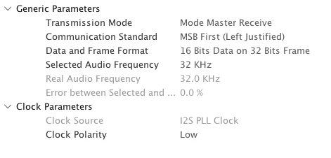

Consider the STM32F401RE Nucleo board connected to the IMP34DT05 PDM microphone with L/R to GND.

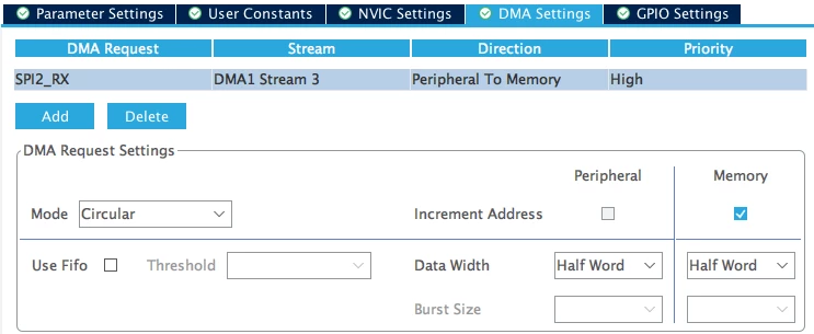

Through Mx, the I2S peripheral is configured as follows:
0693W00000GYxgwQAD.pngThen, the DMA is configured as a circular buffer, half-word:

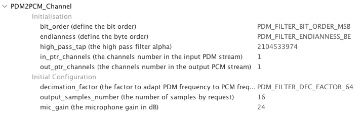

0693W00000GYxe3QAD.pngFinally, I have configured the PDM2PCM library as follows:
0693W00000GYxi9QAD.pngStarting from that configuration I'm having trouble understanding why the PDM2PCM is not working as expected.

Having configured the DMA as a circular buffer, I would expect that at every interrupt Half of the buffer is filled with new data, while the other half is used to run the PDM_Filter function and complete the PCM conversion and copy the data out to the pcm_data.
However, running the code above I observe that only half of the pdmRxBuf is filled and the other half has all zeros. Why is that happening?
Did I misunderstand some configurations?
Because what I get at the output is simply noise.

thanks for your reply. I have partially solved the issue.
Now I have 16kHz selected audio frequency, 16-bit data on 16 data frame, 64 decimation. Therefore the I2S clock should be 1.024MHz.
I record the audio of a pure tone (e.g. 500Hz) and then I convert it to a 16bit, 16kHz .wav file. The problem is that the recorded audio, played has double the frequency of the pure tone (1000Hz in this case). How could it be possible?
Changing the data and dataframe format to 24-bit in 32 data frame solves this issue.
But I don't undestand why!
Why with 16-bit data the pure tone appears with a double frequency?
