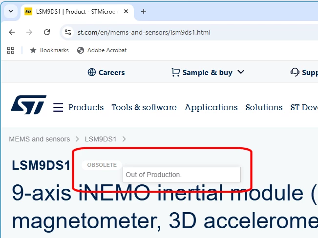

PS:
When you hover your mouse over the 'OBSOLETE' tag on the Product Page, it tells you what it means:
So it's no longer in production - once any current stocks are exhausted, no more will be made.
