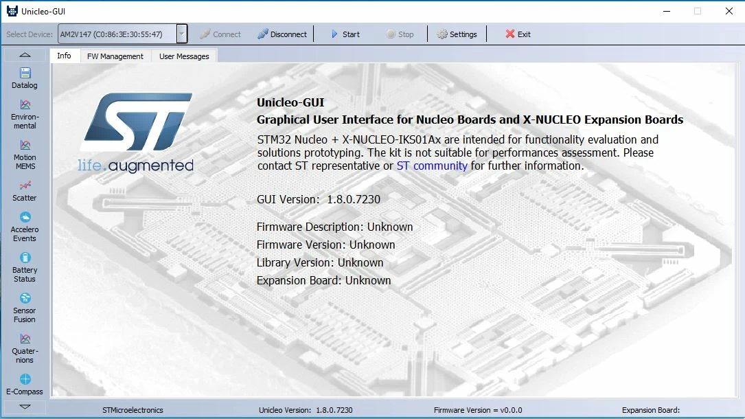

I'm facing with a issue on unicleo gui and sensorTile sensor (with ALLMEMS1 and ALLMEMS2 librairies).
I dont know why, but since few day i can pair and connect my sensor tile with bluetooth on my laptop (W10) but unicleo doesn't show the normal interface with sensor picture and librairies selection.
i try to update my bluetooth driver, update gui to 1.8, uninstal/install all driver and soft but same pb!
Is anybody encountered the same pb, and have a workaround?
For finish, sensorTile work fine with Android STBLE app!
thanks

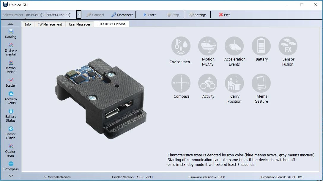

    unfortunately the ALLMEMS2 FW is not yet supported.
    Could you please try again ALLMEMS1 and if it doesn't work send us a screenshot.
    I double checked it now with Unicleo-GUI 1.8.0 and ALLMEMS1 3.4.0 and it works fine for me.
    david binkowski
    June 7, 2019
    Many thanks for your answer!
    So I try with the same setting ALLMEMSV340 and unicleo 1.8, and it work fine!
    Do you know if ALLMEMSV2 will soon be supported or not?
    Thanks
    June 7, 2019
    We will try to add it in the next release in a few weeks.

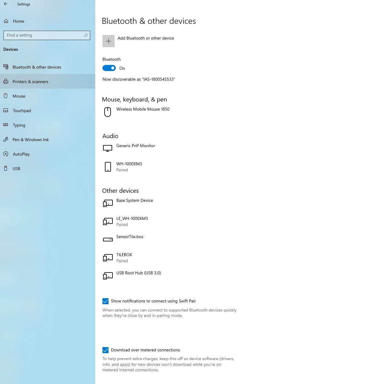

    I have a similar issue. I have just acquired a SensorTile.box (STEVAL-MKSBOX1V1) board and I fail to connect to Unicleo-GUI (runs on Win10). While I am able to pair the device to my Win10 Machine (I can find it in the Paired Bluetooth devices on Win10), the Unicleo-GUI doesn't seem to see it.
    I was able to connect it to my phone and managed to read data from it, but need to switch to the PC. please help

    TILEBOX is there, in the Win10 BLE devices list, but not in the list of Unicleo-GUI

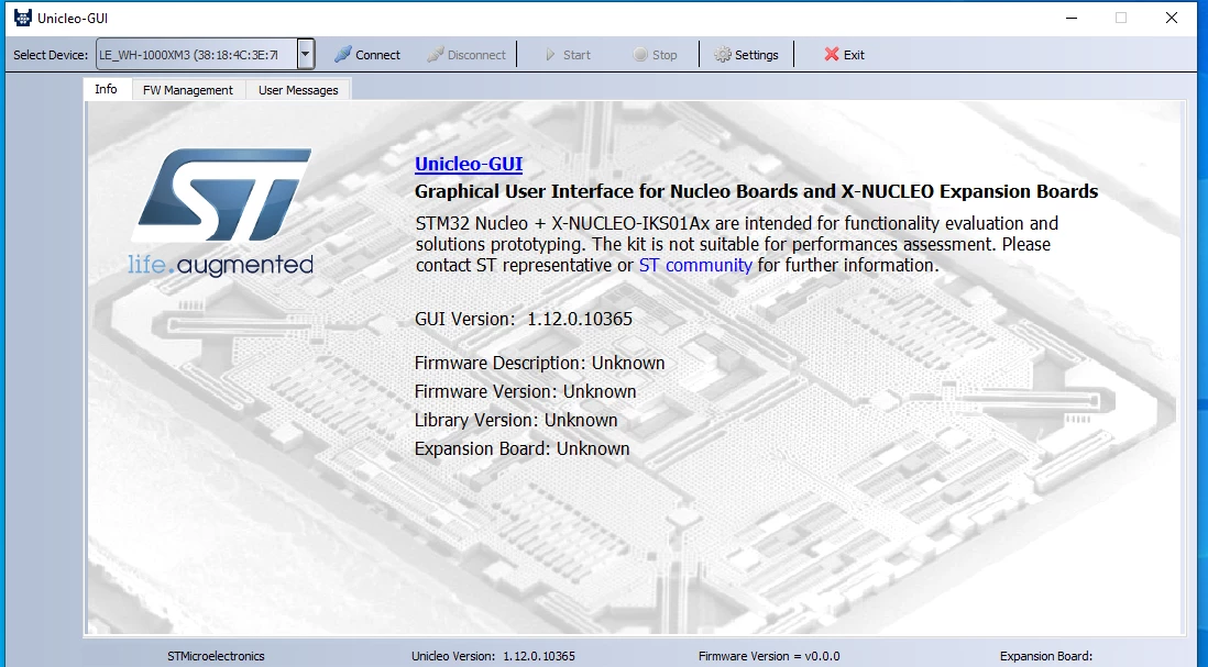

    I can confirm that firmware 3.3.5 works fine with Unicleo-GUI v1.12.0, so it is strange that TILEBOX is not listed. Did you try to expand combo box list to see all items?
    DMari.1
    Visitor II
    May 28, 2020
    The device listed there is the only BLE device Unicle-GUI finds.
