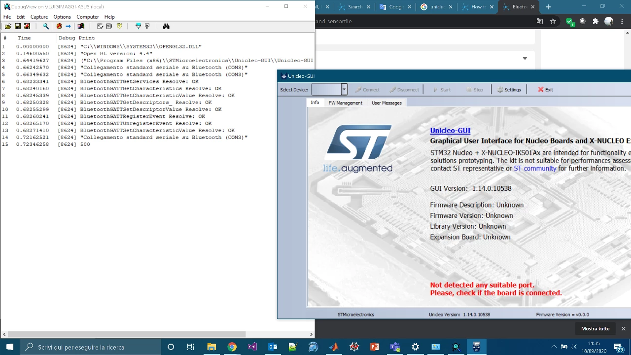

    GAmor.1
    September 18, 2020
    0693W000004GPJGQA4.pngHi louda.marian,
    I have the same problem of DMari.1 (Unicleo-GUI not recognize the evaluation board STEVAL-MKSBOX1V1); in the following, I attach the screenshot of Dbgview output.
    Please help me!
    Thanks a lot,
    Giovanni
    louda.marian
    September 21, 2020
    Hi Giovanni,
    There are two necessary conditions for the device to be displayed in Unicleo. First one, the device must be paired in windows. Second one, the device must contain Generic Access service( if you use any from FWs from ST it should be valid). In your case there are no any error messages in debug output and if you do not see any device it means that no device was found. If you have the device already paired, try to unpair and pair again the device (pin 123456). BLE device list is refreshed only during start of application, so you have to restart the application to see changes. I am not able to repeat the situation that the device is visible in a list of paired devices in windows and is not visible in Unicleo.
    Best Regards,
    Marian
