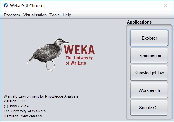

Ø  Launch Weka tool and push the “Explorer” button

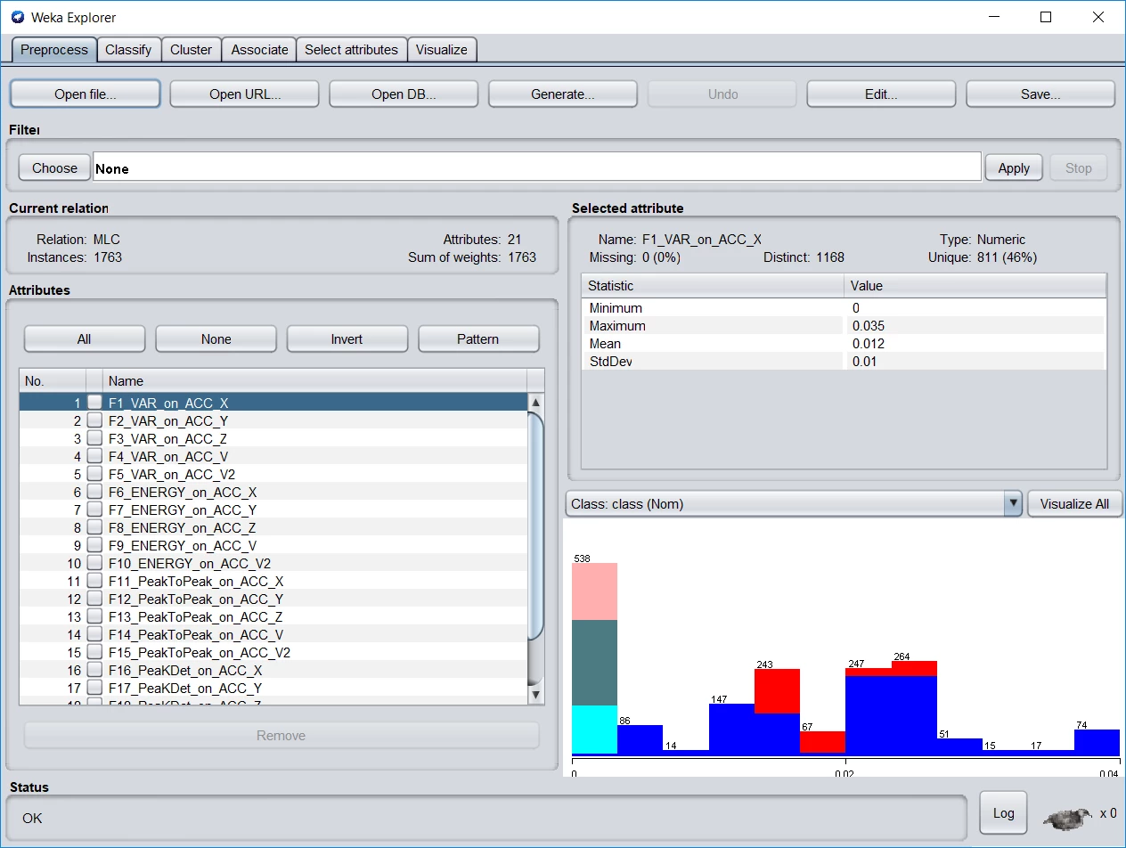

Ø  Load the ARFF file created before by pushing the “Open file…” button in the “Preprocess” panel. Once the file is open you may be able to see all the Attributes (Features and Classes) that we selected with the Unico GUI.

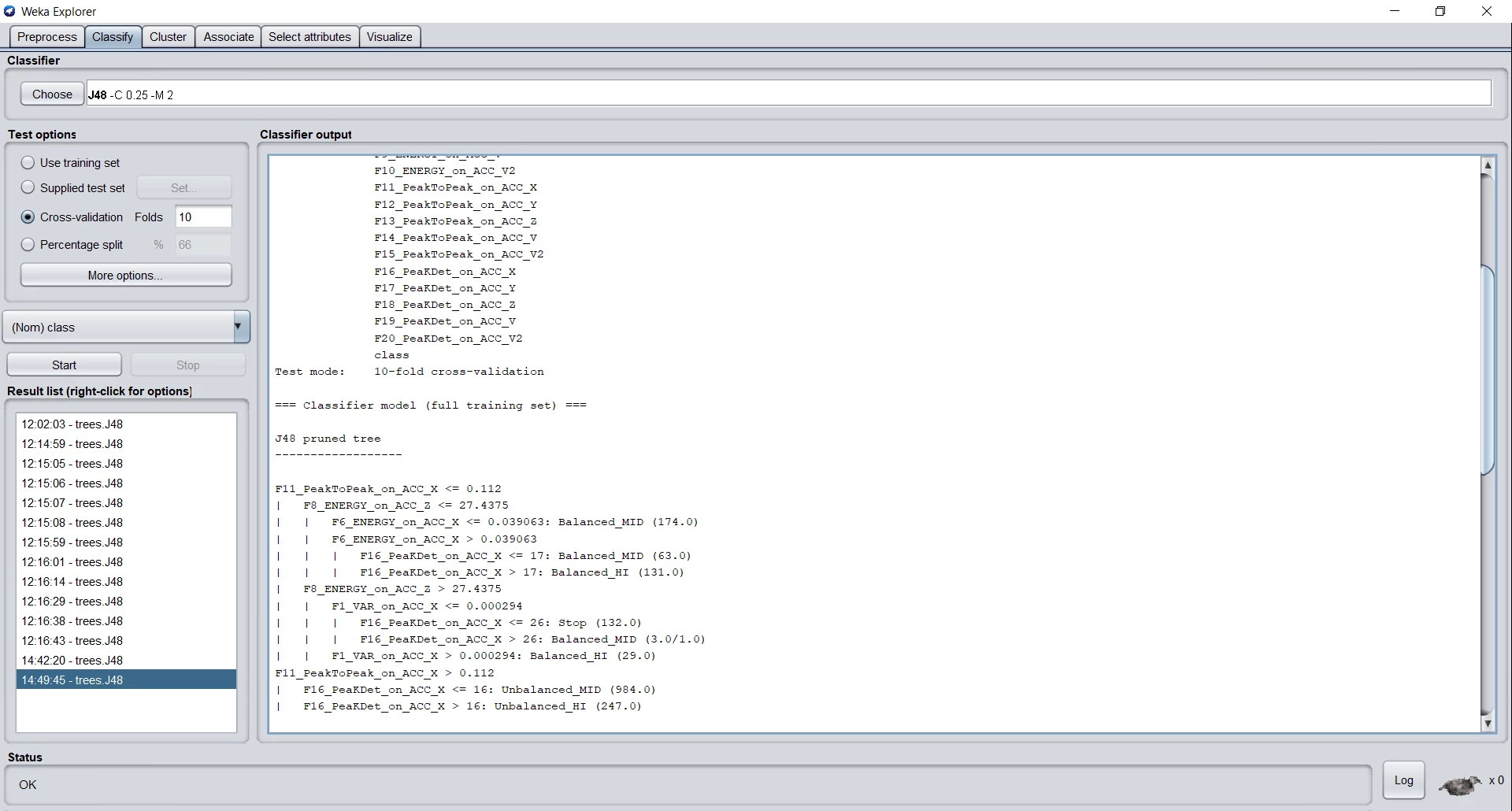

Ø  We can now choose in Weka the desired ML algorithm, in our case the Decision Tree, by selecting “Choose >> trees >> J48”. Then Push the “Start” button.
Ø  Copy and paste the information relative to the Decision Tree model trained by the Weka tool:
J48 pruned tree
F11_PeakToPeak_on_ACC_X <= 0.112
|   F8_ENERGY_on_ACC_Z <= 27.4375
|   |   F6_ENERGY_on_ACC_X <= 0.039063: Balanced_MID (174.0)
|   |   F6_ENERGY_on_ACC_X > 0.039063
|   |   |   F16_PeaKDet_on_ACC_X <= 17: Balanced_MID (63.0)
|   |   |   F16_PeaKDet_on_ACC_X > 17: Balanced_HI (131.0)
|   F8_ENERGY_on_ACC_Z > 27.4375
|   |   F1_VAR_on_ACC_X <= 0.000294
|   |   |   F16_PeaKDet_on_ACC_X <= 26: Stop (132.0)
|   |   |   F16_PeaKDet_on_ACC_X > 26: Balanced_MID (3.0/1.0)
|   |   F1_VAR_on_ACC_X > 0.000294: Balanced_HI (29.0)
F11_PeakToPeak_on_ACC_X > 0.112
|   F16_PeaKDet_on_ACC_X <= 16: Unbalanced_MID (984.0)
|   F16_PeaKDet_on_ACC_X > 16: Unbalanced_HI (247.0)
Number of Leaves  :          8
Size of the tree :           15

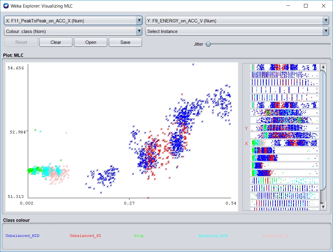

Ø  In the case it’s needed to analyze more in details the dataset used, it’s possible also to visualize in Weka some plots for the values of each Feature relative to the different classes in the “Visualize” panel.

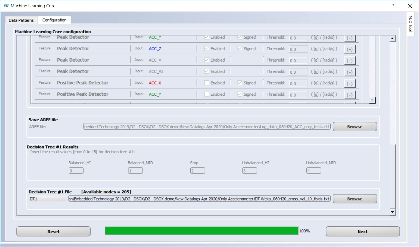

STEP7 - Decision Tree model training on WEKA
We need to come back now to the Unico GUI we left open and load the .txt file with the Decision Tree configuration.
Ø  Click on "Next" and leave default options for the Meta-classifier
Ø  You will be able to save the configuration .ucf file for the LSM6DSOX

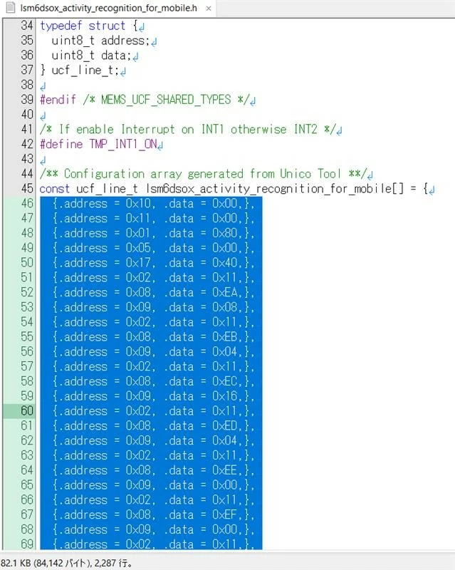

Ø  From the .ucf file copy and paste the table of the LSM6DSOX registers updating the one already present in the file lsm6dsox_activity_recognition_for_mobile.h:
Ac 10 00
Ac 11 00
Ac 01 80
Ac 05 00
Ac 17 40
Ac 02 11
The first column represents the Sensor Register Address and the second column the Value.

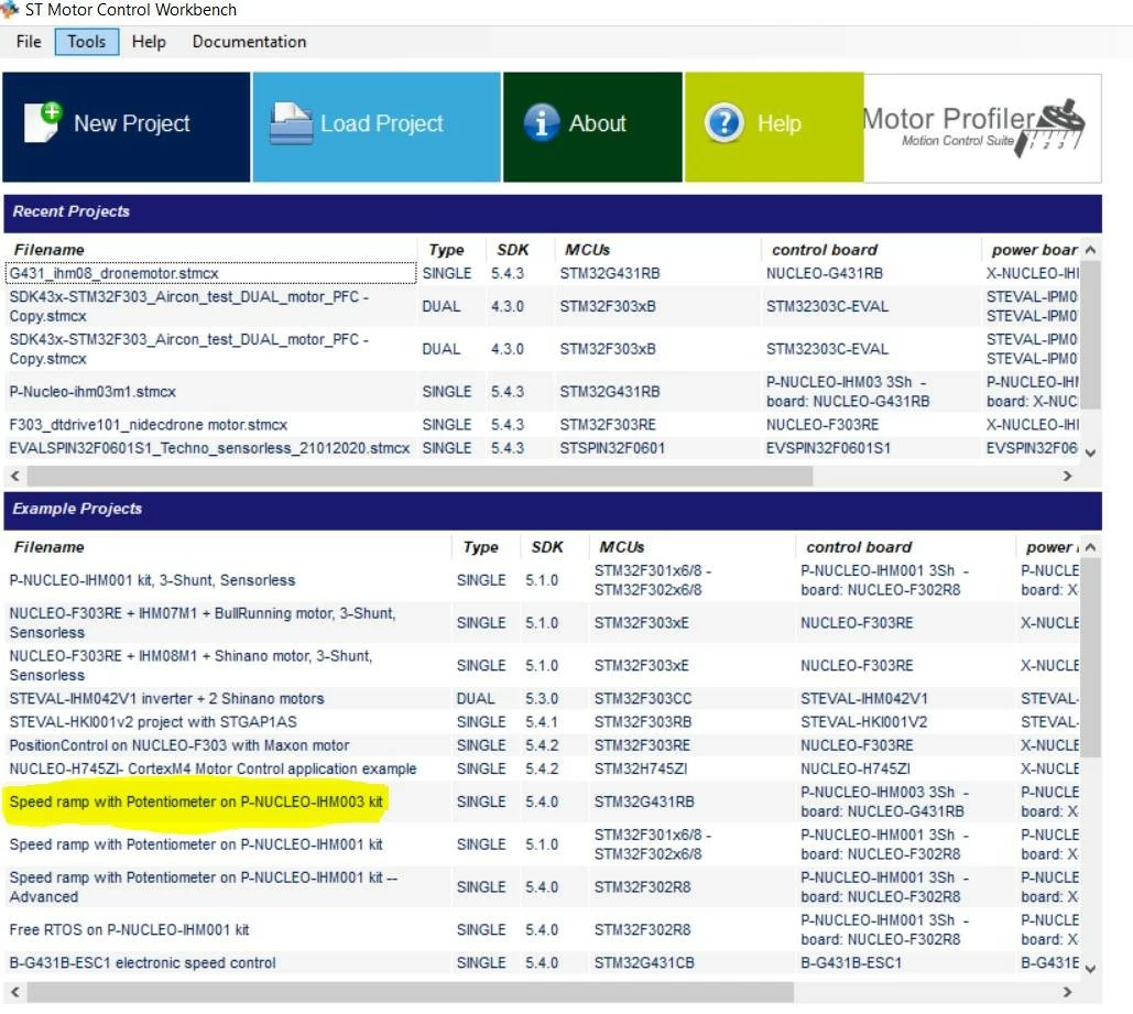

A)      Download Motor Control SDK for STM32 and install the tool:
B)      Load the P-NUCLEO-IHM03 pre-loaded project “Speed ramp with Potentiometer on P-NUCLEO-IHM03 kit” and generate FW project source code for STM32G431:
