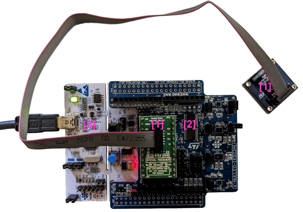

The following hardware components are used:

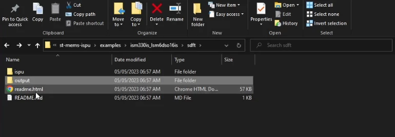

After cloning the repository locally, it can be opened. It contains different folders, among which examples and tutorials. Inside the folder examples, consider the SDFT example folder. The readme file describes that this example implements the sliding discrete Fourier transform (SDFT) algorithm at 26 Hz. The output folder contains the prebuilt files.

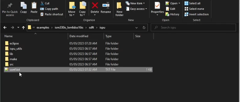

Open the configuration file conf.txt file inside the ISPU folder.

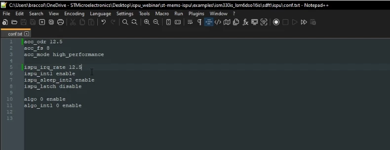

By default, both the accelerometer and the ISPU are configured at 26 Hz. Line 1 is modified setting:
acc_odr 12.5
ispu_irq_rate at 12.5 Hz
After saving and closing the conf.txt file, go back to STM32CubeIDE and build the example ispu_sdft.

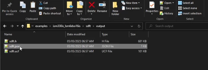

To visualize the results, you can use Unicleo-GUI. For this purpose, you need the JSON file describing the outputs.

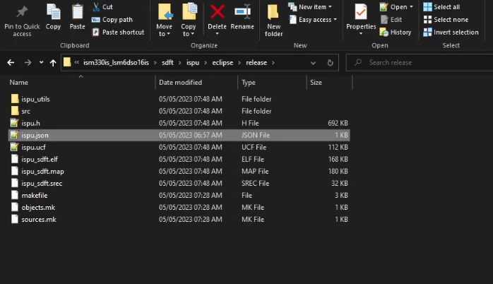

Copy the sdft.json from the example sdft inside the output folder.
Paste the file into the build folder, where the copied sdft.json is renamed as ispu.json

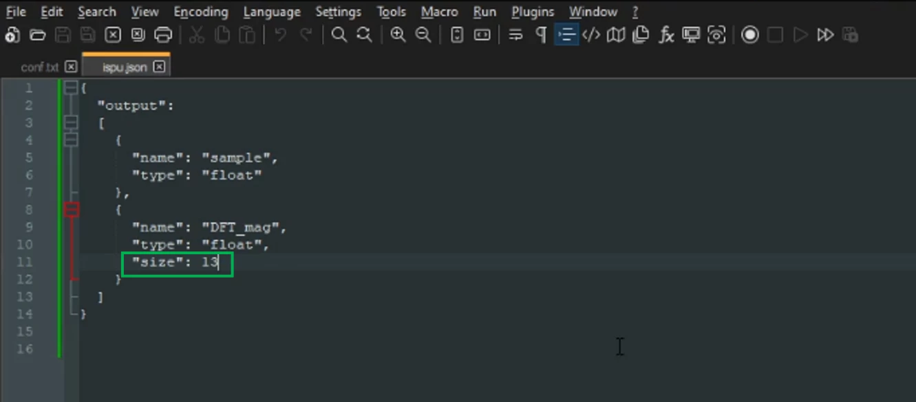

Open the ispu.json file, the size of the array of the DFT magnitude (line 11 of the ispu.json file) is modified by knowing that the length DFT_LEN is calculated by dividing the window length by 2, rounding down and adding 1: ((WIN_LEN / 2u) + 1u) as described at line 25 of file main.c in STM32CubeIDE. In this case, WIN_LEN is 25u, so the “size” (line 11 of the ispu.json file) is set to 13. Save and close the file.

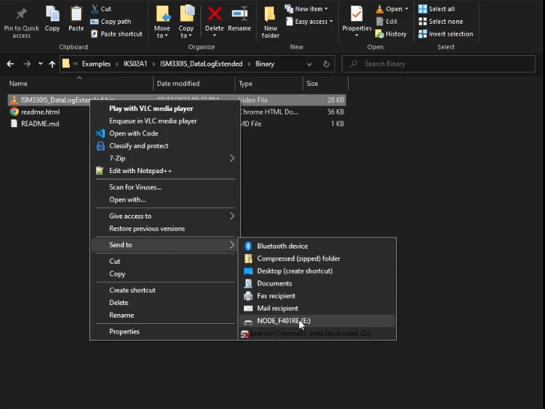

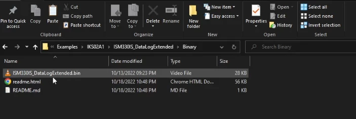

Flash the STM32 Nucleo board with the appropriate firmware. To do so, go back to the x-cube-ispu package into projects folder: select NUCLEO-F401RE, then the expansion board that we are using, X-NUCLEO-IK02A1, and our sensor, ISM330IS. In the binary folder is a prebuilt binary file of the firmware.
You can flash this binary file just by copying it to the STM32 Nucleo board.

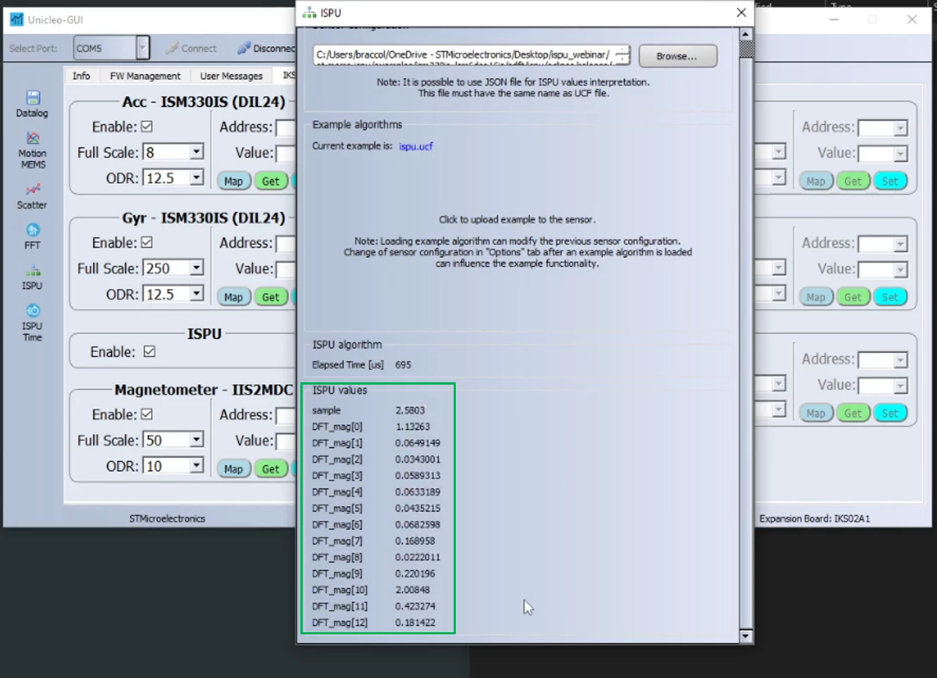

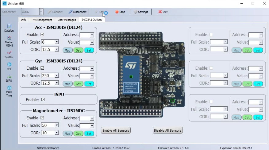

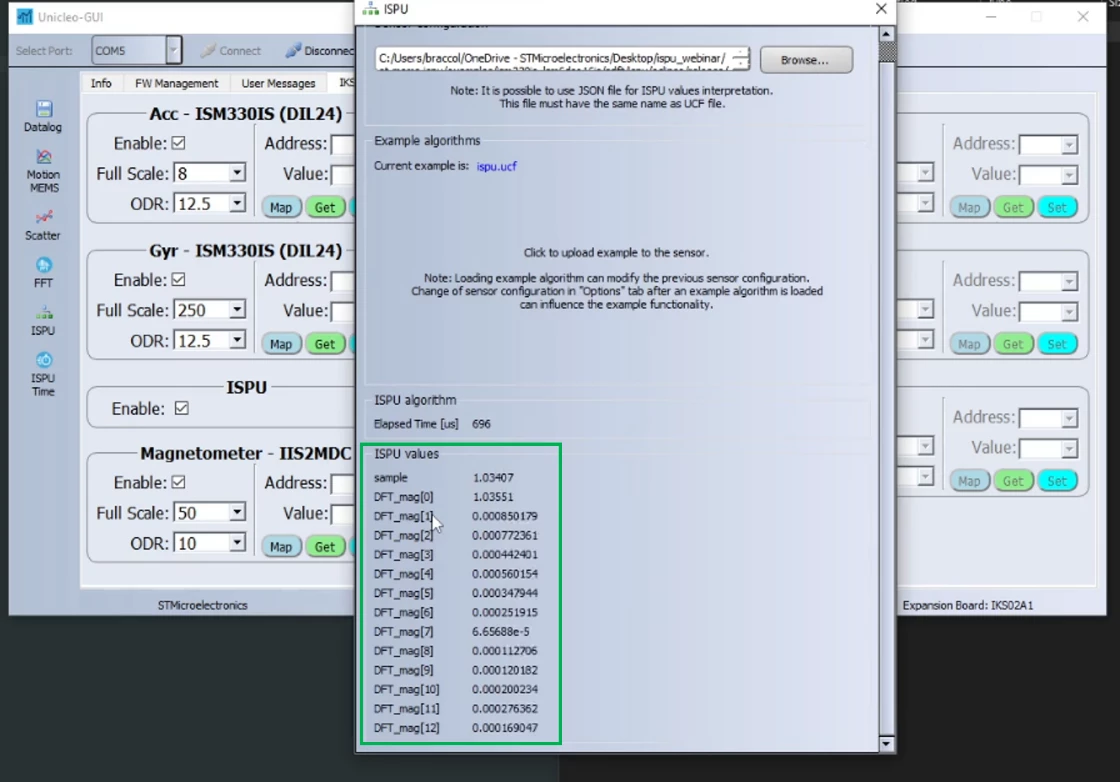

Now that the STM32 Nucleo board is flashed, open the Unicleo-GUI, which automatically connects to the board. Press the start button:

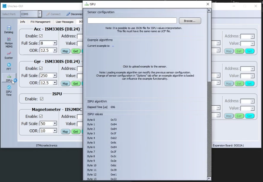

Then navigate to the ISPU tab:

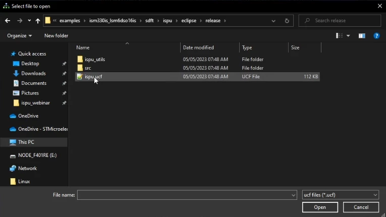

Afterwards, browse for the .ucf file by clicking the browse button, and locate it inside the release folder of the sdft example and load the file.
Now, it is computing the DFT magnitudes at various frequencies; in this particular case the values are close to zero because the device is stationary:
If the board is shaken, some frequency components are appearing:
