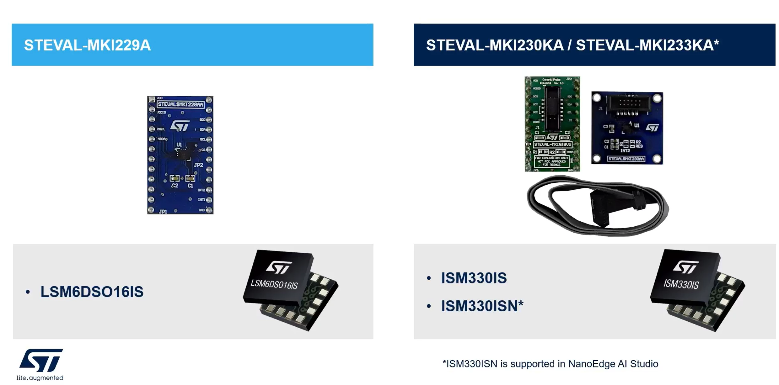

1. Hardware and software prerequisites
ST offers two kinds of sensors with ISPU, one for personal electronics and consumer applications, called LSM6DSO16IS, and the other one for industrial applications, called ISM330IS.
These sensors are also available as DIL24 adapter boards which mount on top of other boards available inside ST ecosystem.
Figure 1: DIL24 adapter boards for MEMS sensors with ISPUFigure 1: DIL24 adapter boards for MEMS sensors with ISPU

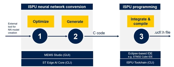

It consists in three programming steps.

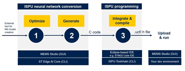

The first programming step consists in creating a neural network model (see step 1 in Figure 3) with an external tool and optimizing it. You can use MEMS-Studio which is a graphical user interface or STEdgeAI-Core which is a command-line interface.
Figure 3: ISPU programming stepsFigure 3: ISPU programming steps
With these software tools, you can convert the neural network into C code for ISPU in the second step (see step 2 in figure 3).
In step 3, the C code must be integrated into a template for ISPU and compiled with an Eclipse-based IDE like STM32CubeIDE or using the ISPU toolchain. Finally, you can get the ISPU configuration.
The generated .ucf or .h file with the configuration can load in MEMS-Studio or in other development environments.

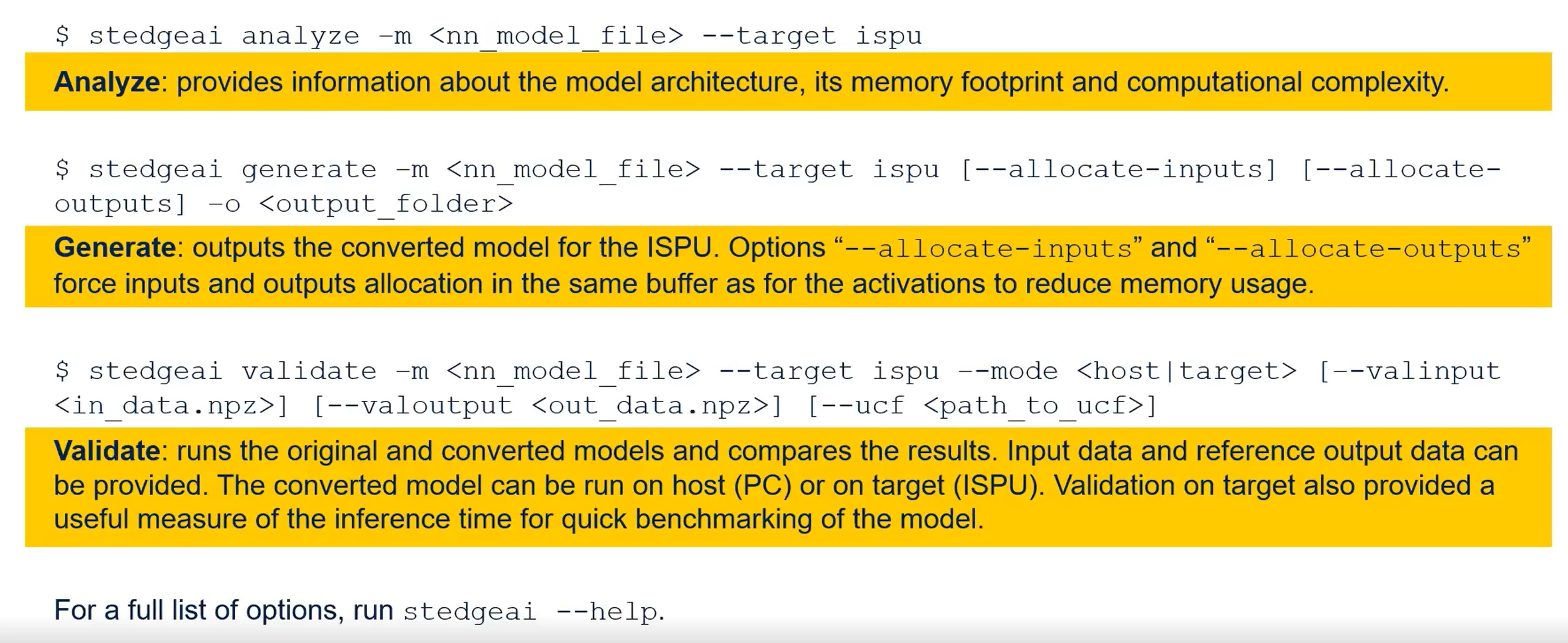

In the STEdgeAI-Core command-line interface, there are three main commands for the ISPU: analyze, generate, and validate. Figure 7 provides further details about these three commands.
Figure 7: ST Edge AI – Commands for ISPUFigure 7: ST Edge AI – Commands for ISPU

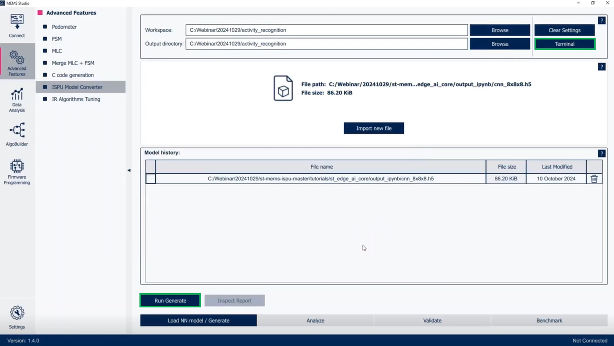

Let’s open MEMS-Studio to import the model in the [ISPU Model Converter] section.
Click the [Run Generate] button to obtain a C-code implementation of the neural network model for the ISPU. You will be able to review the CLI logs by clicking on the [Terminal] button.
Figure 8: MEMS Studio: Load NN model / Generate tabFigure 8: MEMS Studio: Load NN model / Generate tab

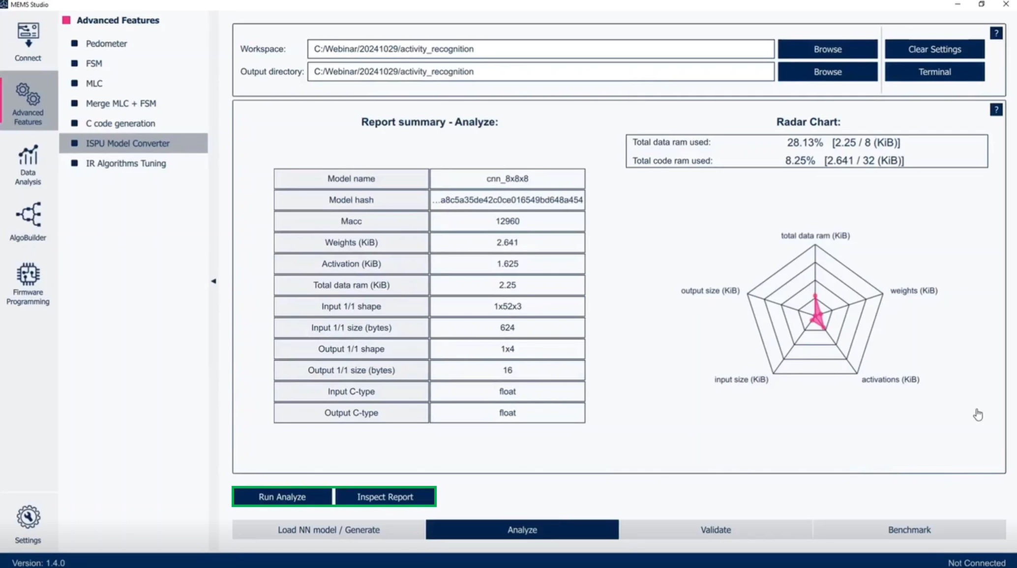

The [Analyze] tab shows information about the model converter. There is a radar chart with a graphical representation of RAM usage, weights, and activation of the processed model.
Clicking on the [Inspect Report] button, you can review the generated report.
Figure 9: MEMS Studio: Analyze tabFigure 9: MEMS Studio: Analyze tab

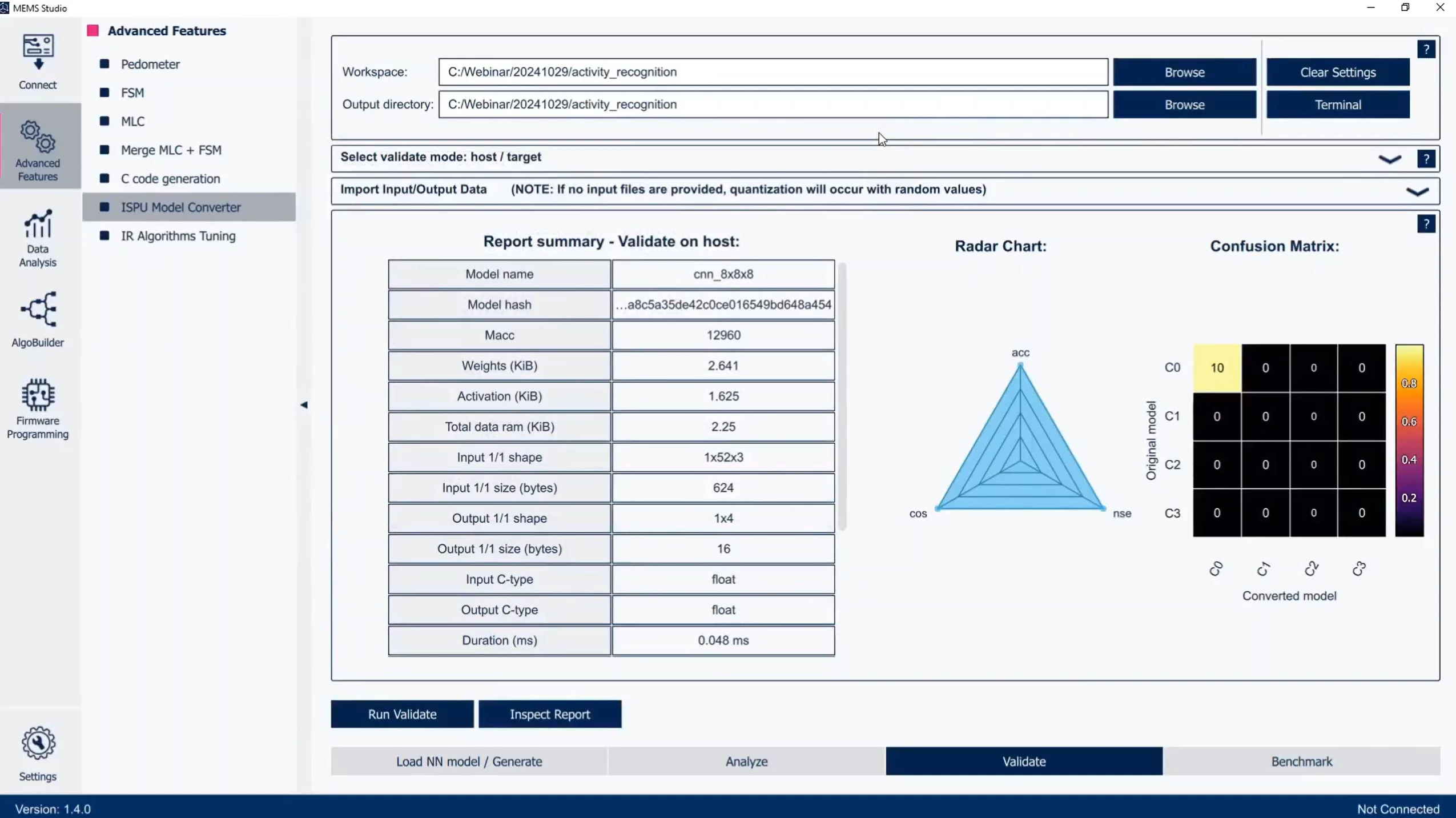

Then you have the Validate tab where you can evaluate the model and review the summary of the validation report through a data table, graphical radar charts, and confusion matrix.
Figure 10: MEMS Studio: Validate tabFigure 10: MEMS Studio: Validate tab
Right now, the board is not connected. If you have the Nucleo board connected to your PC, you can validate the target directly.

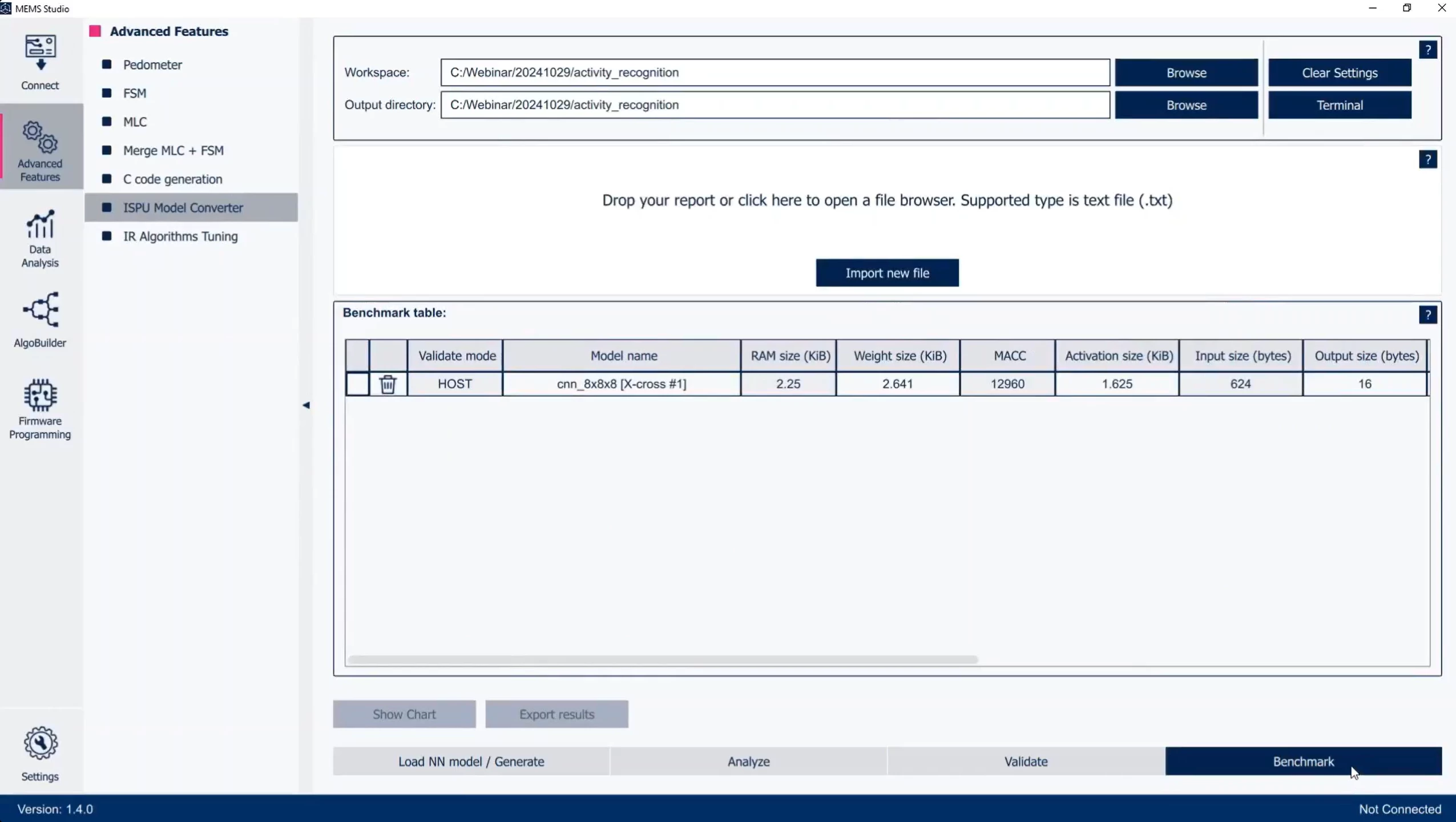

In the last tab, there is a benchmark to compare the performance of the different models generated.
Figure 11: MEMS Studio: Benchmark tabFigure 11: MEMS Studio: Benchmark tab

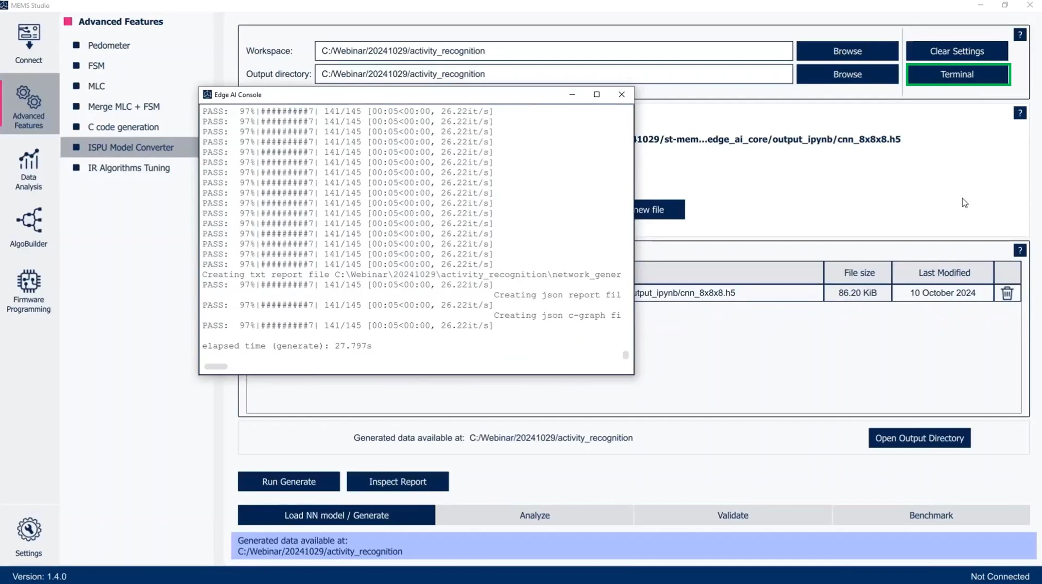

In all the pages of the model converter, you can review the CLI logs by clicking on the [Terminal] button.
Figure 12: MEMS Studio: review the CLI logs by clicking on the Terminal buttonFigure 12: MEMS Studio: review the CLI logs by clicking on the Terminal button

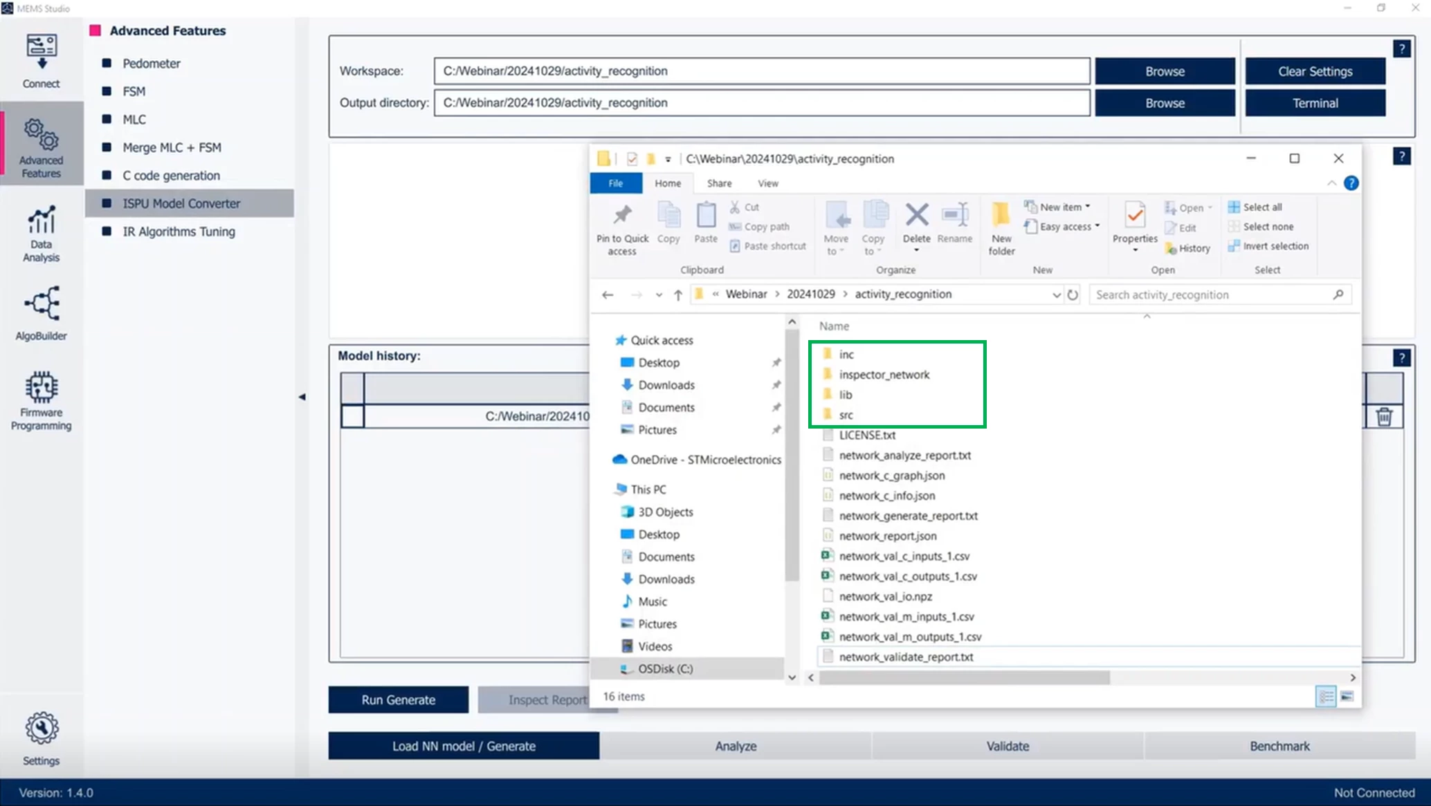

Figure 14 shows the folder where the C code for the ISPU is generated.
There are three subfolders, Inc, Lib and Source, with header files and C code of the neural network.
Figure 14: MEMS Studio: ISPU Model Converter tabFigure 14: MEMS Studio: ISPU Model Converter tab

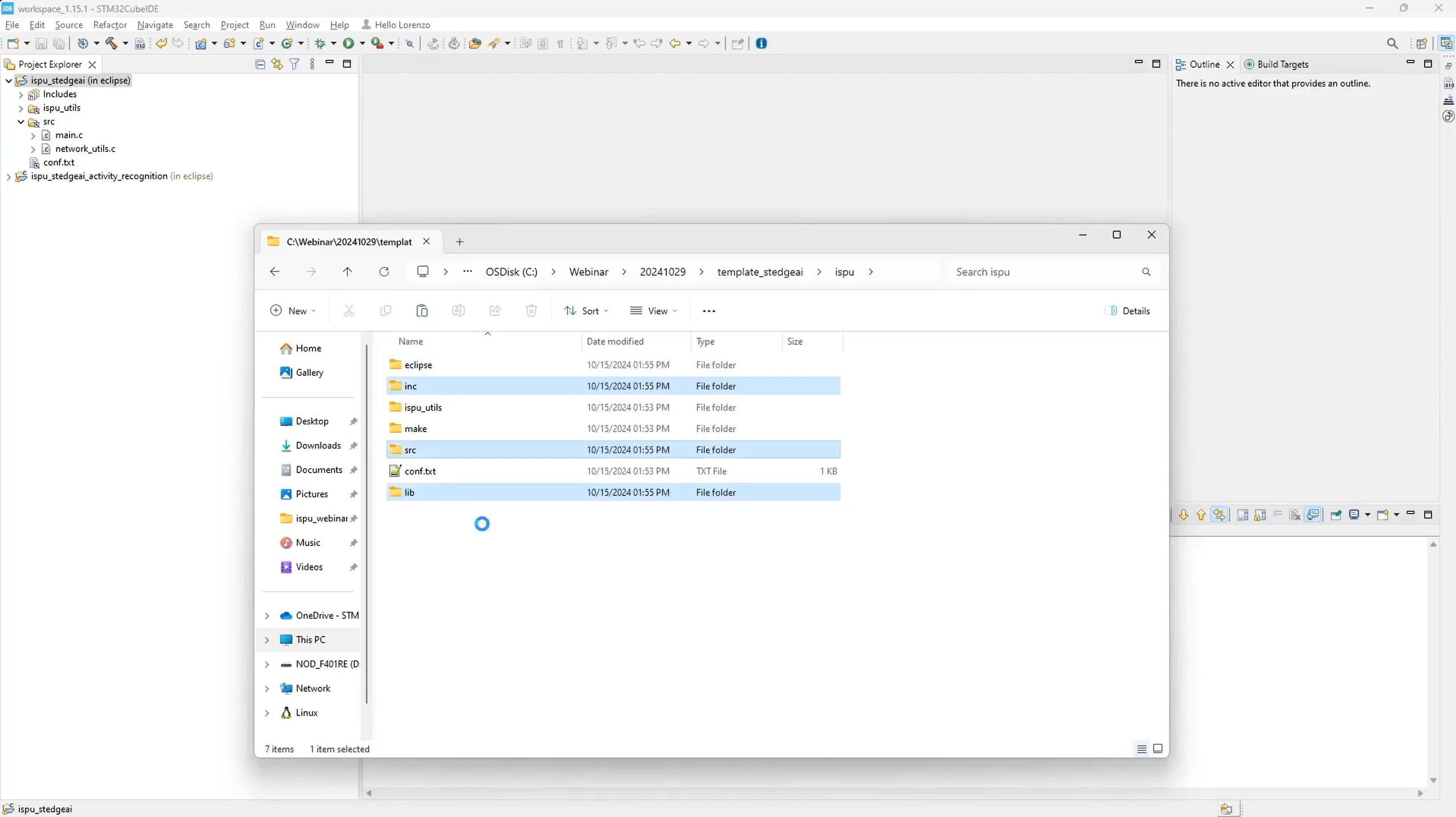

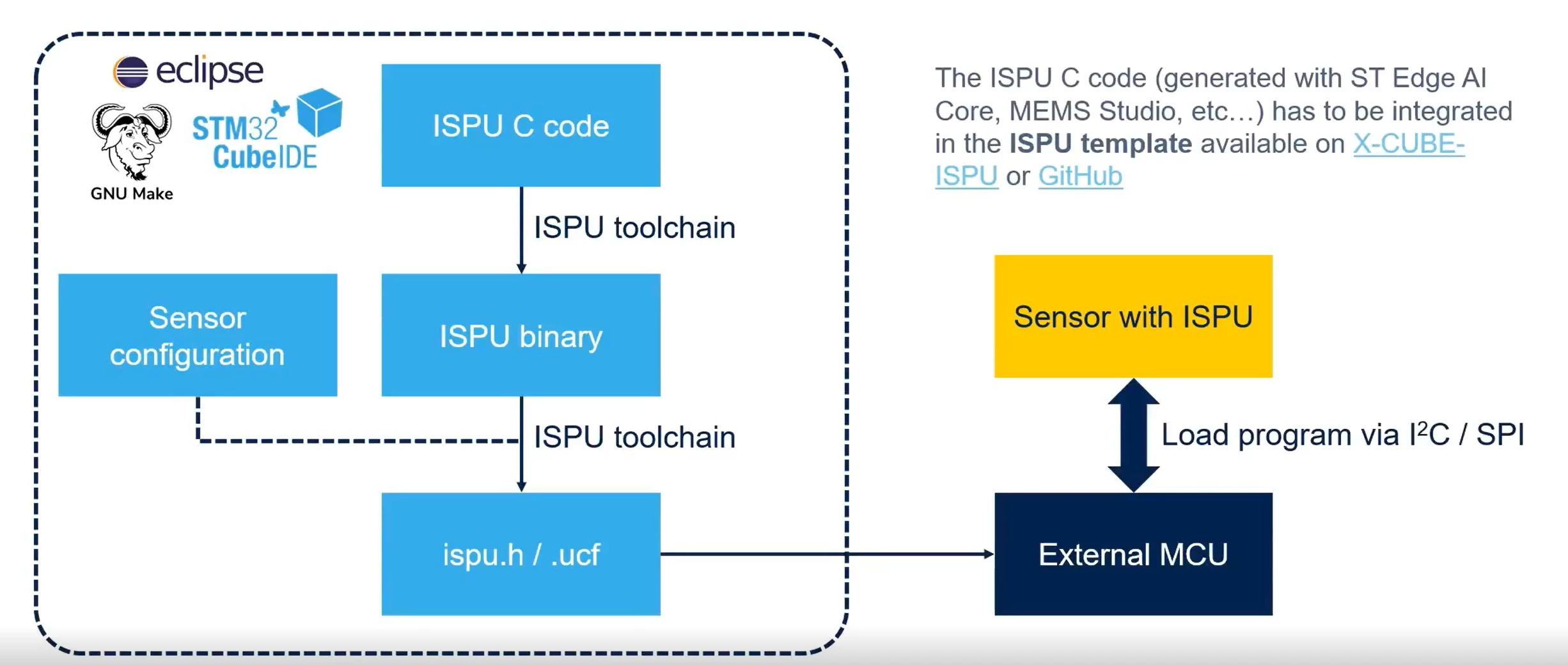

The template to generate the .ucf file is located on the GitHub repository for ISPU or in the X-CUBE-ISPU package.
To generate the .ucf file, you need to integrate the code previously generated by MEMS-Studio and to build the binary file using the ISPU toolchain.
Figure 16: ISPU development flowFigure 16: ISPU development flow
Here are the details about the ISPU toolchain which include the C/C++ compiler to generate the binary and the ispu_gen tool to generate the .ucf and the .h file.
The toolchain is also available as a plug-in for Eclipse based IDEs including STM32CubeIDE.
Figure 17: ISPU ToolchainFigure 17: ISPU Toolchain

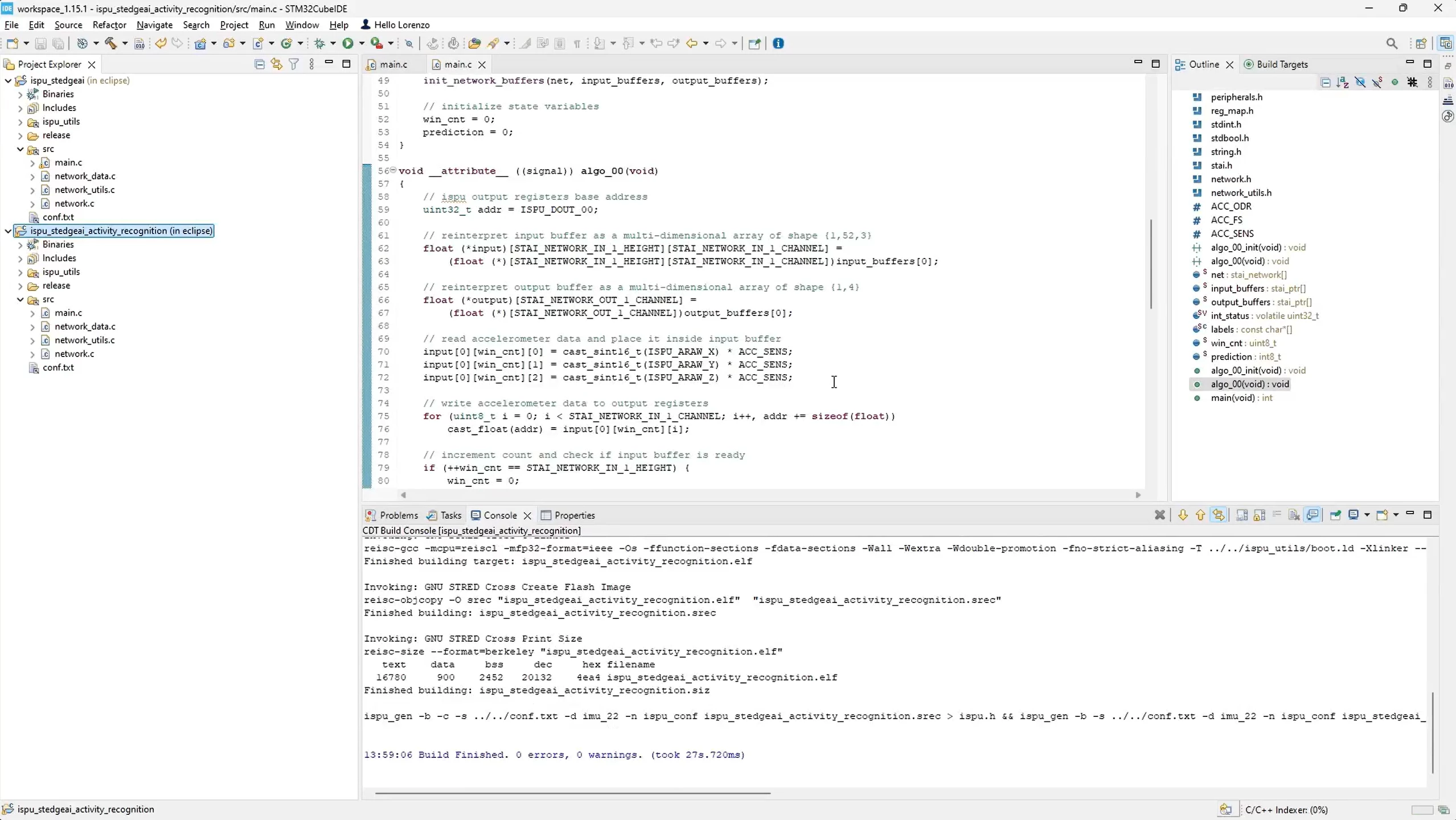

Once you’ve copied these three folders, that is, inc, lib, src, generated by MEMS-Studio in the ISPU template, you can build the project with the STM32CubeIDE.
Figure 18: Copy the three folders, i.e. inc, lib, src, generated by MEMS Studio in the ISPU template before building the project with the STM32CubeIDE.Figure 18: Copy the three folders, i.e. inc, lib, src, generated by MEMS Studio in the ISPU template before building the project with the STM32CubeIDE.
You’ll get some warnings which are fixed by implementing the missing code in the main.c file.
The missing code has the purpose to define the inputs and outputs of the neural network.
You can find details on how to implement this part in the readme file available with the template.
In particular, the code you need to customize has the following purpose:
  • To reinterpret the input and output buffers as array of the expected shape for the neural network
  • To insert accelerometer data in the input buffer
  • To define when to run the network, for instance every 52 sample in this case
  • To assign the output as the most probable result
Figure 19: Rebuilding the project in STM32CubeIDE to get the configuration file (.ucf file) for the ISPUFigure 19: Rebuilding the project in STM32CubeIDE to get the configuration file (.ucf file) for the ISPU
When you have done all these modifications to the code, you can rebuild the project and get the configuration for the ISPU in term of the .ucf file.

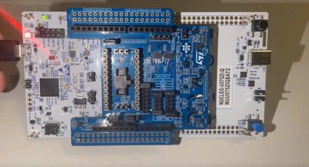

When you have the configuration file for ISPU, you can test it through some evaluation or development board.
For example, let us mount the X-NUCLEO-IKS4A1 expansion on top of NUCLEO-U575ZI-Q, as shown in Figure 20.
In this case, you have not mounted any DIL24 adapter on top of the expansion board because the X-NUCLEO-IKS4A1 already contains the LSM6DSO16IS sensor with ISPU.
In the X-CUBE-ISPU package, you can find the software to use with not only these boards, but also other boards. In fact, X-CUBE-ISPU is an expansion package for ISPU development containing documentation examples and STM32 firmware for enabling communication with the MEMS-Studio.
Figure 20: X-NUCLEO-IKS4A1 expansion mounted on top of NUCLEO-U575ZI-QFigure 20: X-NUCLEO-IKS4A1 expansion mounted on top of NUCLEO-U575ZI-Q

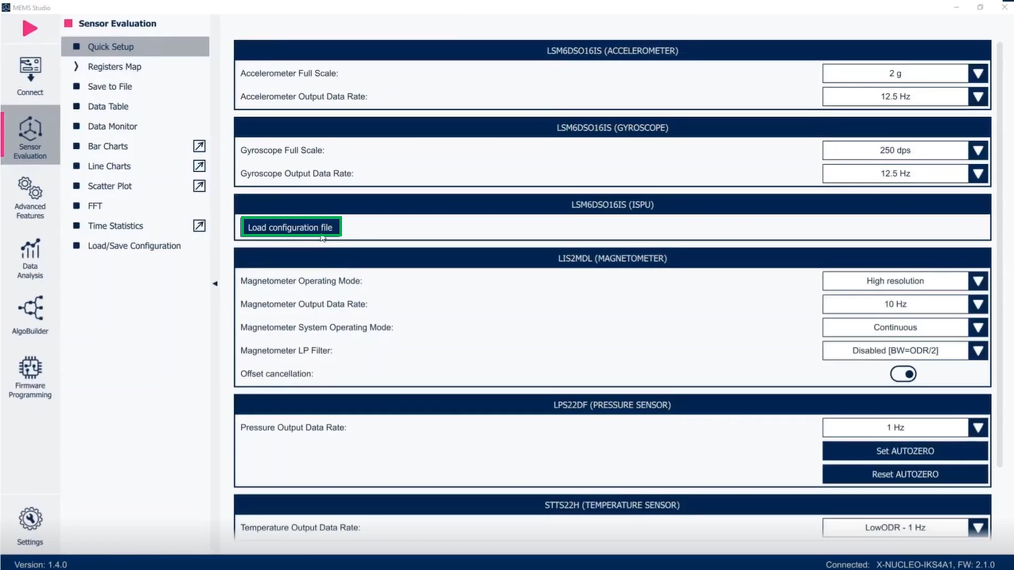

After that, open MEMS-Studio and connect it to the Nucleo board. Select LSM6DSO16IS as a sensor with ISPU, then load the configuration file previously generated by STM32CubeIDE by pressing on the [Load configuration file] button (see Figure 21).
Figure 21: MEMS Studio: Load configuration fileFigure 21: MEMS Studio: Load configuration file

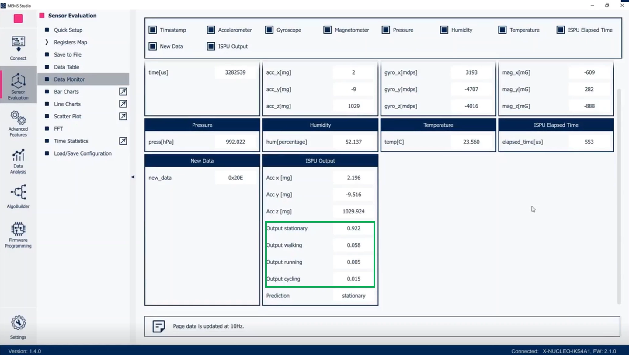

And finally test the application including the ISPU configuration with MEMS-Studio.
This example is an activity recognition, so you can see the outputs stationary, working, running, and so on, as shown in Figure 22.
Figure 22: MEMS Studio: Data Monitoring of ISPU outputFigure 22: MEMS Studio: Data Monitoring of ISPU output
