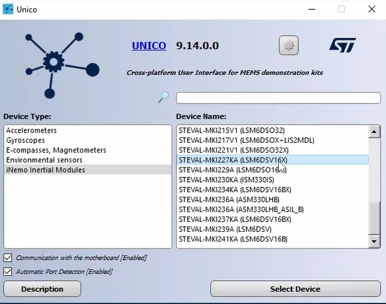

After opening Unico-GUI, select the device LSM6DSV16X with its adapter board, the STEVAL-MKI227KA.
Unico-GUIUnico-GUI

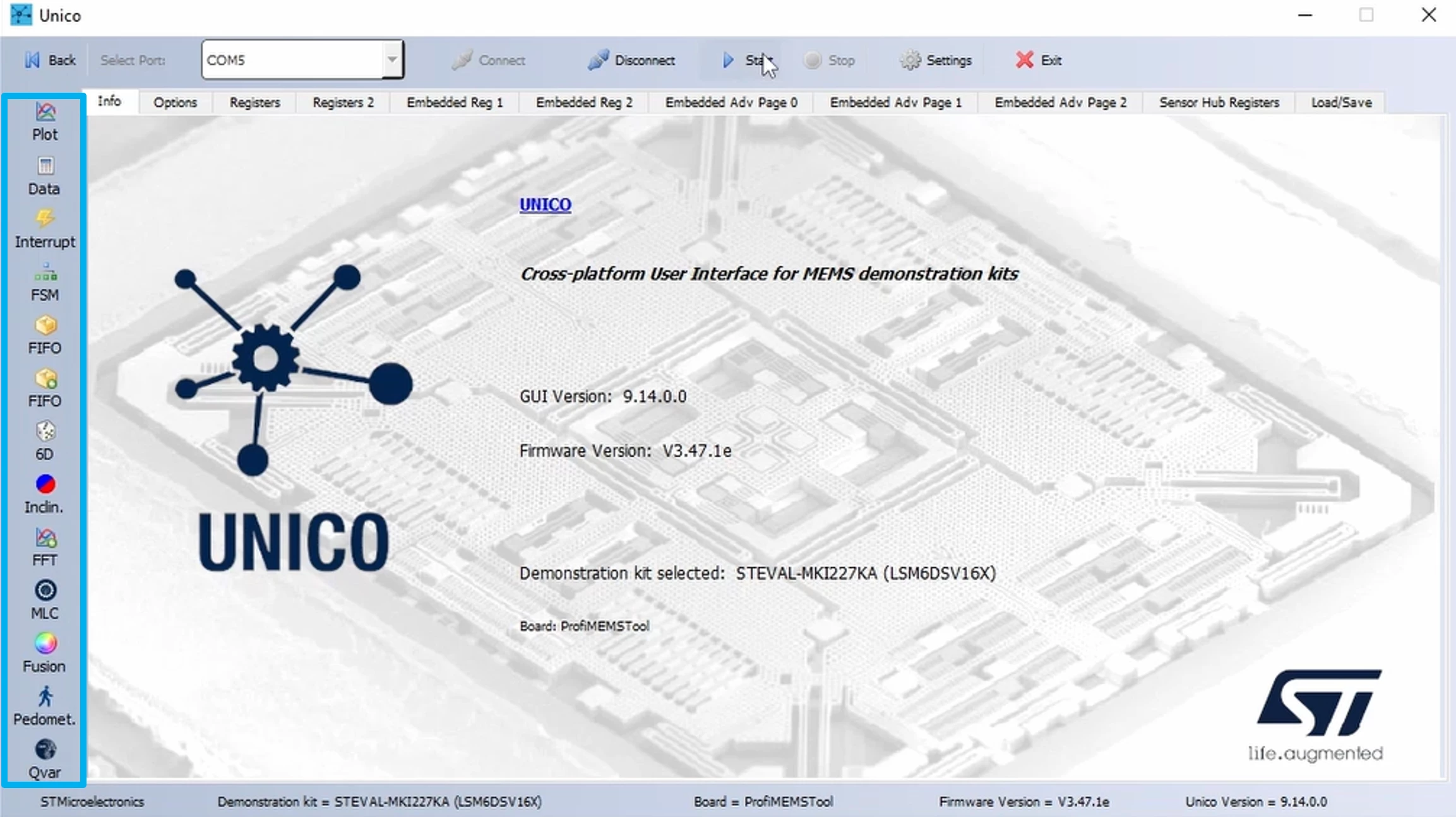

When pressing the “Select Device” button, it is possible to see on the left-hand side all edge functionalities of the device: FSM, MLC, pedometer, sensor fusion, Qvar.
Unico-GUI menu: explore all edge functionalities of the deviceUnico-GUI menu: explore all edge functionalities of the device

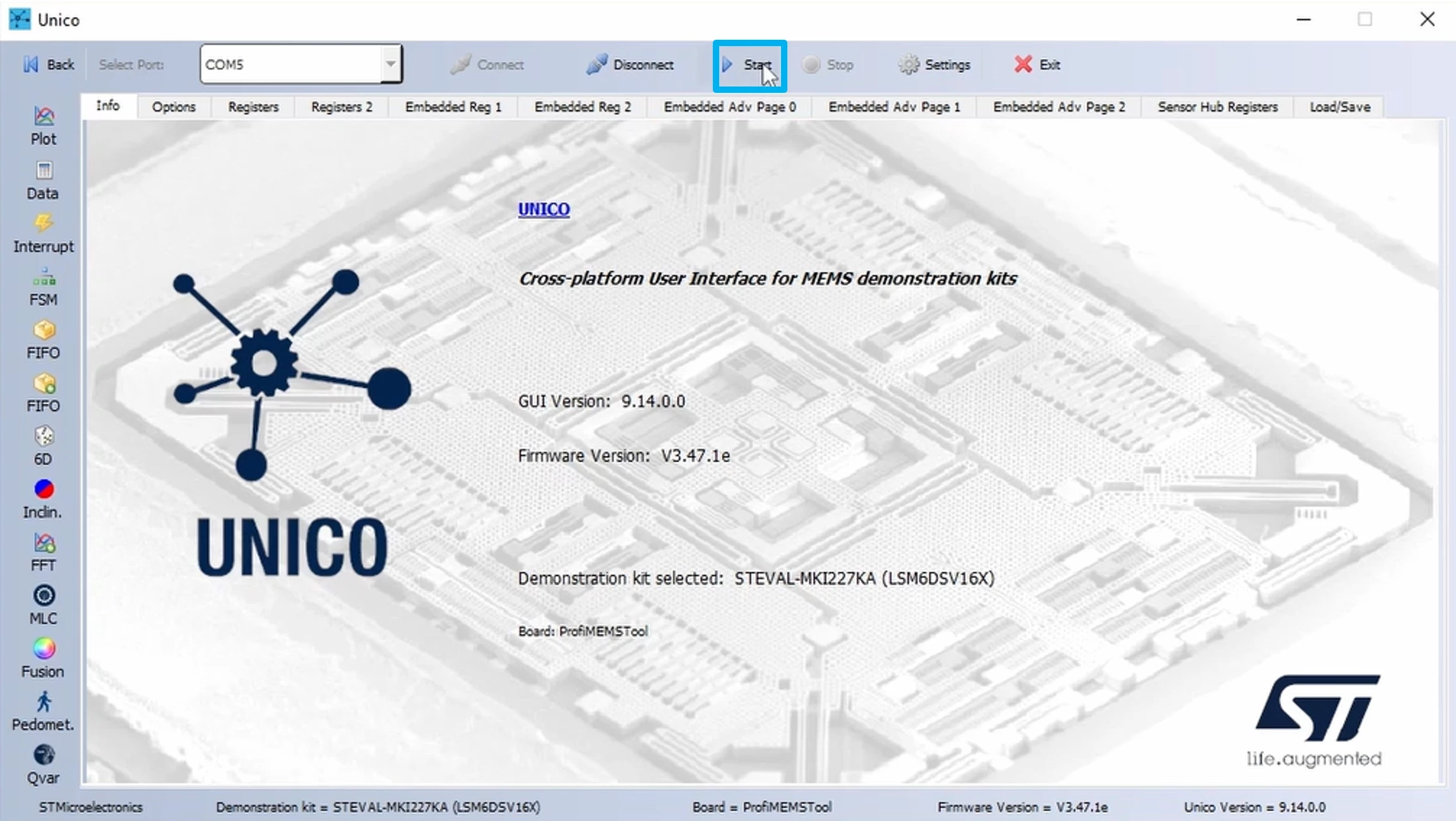

Clicking on the Start button on the top bar we are enabling communication between the STEVAL-MKI109V3 with the STEVAL-MKI227KA and our PC.
Unico-GUI: Start buttonUnico-GUI: Start button

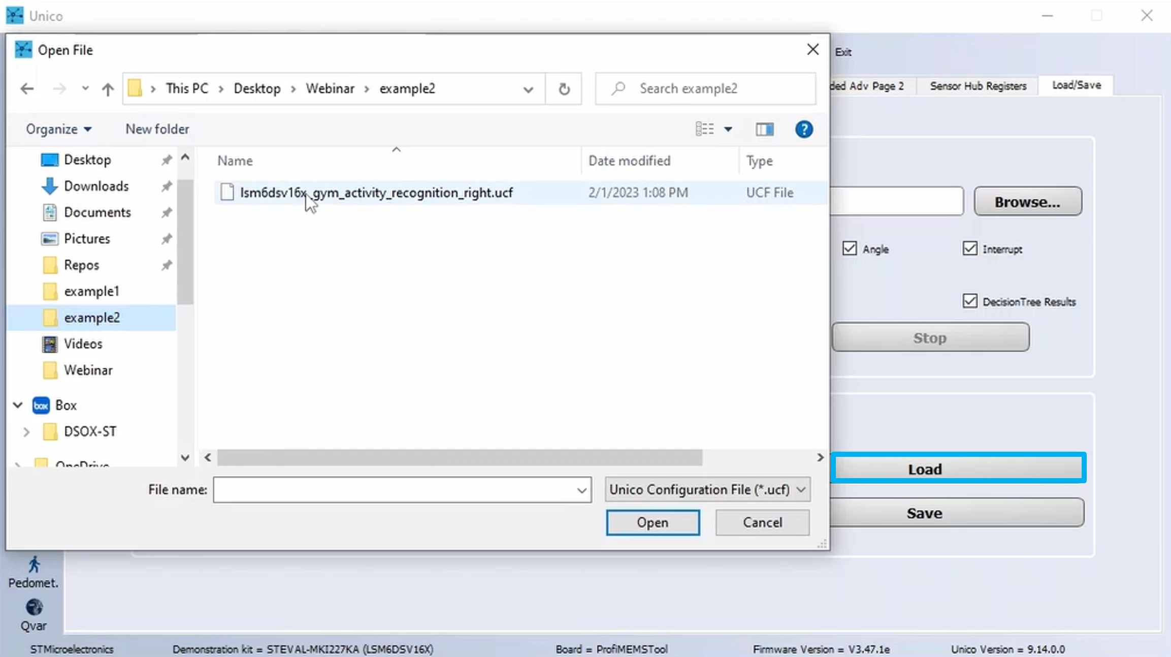

Select the Load/Save tab. Click on the load button and select the downloaded .ucf file. In this example, we are using this file.
Unico-GUI: Click on the load button and select the downloaded .ucf fileUnico-GUI: Click on the load button and select the downloaded .ucf file

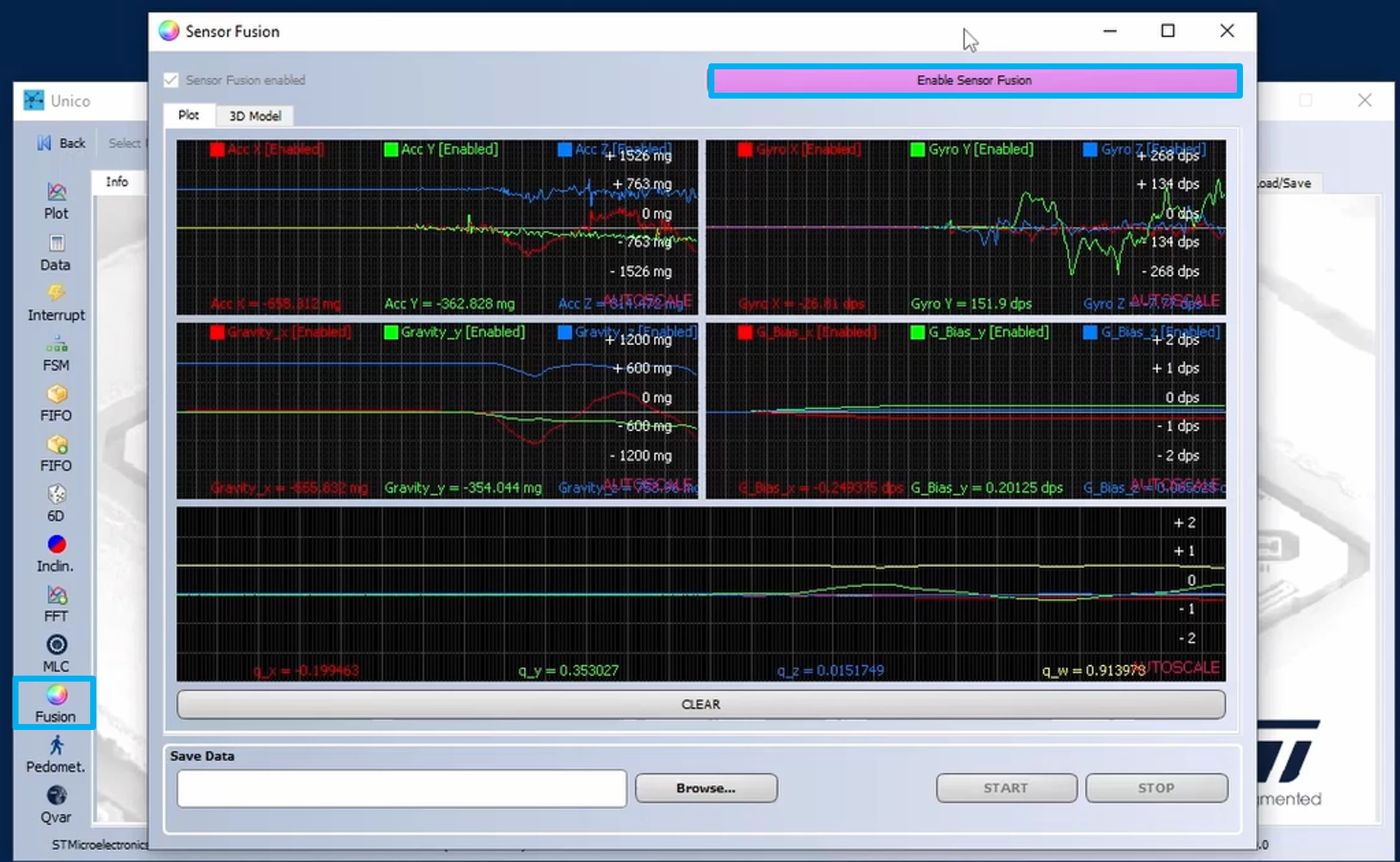

Now, click on the Sensor Fusion tool and then on the “Enable Sensor Fusion” button.
Unico-GUI: Enable Sensor FusionUnico-GUI: Enable Sensor Fusion
Data coming from the sensor in real time are now streaming and it is possible to see many graphs.
We can see the accelerometer plot (in the upper left side) and the gyroscope raw data plot (in the upper right side).
The gravity vector and the gyroscope bias are plotted in the middle:
  • The plot on the left side represents the gravity projection along the 3-axes of the device: it is computed by fusing the accelerometer and gyroscope data. This generates an acceleration signal that is not affected by linear accelerations, which is a mandatory requirement in tracking applications.
  • The plot on the right side shows the computed gyroscope bias, which is subtracted by the gyroscope signal to avoid gyroscope drift in time.
The quaternion data is displayed at the bottom. Data can be converted in the roll, pitch, and yaw angles representing the absolute orientation of the device in space.

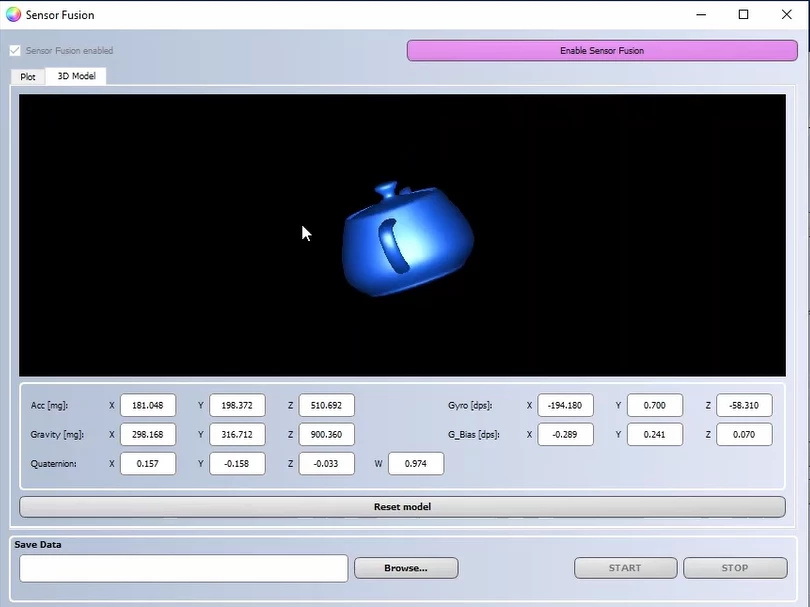

By clicking on the 3D model tab, it is possible to see a teapot moving in real-time.
Unico-GUI: Sensor Fusion - 3D modelUnico-GUI: Sensor Fusion - 3D model

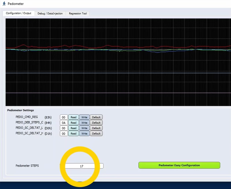

Finally, enable the pedometer 2.0 by setting the PEDO_EN bit available in the EMB_FUNC_EN_A register. To do that, go to the "Embedded Reg 1" tab and manually write the value 0A in register 04. The pedometer counts the steps very precisely.
Unico-GUI: PedometerUnico-GUI: Pedometer

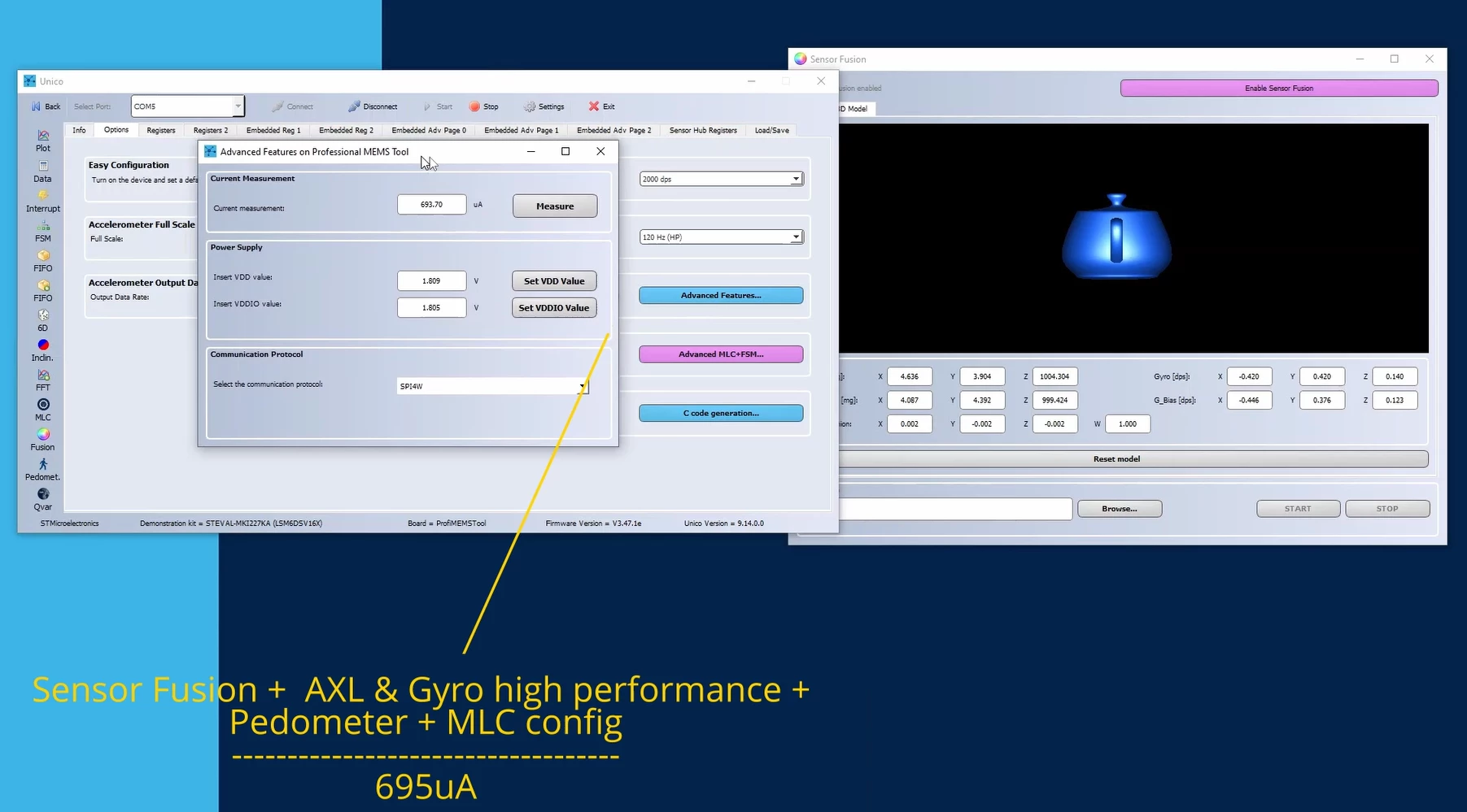

The current power consumption of this configuration is around 700 µA.
Current power consumption of this specific configurationCurrent power consumption of this specific configuration

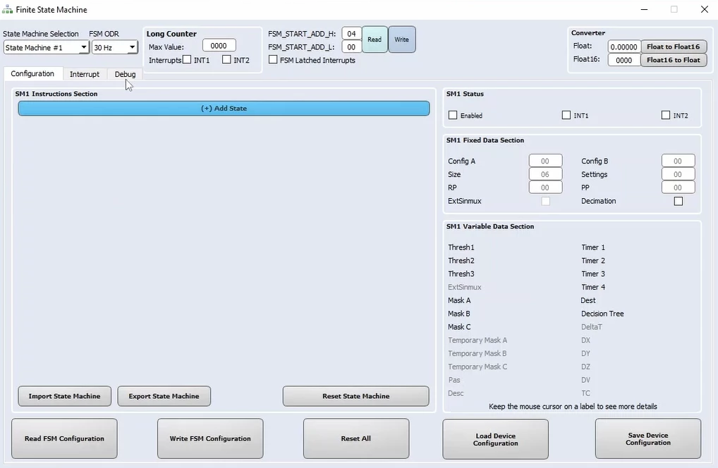

After clicking on the FSM button, the FSM screen will open:
Unico-GUI: FSM windowUnico-GUI: FSM window
The first step is to align the FSM ODR to the sensors ODR, which is 120 Hz.
The FSM ODR is aligned to the sensors ODR (120 Hz)The FSM ODR is aligned to the sensors ODR (120 Hz)

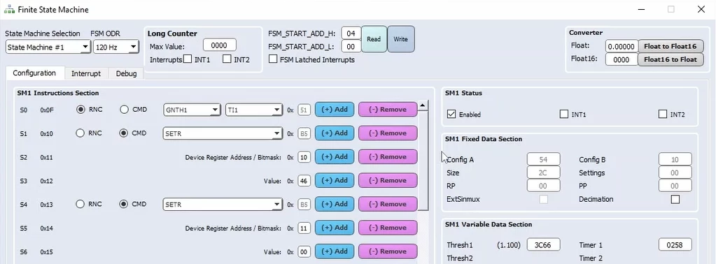

Now, we can start building the program. Since the device starts in a wake state, where the accelerometer and gyroscopes are in high-performance mode, we need the device to enter in a sleep state. This means that only the accelerometer is kept on in low-power mode. The sleep state is enabled when the device is kept stationary for a while, for example 5 seconds.
To enter the sleep state, the first instruction of the FSM is a GNTH1 | TI1 condition. The configured threshold is 1.1 g applied on the accelerometer norm signal. The timer is 600 samples (which means 5 seconds at 120 Hz). Refer to the application note AN5882 to get more details about the FSM conditions.

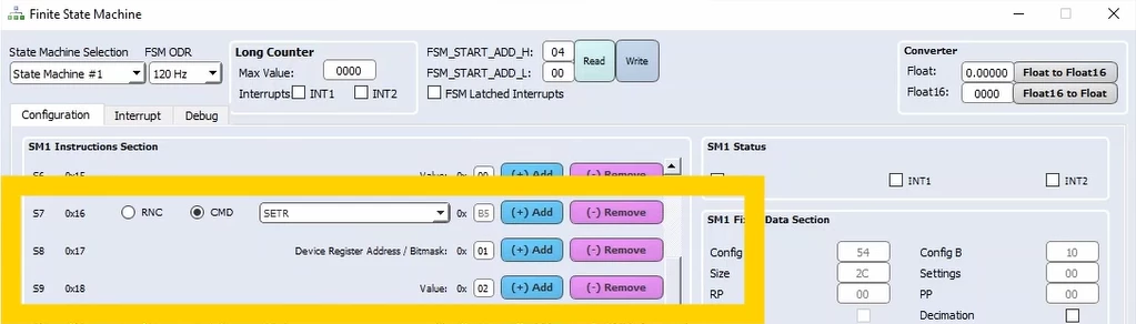

The next instruction will be reached when the device is stationary for 5 seconds. When it happens, we want to turn off the gyroscope and to set the accelerometer in low-power mode. For this purpose, two consecutive SETR commands are issued, one for changing the accelerometer power mode, and one for turning off the gyroscope.
Unico-GUI: FSM - two SETR commands to change the accelerometer power mode and to turn off the gyroscopeUnico-GUI: FSM - two SETR commands to change the accelerometer power mode and to turn off the gyroscope

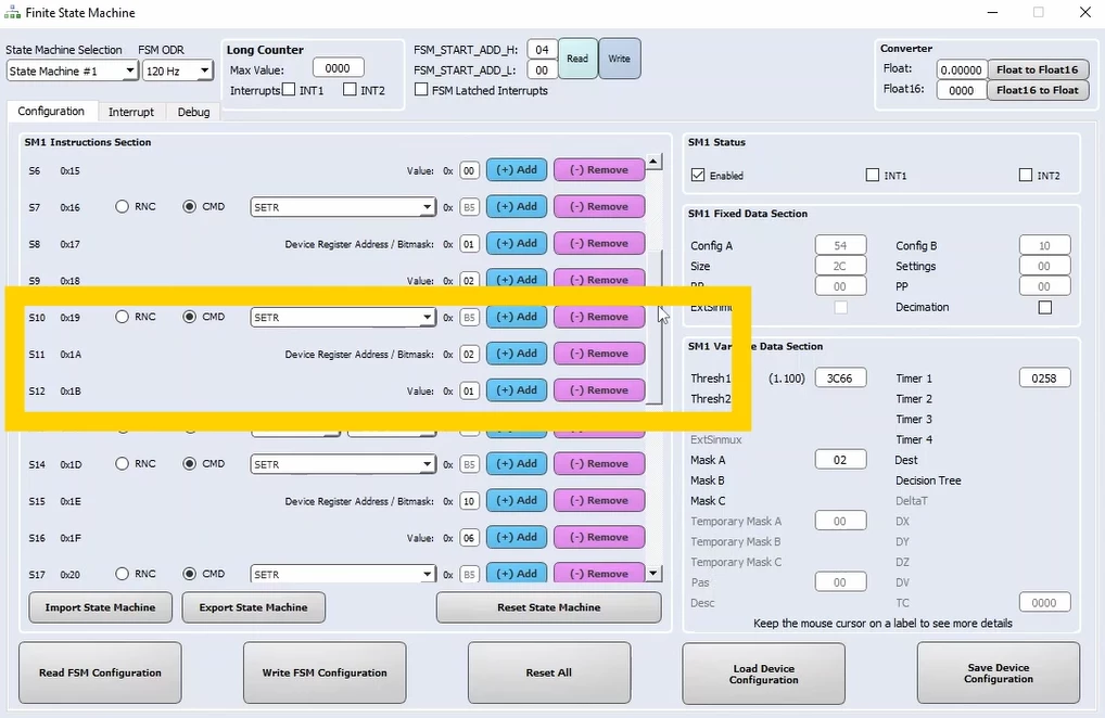

A SETR command is used to disable the pedometer 2.0 during the stationarity. The SETR command in this case takes as first argument the byte 01, which means register embedded function enable A. As the second argument, the byte 02, which means that the pedometer 2.0 is disabled while the SFLP is kept on.
Unico-GUI: FSM - SETR command to disable the pedometer 2.0 during the stationarityUnico-GUI: FSM - SETR command to disable the pedometer 2.0 during the stationarity

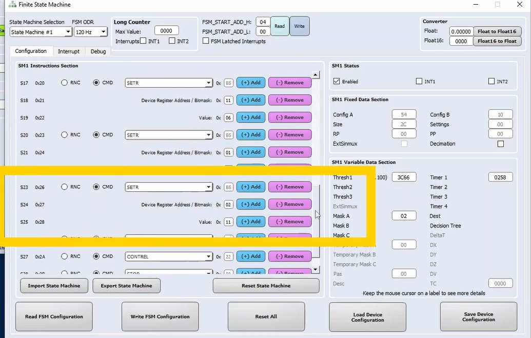

 A SETR command is used to disable the MLC during the stationarity. In this case the SETR command takes as the first argument the byte 02, which means register embedded function enable B. As the second argument is the byte 01, which means that the MLC is disabled while the FSM is kept on.
Unico-GUI: FSM - SETR command to disable the MLC during the stationarity.Unico-GUI: FSM - SETR command to disable the MLC during the stationarity.

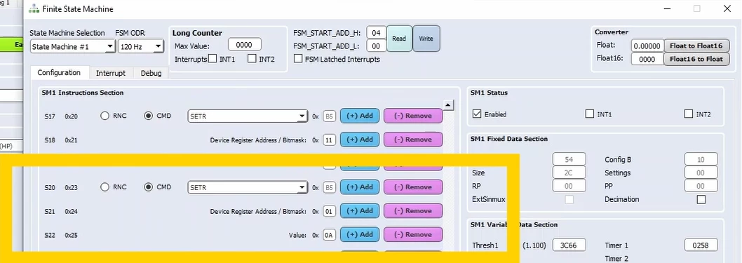

A SETR command is used to enable the pedometer 2.0 after the smart wake up is detected. In this case, the SETR command takes as first argument the byte 01, which means register embedded function enable A. As the second argument is the byte 0A, which means that the pedometer 2.0 is enabled together with the SFLP.
Unico-GUI: FSM - a SETR command to enable the pedometer 2.0 after the smart wake up is detectedUnico-GUI: FSM - a SETR command to enable the pedometer 2.0 after the smart wake up is detected
 A SETR command is used to enable the MLC after the smart wake up is detected. In this case, the SETR command takes as first argument the byte 02, which means register embedded function enable B. As the second argument is the byte 11, which means that the MLC is enabled together with the FSM.
Unico-GUI: FSM - SETR command to enable the MLC after the smart wake up is detectedUnico-GUI: FSM - SETR command to enable the MLC after the smart wake up is detected

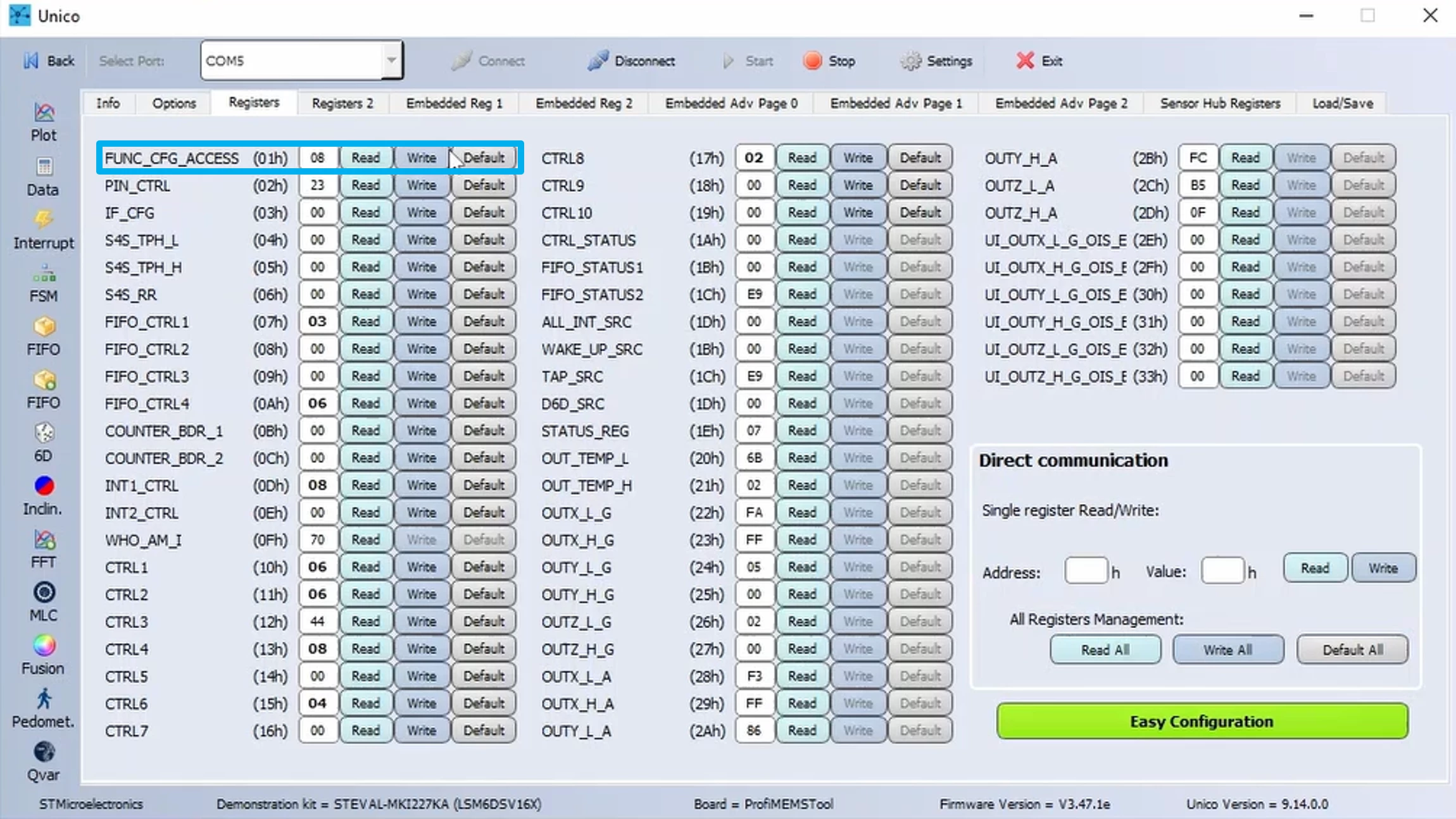

To allow the FSM to write the device registers using SETR commands (meaning to enable the ASC feature), set the FSM_WR_CTRL_EN bit available in the FUNC_CFG_ACCESS register. Go to the "Registers" tab to set manually this bit to 1.
Unico-GUI: Enable the ASC featureUnico-GUI: Enable the ASC feature

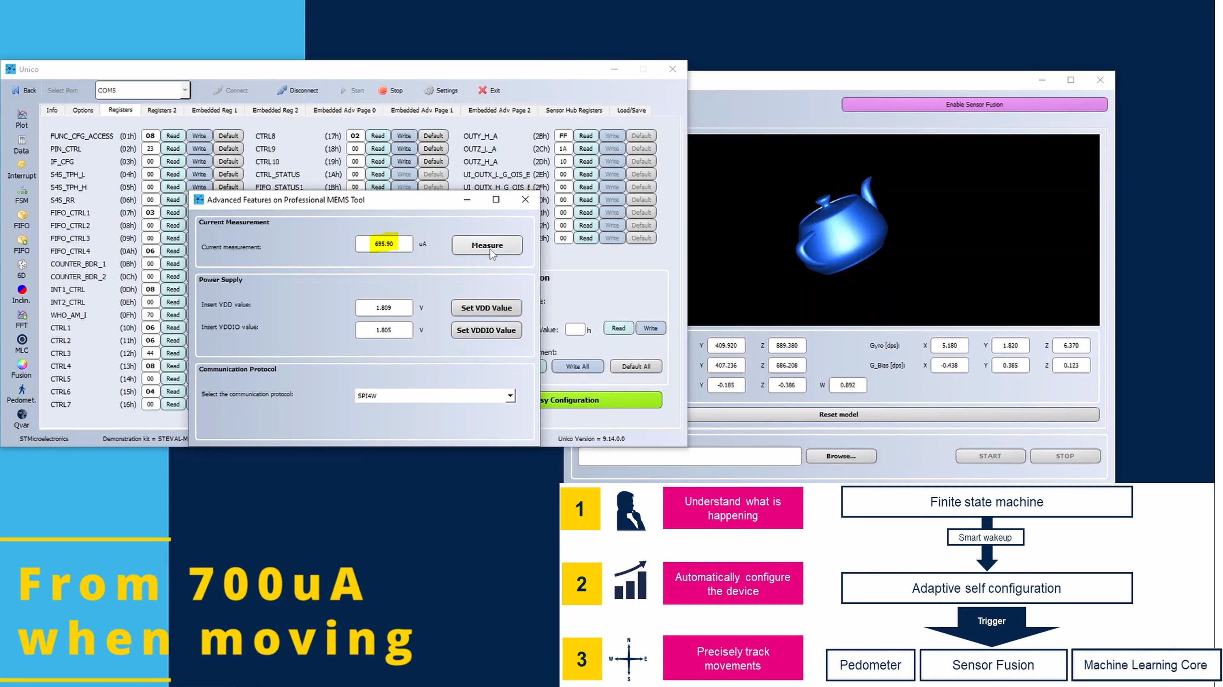

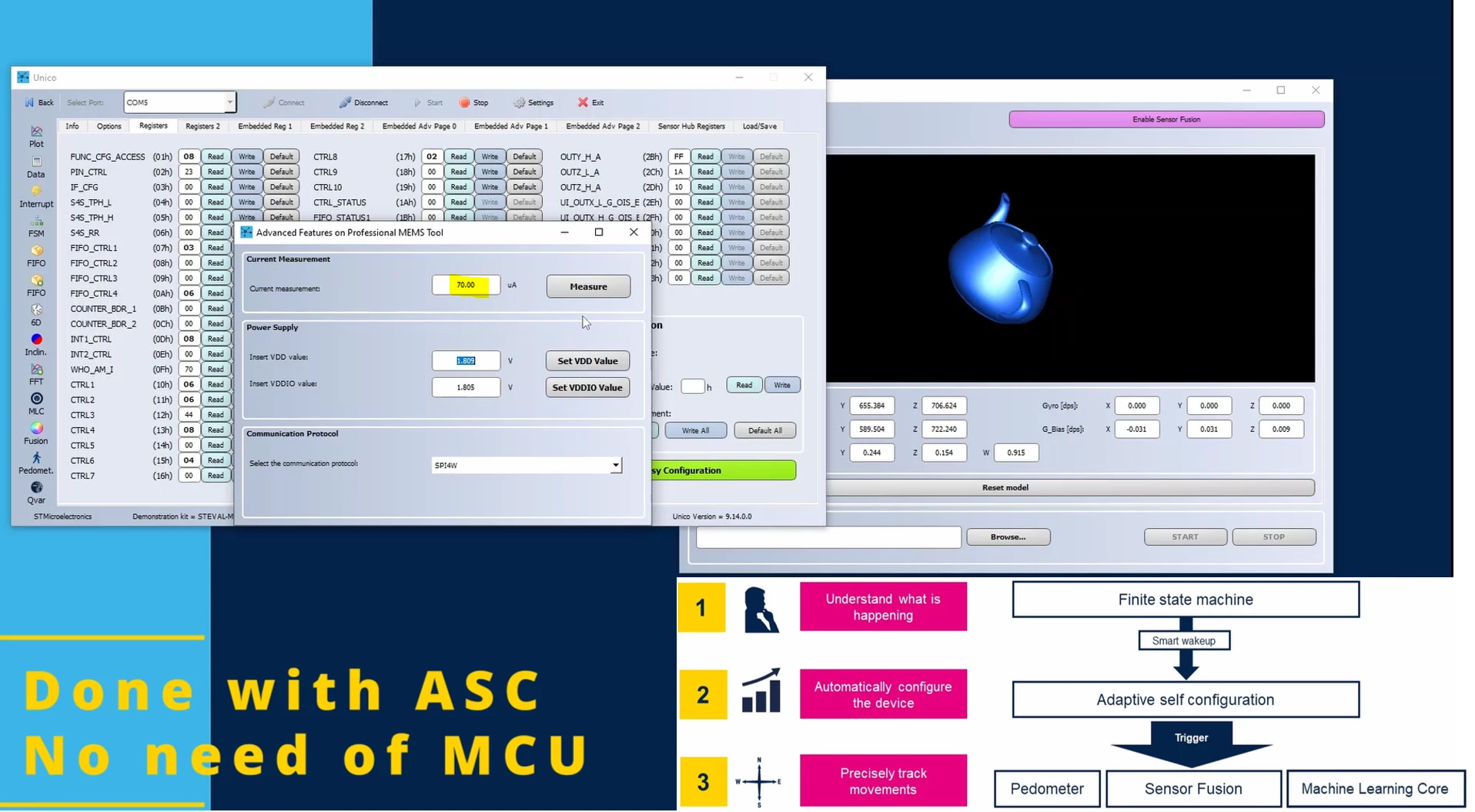

Open the "Fusion" tab again and the "Advanced Features" tab. During movement, we can see that the current consumption of the device is the same as before. But, when the board is stationary for more than 5 seconds, the current consumption drops significantly from almost 700 µA when moving, to 70 µA when stationary.
The current consumption drops significantly to almost 700 µA when movingThe current consumption drops significantly to almost 700 µA when moving
The current consumption drops significantly to 70 µA when stationaryThe current consumption drops significantly to 70 µA when stationary
