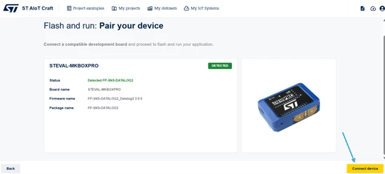

4.2 Firmware update
Connect the SensorTile.box PRO to your PC though a USB Type-C® cable, turn on the board in DFU mode.
If needed, refer to section 2.2 “How to program the SensorTile.box PRO in “DFU mode (via USB)" of the user manual UM3133 about SensorTile.box PRO).
Click the [Flash firmware] button to download and stream the firmware binary to the board. Ensure that your browser detects the connected SensorTile.box PRO.
Figure 3: Pair your deviceFigure 3: Pair your device
Once the firmware update is complete, establish a connection with the board by clicking on [Connect device].
Figure 4: Connect the deviceFigure 4: Connect the device

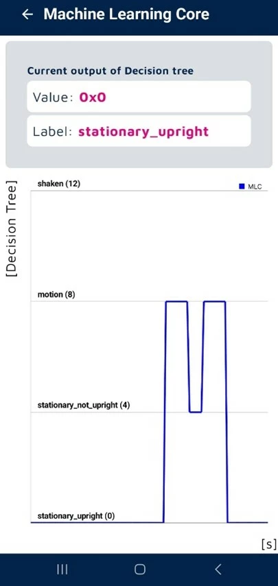

5. Mobile app evaluation
For wireless tracking, the ST AIoT Craft mobile app can be used.
You can download the app using the QR codes provided for easy installation which appear when you choose ST AIoT Craft mobile app as the working environment (see Figure 2).
Figure 6: Evaluate the AI model via the mobile appFigure 6: Evaluate the AI model via the mobile app
