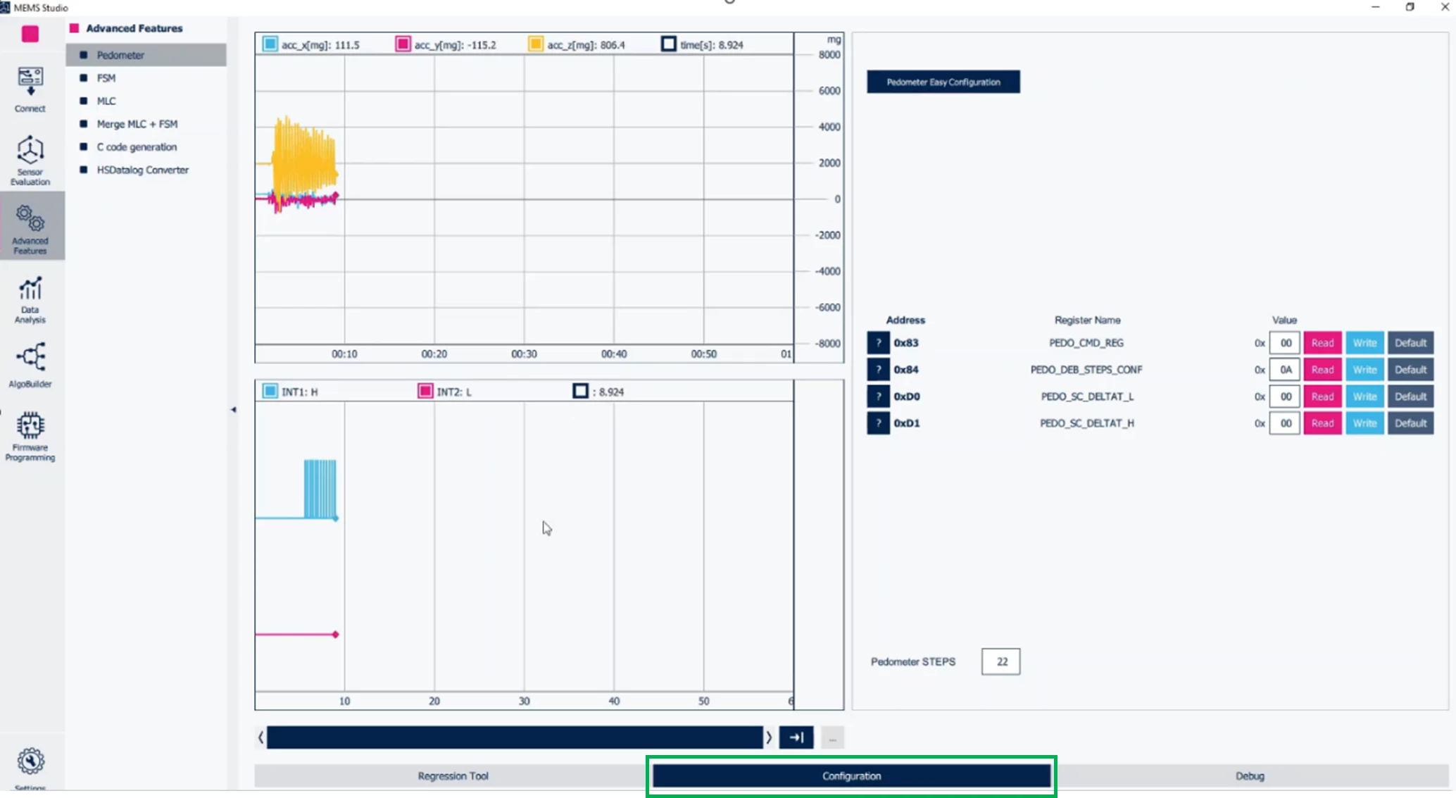

The [Pedometer] tool, for instance, can be used to configure and test the pedometer embedded in the device.
There are three different tabs for this tool:
[Configuration tab], which allows to easily configure the pedometer with its default configuration and evaluate the outputs in terms of steps detected.
Figure 1: Pedometer - Configuration tabFigure 1: Pedometer - Configuration tab

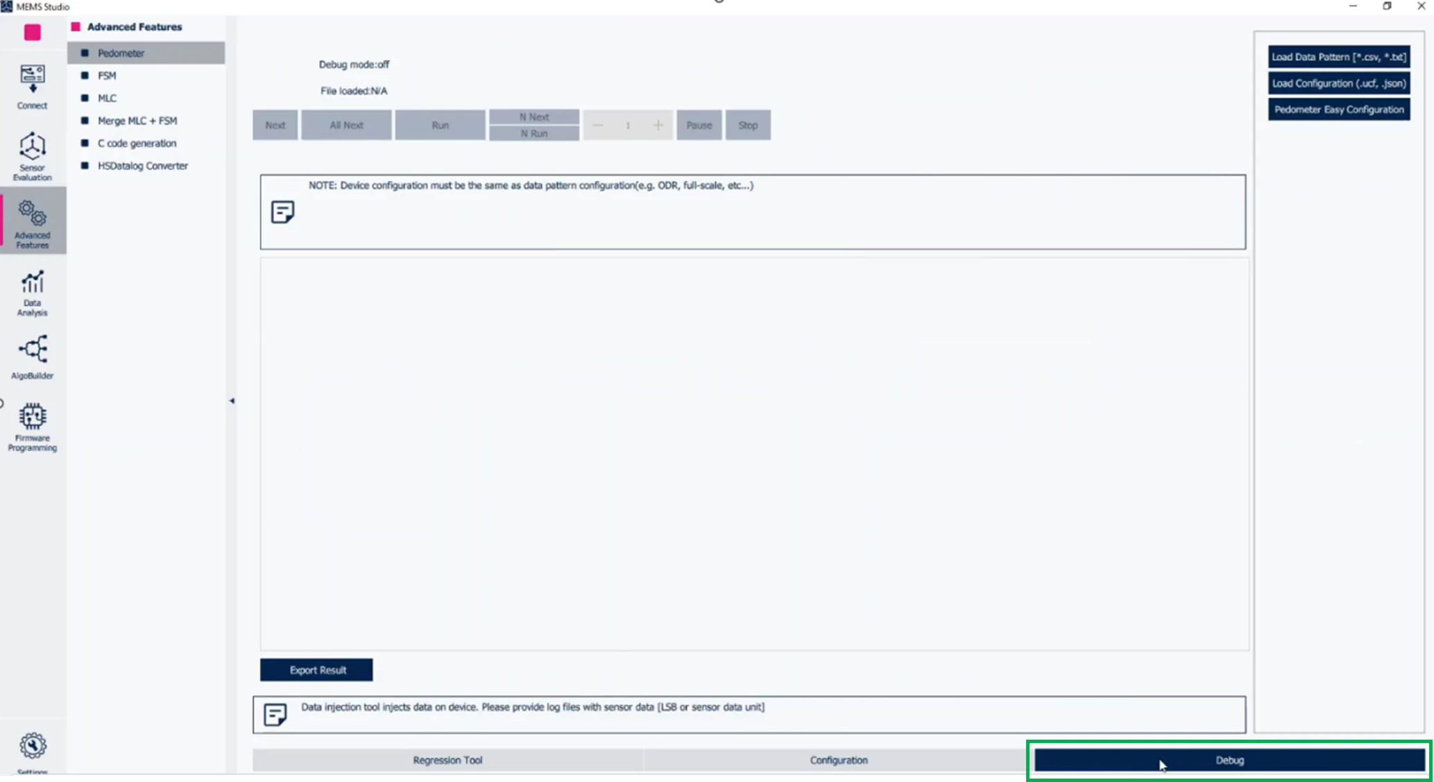

[Debug tab], which is used to load the data pattern into the device to test the pedometer on the data pattern loaded.
Figure 2: Pedometer - Debug tabFigure 2: Pedometer - Debug tab

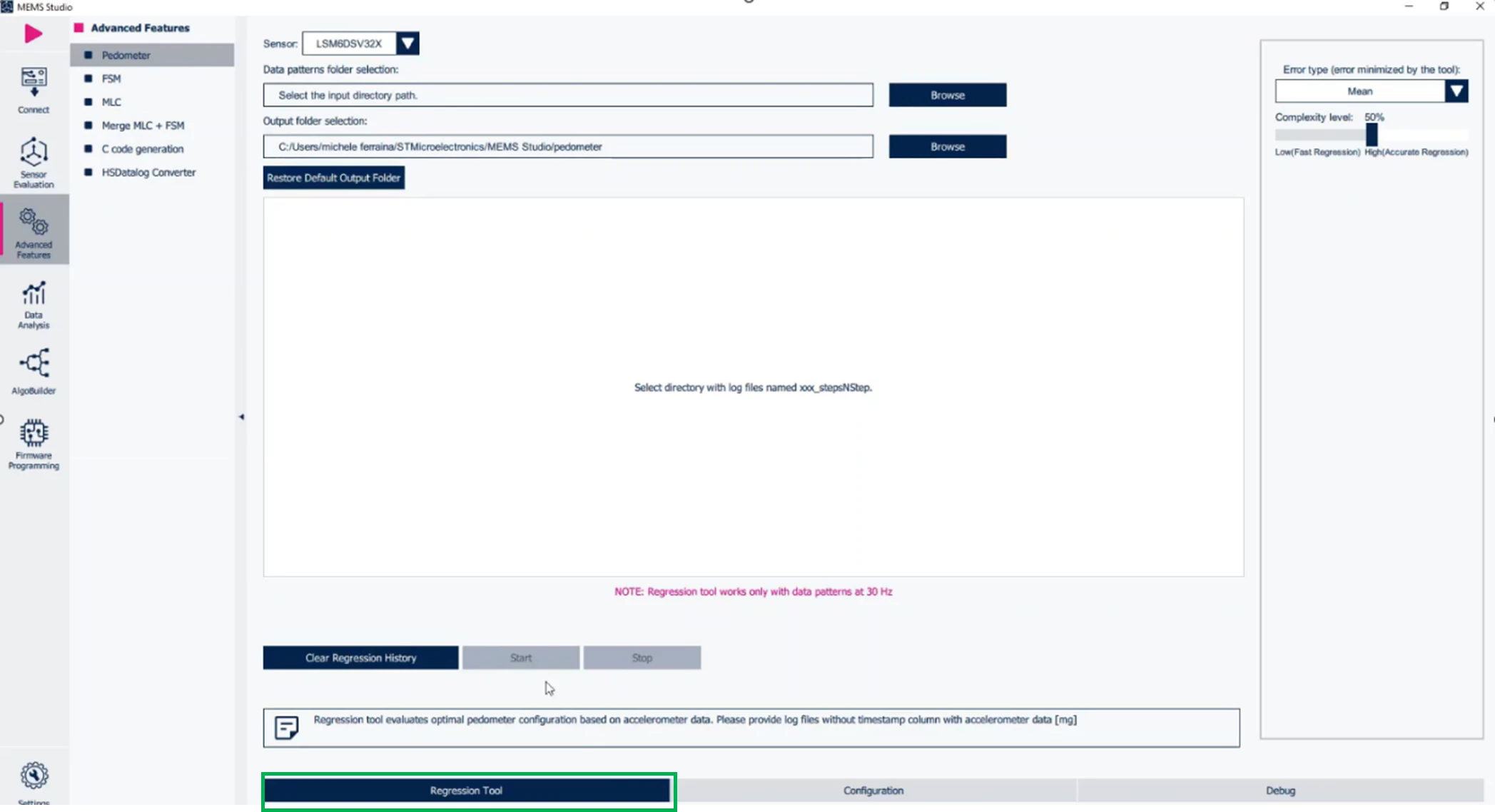

[Regression tab], which allows finding an optimal configuration based on the dataset you can provide.
Figure 3: Pedometer - Regression ToolFigure 3: Pedometer - Regression Tool

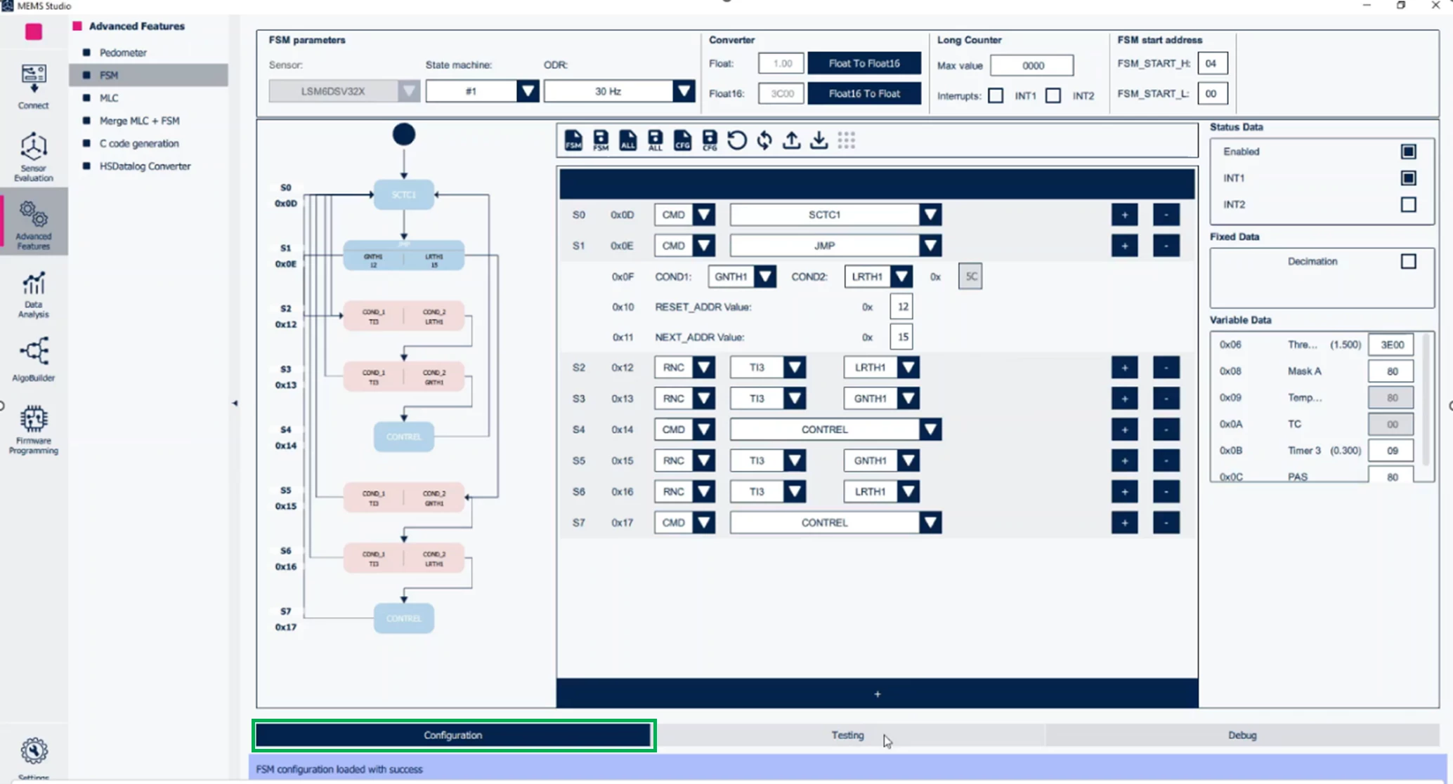

Another important tool in MEMS-Studio is the Finite State Machine [FSM] tool. This tool allows to configure different state machines embedded in the sensor from the [Configuration] tab.
Here you can see an example of the shake detection, which considers the lsm6dsv32x_shake.ucf file available on GitHub.
Figure 4: FSM - Configuration tabFigure 4: FSM - Configuration tab

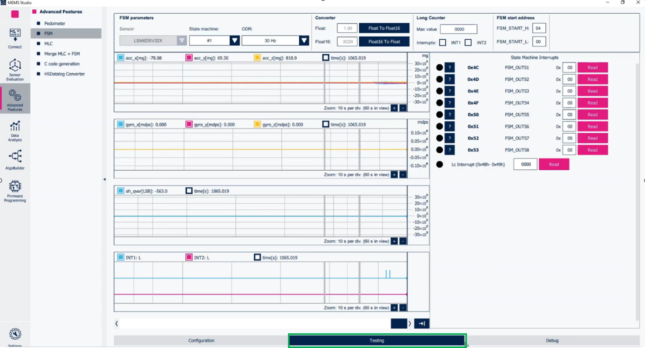

In the [Testing] tab, you can evaluate the configuration and check the generated interrupts and output registers information.
 Figure 5: FSM - Testing tabFigure 5: FSM - Testing tab

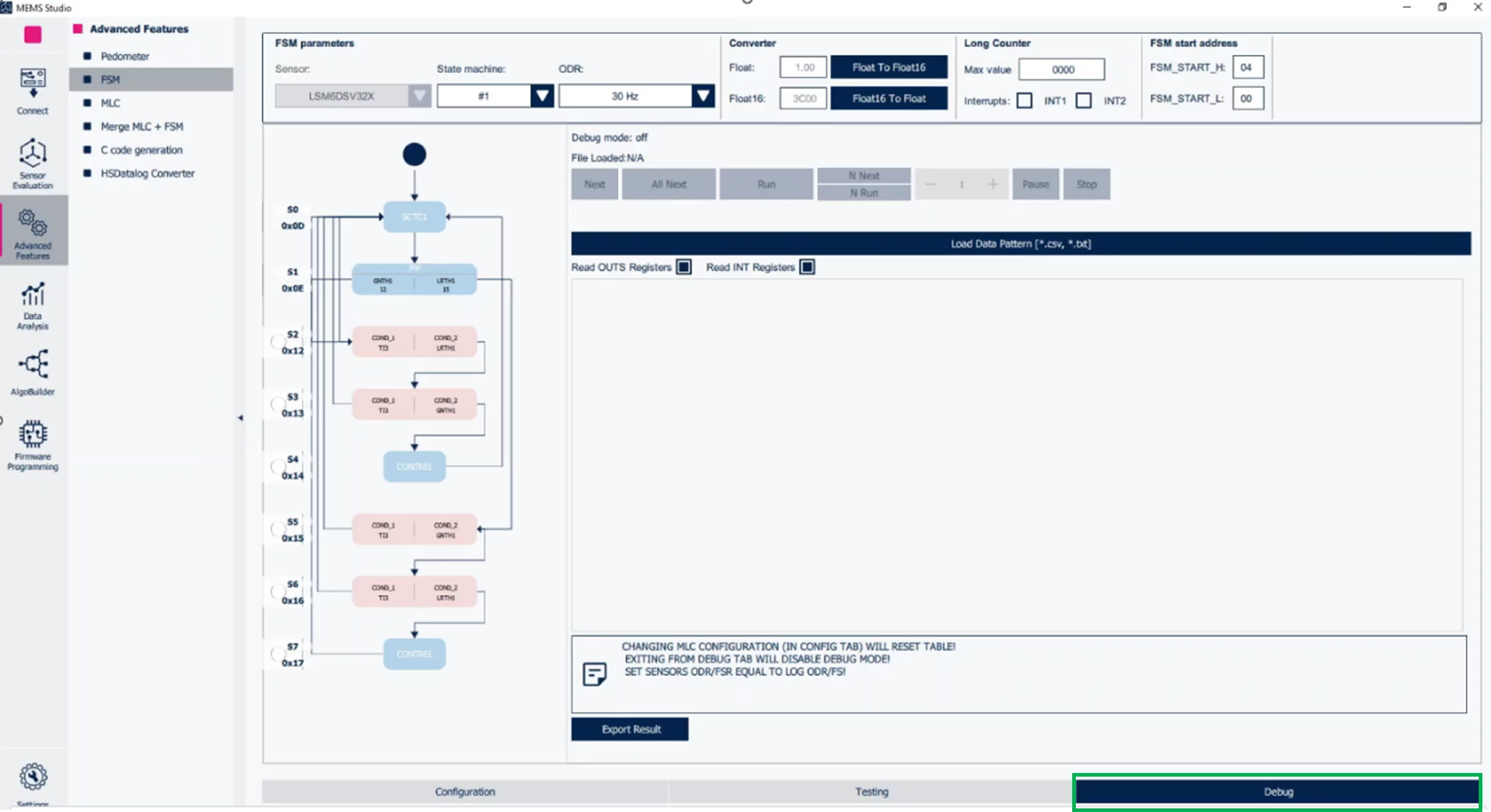

In the [Debug] tab, you can inject samples in the device to evaluate the state machine state by state.
Figure 6: FSM - Debug tabFigure 6: FSM - Debug tab

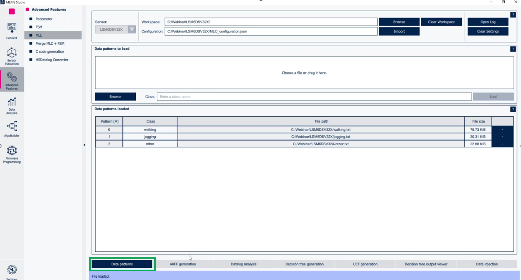

The [Data patterns] tab allows managing the data patterns to be used to and assigning a label to each data pattern loaded.
Figure 7: MLC - Data patternsFigure 7: MLC - Data patterns

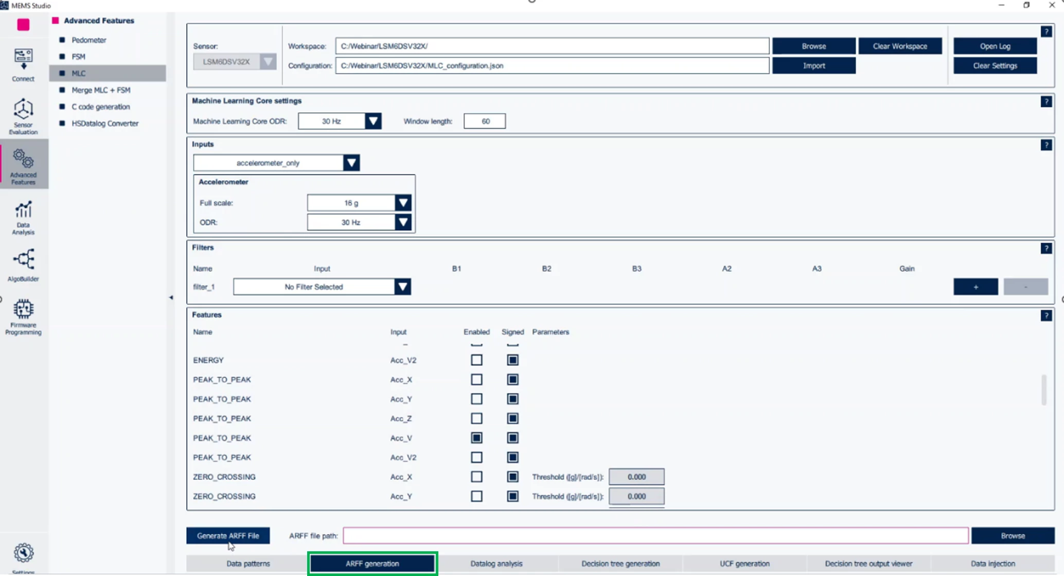

Then [ARFF generation] tab allows configure inputs, filters, and features to generate an ARFF file.
Figure 8: MLC - ARFF generationFigure 8: MLC - ARFF generation

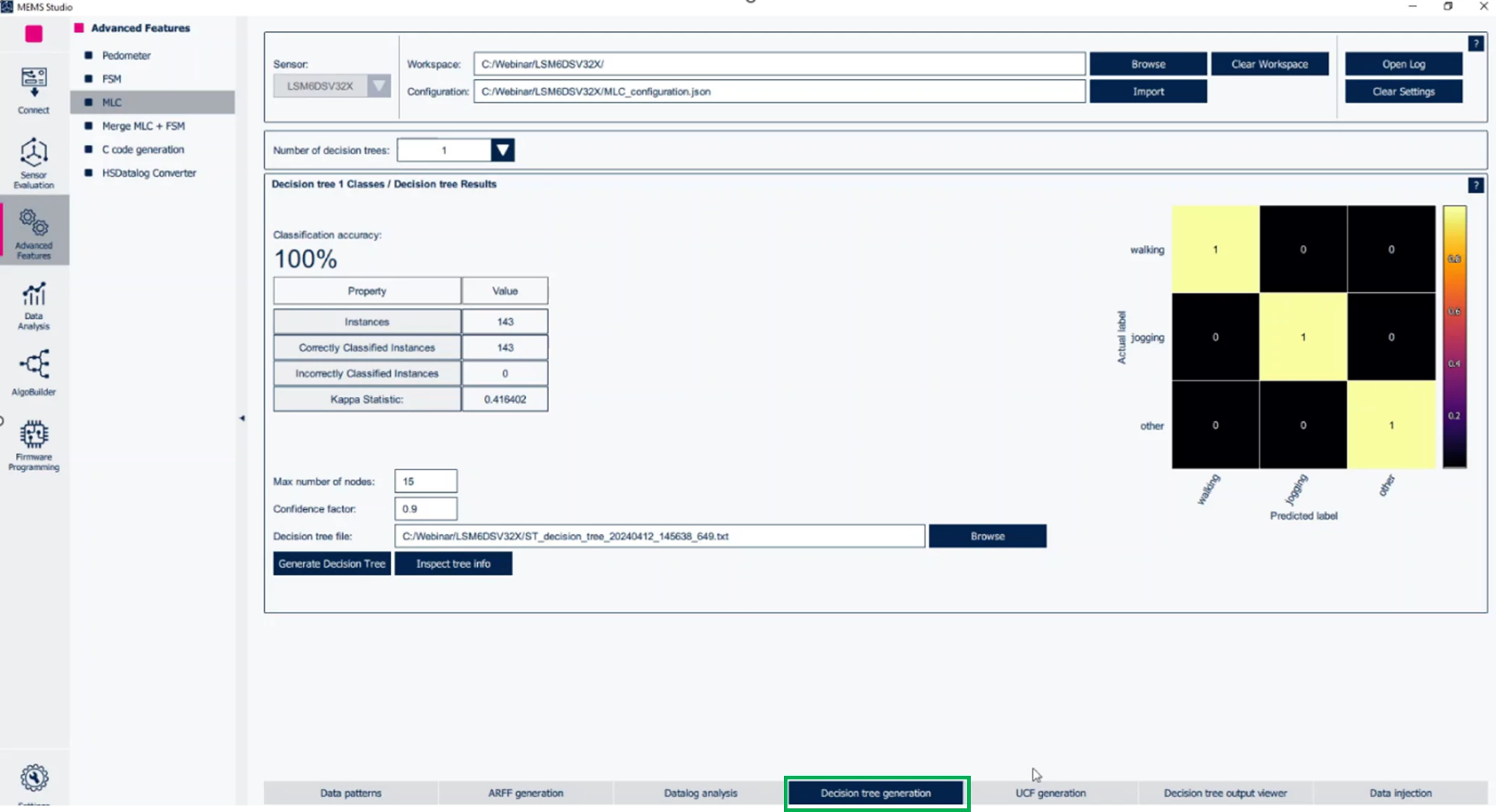

Then the [Decision tree generation] tab allows configuration of the decision tree outputs and generating the decision trees for the device.
Figure 9: MLC - Decision tree generationFigure 9: MLC - Decision tree generation

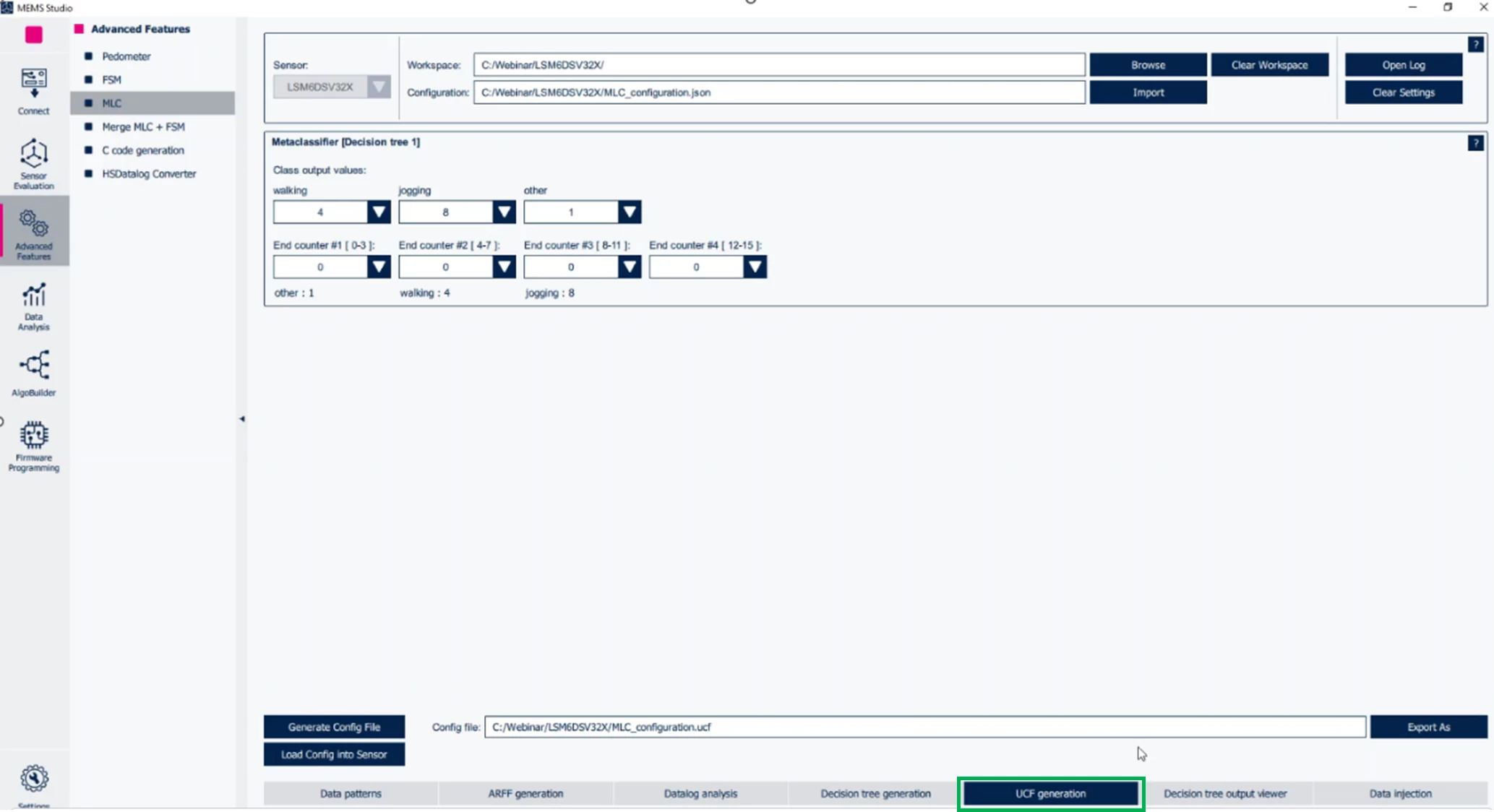

The [UCF generation] tab instead allows setting the meta classifier and generating the configuration file, which contains a configuration for the sensor.
Figure 10: MLC - UCF generationFigure 10: MLC - UCF generation

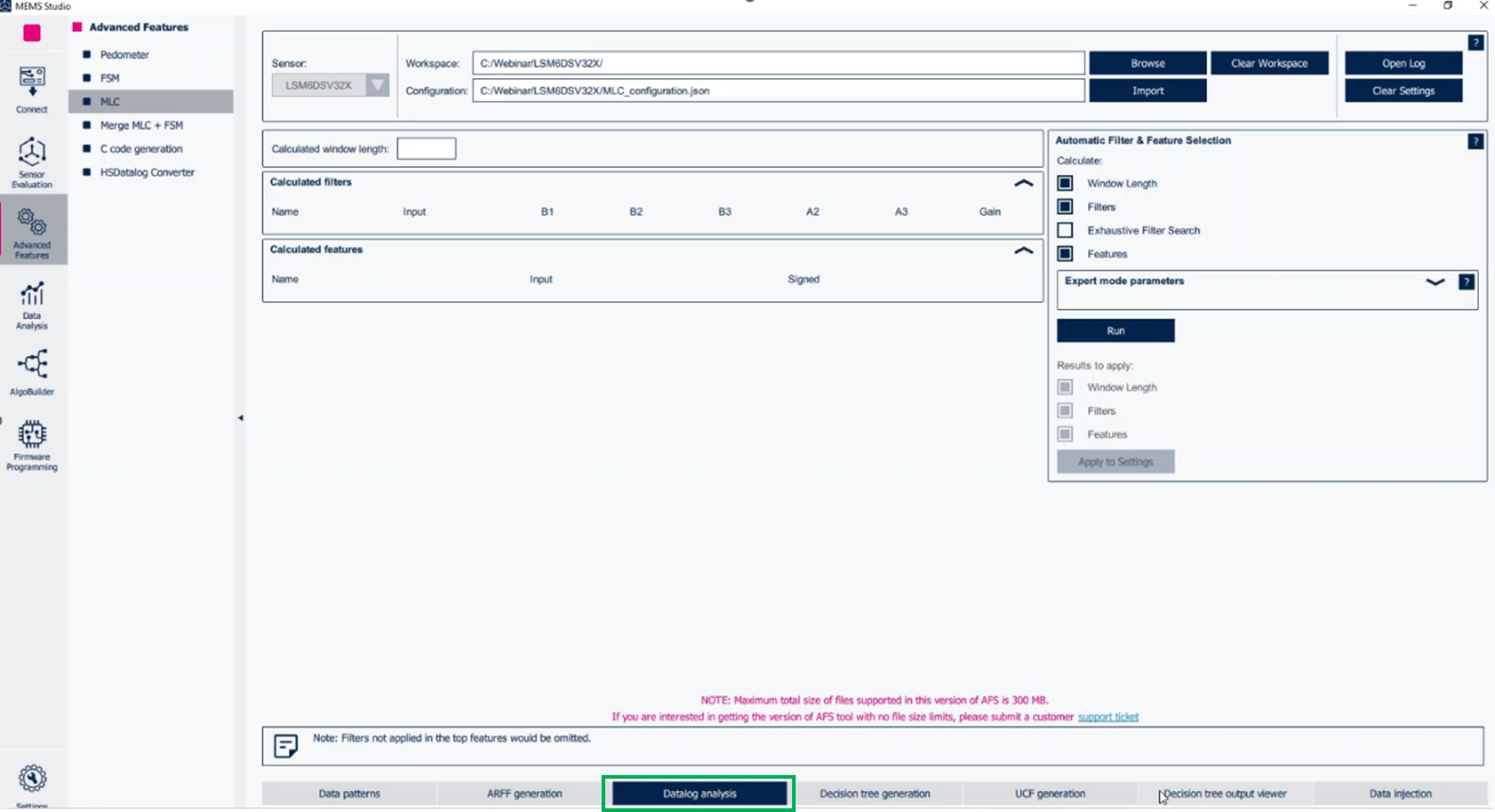

The [Datalog analysis] tab allows processing acquired data and recommends parameters like windows length filters and features that can be used for decision tree generation.
Figure 11: MLC - Datalog analysisFigure 11: MLC - Datalog analysis

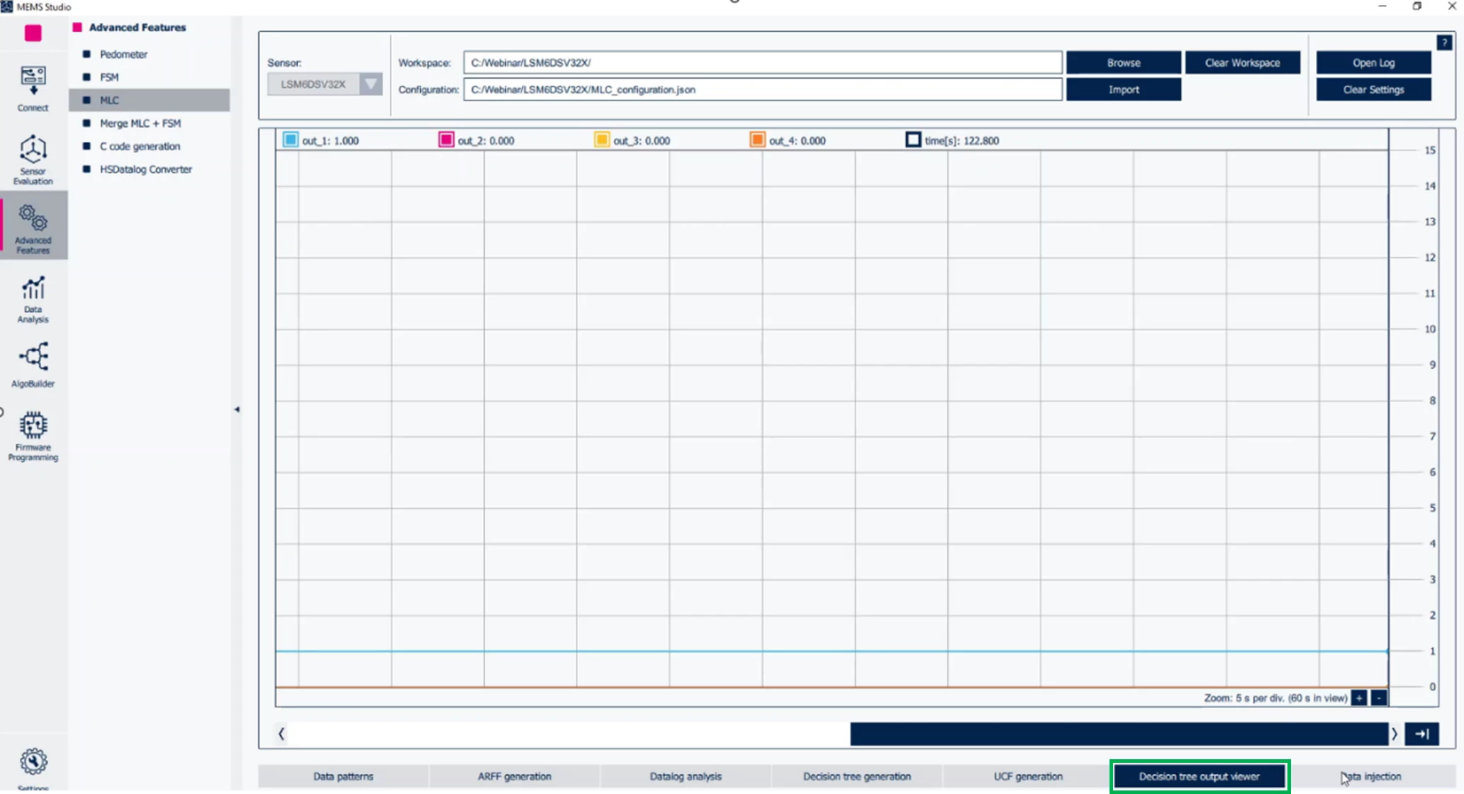

The [Decision tree output viewer] tab to test the configuration by looking at the decision tree outputs.
Figure 12: MLC - Decision tree output viewerFigure 12: MLC - Decision tree output viewer

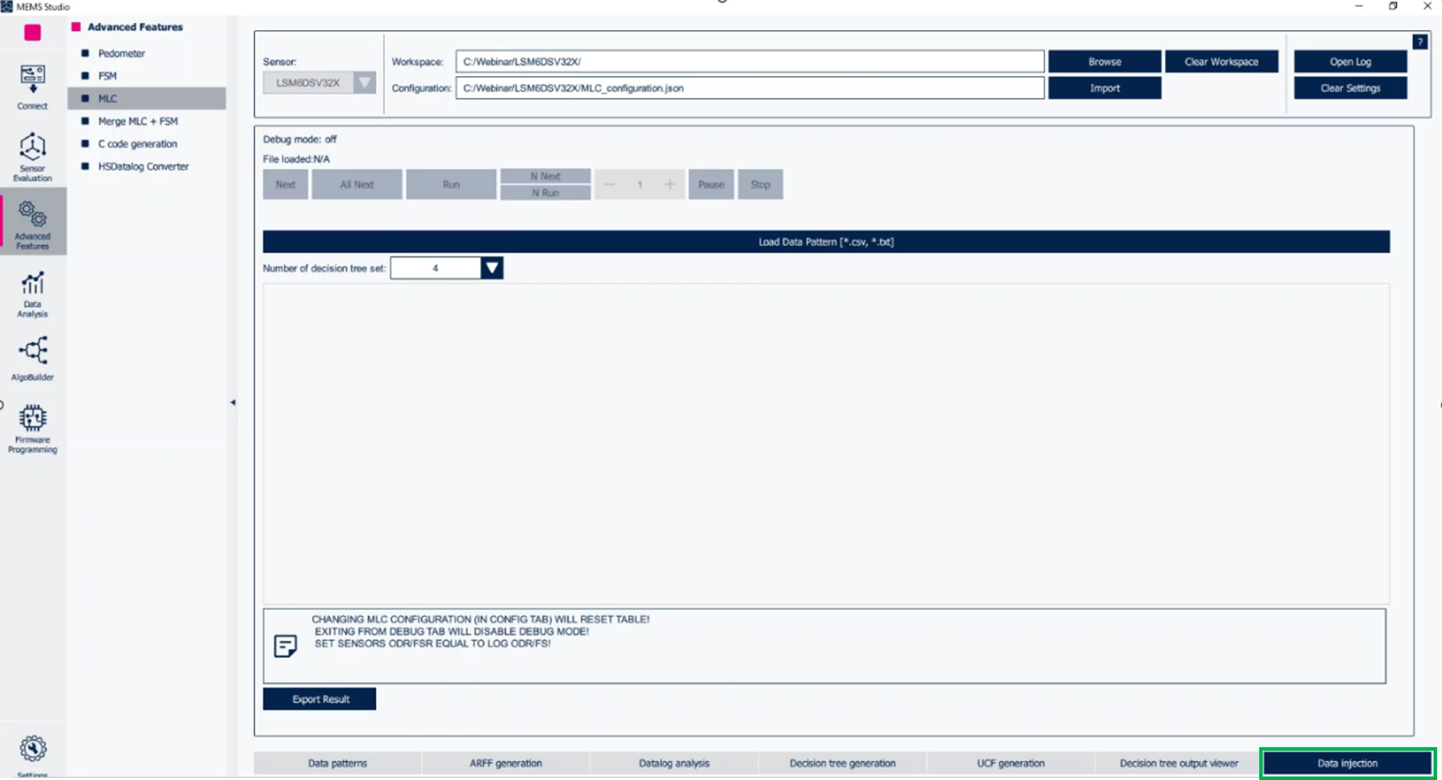

The [Data injection] tab to debug the configuration sample by sample.
Figure 13: MLC - Data injectionFigure 13: MLC - Data injection

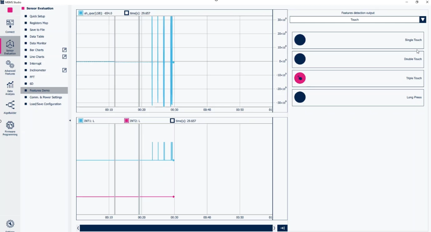

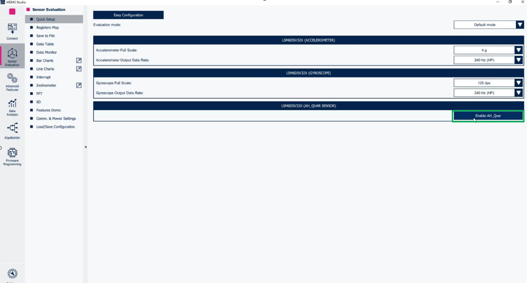

The STEVAL-MKI240KA kit contains the IMU LSM6DSV32X plus some electrodes for touch, swipe, and other applications. These applications are possible thanks to the Qvar embedded features in the sensor, where Qvar stands for electrostatic charge variation.
Inside the [Quick Setup] of the [Sensor Evaluation] tab of MEMS-Studio, you can enable the embedded Qvar feature clicking on the button [Enable AH_Qvar].
Figure 14: Sensor Evaluation tab - Quick SetupFigure 14: Sensor Evaluation tab - Quick Setup
In the [Features demo] section, you can select touch or swipe detection and evaluate. You can plot a single touch event, double touch, triple touch, single double, and long press inside the chart.
Figure 15: Sensor Evaluation - Features DemoFigure 15: Sensor Evaluation - Features Demo

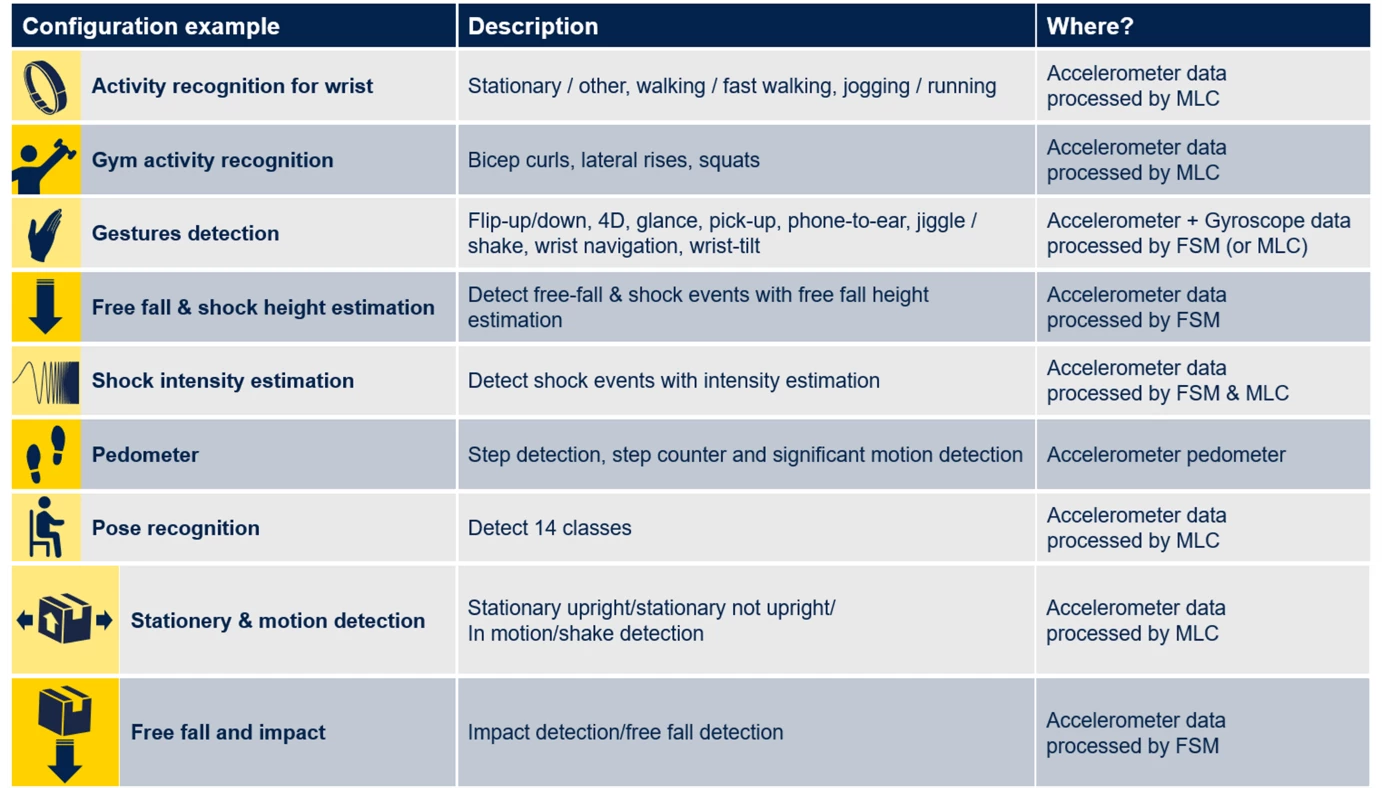

The following table shows other configuration examples that can be created. It is not exclusive to wearable applications configurations like gym activity recognition, gesture recognition and so on. It contains an asset tracking application using machine learning core and finite state machine available in ST MEMS sensors, such as LSM6DSV32X.
Figure 16: Wearable applications and asset tracking examplesFigure 16: Wearable applications and asset tracking examples

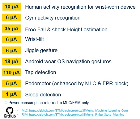

Using the edge processing capabilities in ST MEMS sensors you can minimize the power consumption of your application. In fact, since the application runs on the sensor, those solutions require a current of just a few microamperes (μA).
Figure 17: Power consumption referred to MLC/FSM onlyFigure 17: Power consumption referred to MLC/FSM only
