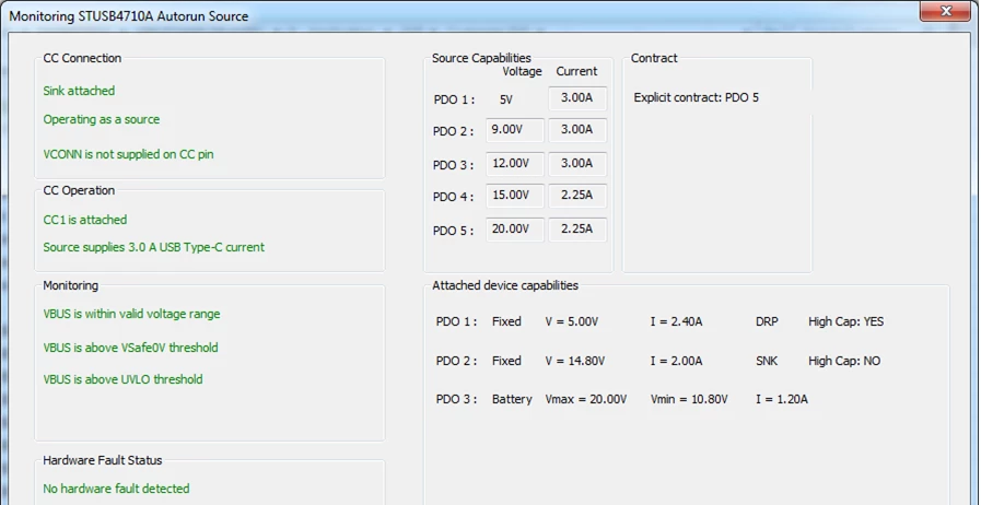

See bellow MacBook power profile reported by the GUI. Similar test could help to understand your laptop requirements

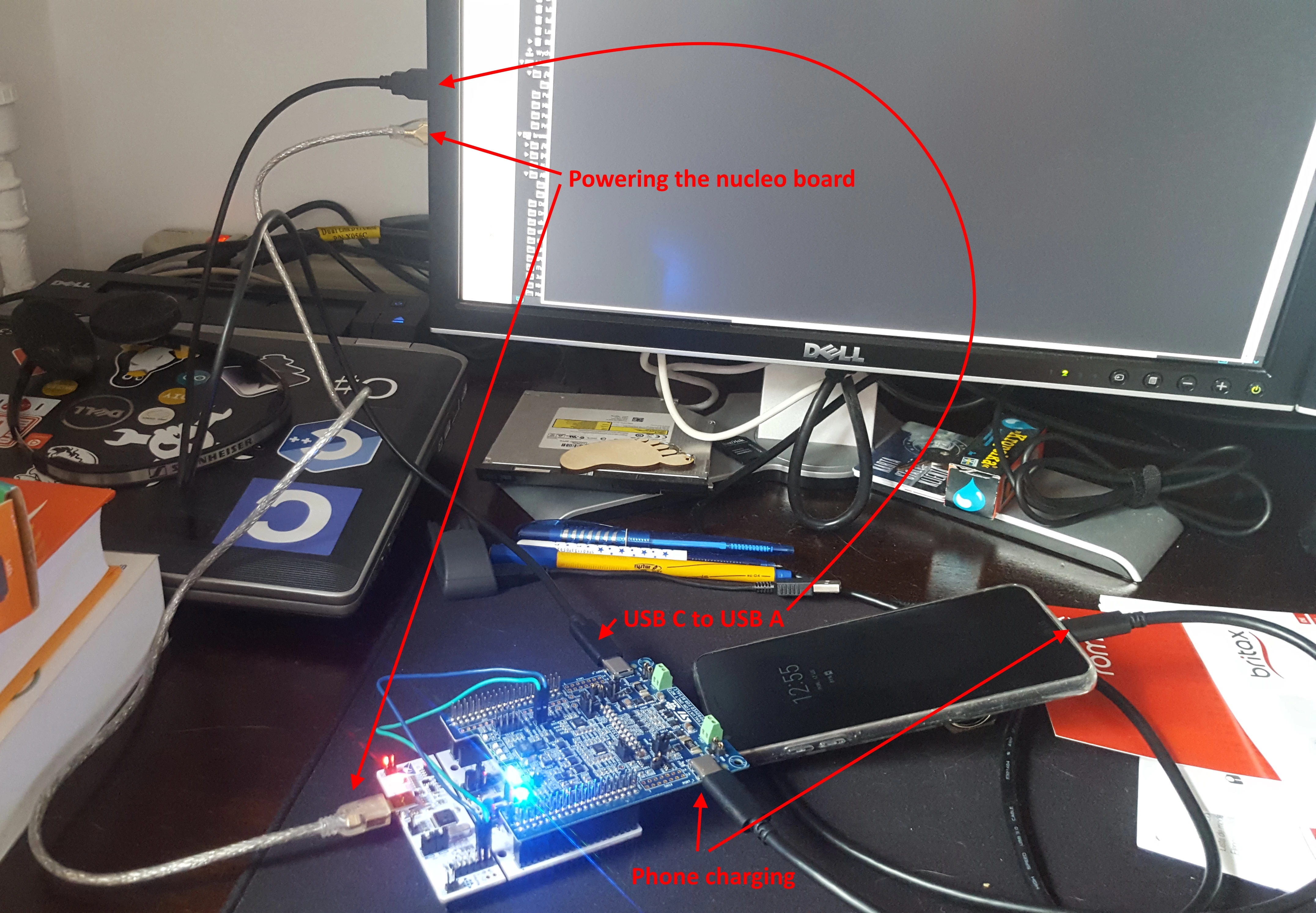

Hello Benoit, thank you for answer. Ok so I took the P-NUCLEO-USB002 and connected the wires and jumpers like advised in the manual. Bellow is a picture:
I connected to the serial console, we are good at this point:

Similar result... So Now I connect the USB C 0 of the P-NUCLEO-USB002 to my laptops hosts USB 2.0 socket (using USB C to USB A 2.0 male plug):
*** [0] attached on CC1 (Sink)
Seems to be working. Now I connect a mobile phone to the other connector of the P-NUCLEO-USB002 using USB C -> USB C cable:
*** [1] attached on CC2 (Source)
*** [1] detached
*** [1] detached
*** [1] attached on CC2 (Sink)
*** [1] selected cap #1
Some weird activity but works eventually, the phone is charged.

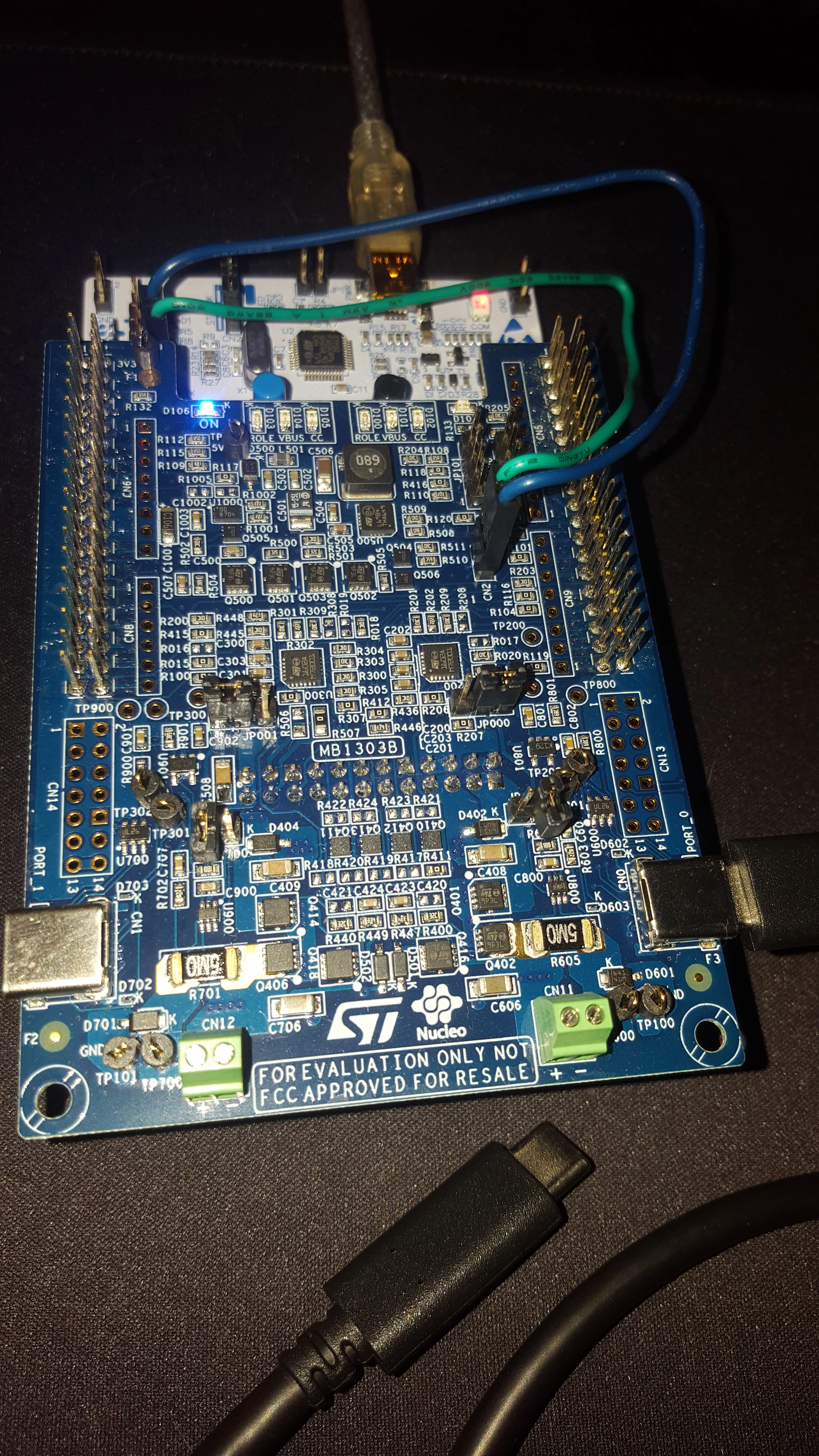

Benoit, thank you for answer. I did not close the JP400 and JP401 because they were open in the manual. Also the phone was changed, so I thought that was not the case. But yes, after closing them both I was able to successfully connect the USBC 0 and USBC 1 connectors of P-NUCLEO-USB002 board together:
P-NUCLEO-USB00x Demo v1.0.4
Console v0.4
Type help for a list of commands.
STMicroelectronics
Copyright (c) 2017 - All Rights Reserved.
*** [0] attached on CC2 (Sink)
*** [0] selected cap #1
So now I wanted to test the P-NUCLEO-USB002 -> STREF-SCS001V1 connection. The peripheral was correctly set to source. The thing is I keep getting the "selected cap X" message (I am not sure what does it mean exactly also):
*** [0] attached on CC2 (Source)
*** [0] selected cap #4
And goes on about every 3 seconds...
Do you know maybe what could be the case? Thank you very much for your help so far.

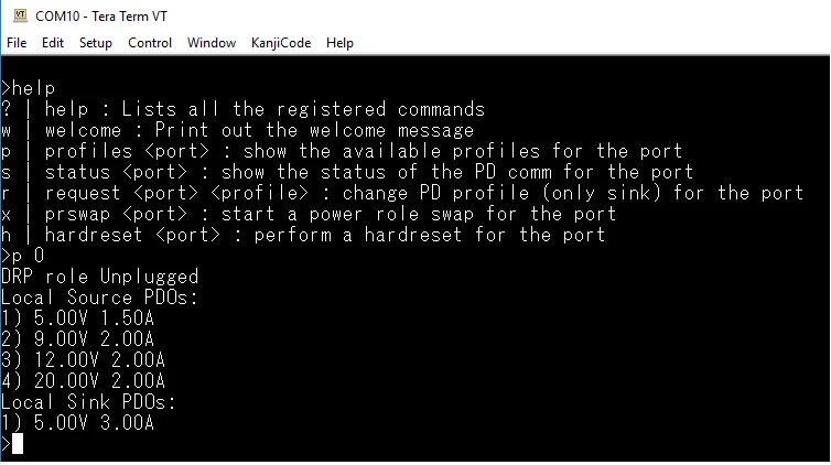

By default, the P-NUCLEO-USB002 virtually offers the bellow 4 profiles as a SOURCE,
And a single 5V profile as a SINK
That’s why when you connect both port of the P-NUCLEO together, they both connect at 5 (cap #1 => 5V/1.5A )
On the other side, STREF-SCS001V1 has the following SINK profiles:
  • PDO1: 5V / 1.5A
  • PDO2: 15V / 1.5A
  • PDO3: 20V / 1.0A
So when you connect both card together, the SINK will request PDO4 from the SOURCE (20V – 2A) as it matches what it needs (PDO3 from STREF-SCS001V1). This is what the P-NUCLEO tells you: [0] selected cap #4 (Cap #4 being the PDO4 with 20V – 2.00A.)
The issue is: as the P-NUCLEO, by default, can’t supply the expected 20V, then both devices will Hard reset (open the VBUS switches), terminate the type-C and PD transaction, connect again, identify, negotiate again etc… etc.. in endless loop.
This is why you see the message every few seconds. The boards behave properly, as the High voltage from the SOURCE is missing.
If STREF-SCS001V1 is not able to negotiate more than 5V with your laptop or dockin,
It means those 2 devices can’t offer the 15V;1.5A or 20V / 1.0A requested by STUSB45.
You can use the P-NUCLEO-USB002 as a SINK to understand the profiles from the 2 devices. It should confirm that default profiles from STREF-SCS001V1 is not compatible with your devices.
In this case, there are several ways to reconfigure the SINK profiles in order to align with the SOURCE (either by software with an external MCU or by changing the non Volatile Memory default). I can explain later.
benoit
