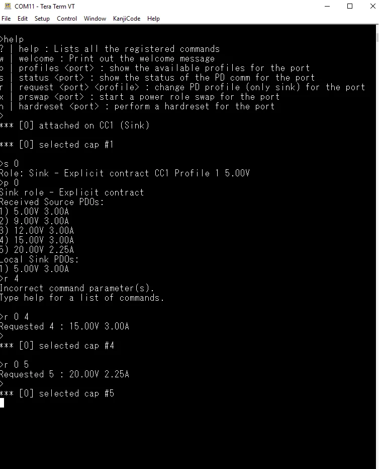

I started testing the p-nucleo-usb002 with STEVAL-ISC004V1 right ahead. I was able to choose all available profiles but 5th:
P-NUCLEO-USB00x Demo v1.0.4
Console v0.4
Type help for a list of commands.
STMicroelectronics
Copyright (c) 2017 - All Rights Reserved.
*** [1] attached on CC2 (Sink)
*** [1] selected cap #1
s 1
Role: Sink - Explicit contract CC2 Profile 1 5.00V
>r 1 1
Requested 1 : 5.00V 3.00A
r 1 2
Requested 2 : 9.00V 3.00A
*** [1] selected cap #2
r 1 3
Requested 3 : 12.00V 3.00A
*** [1] selected cap #3
r 1 4
Requested 4 : 15.00V 3.00A
*** [1] selected cap #4
r 1 5
Requested 5 : 20.00V 2.25A
*** [1] detached
When I connected the STREF-SCS001V1 to the STEVAL-ISC004V1, I got 20 V output, so this one works. What could be the case for p-nucleo-usb002?

Nov 14, 2018 5:49 PM UTC
​Hi Lukasz,
very strange. working properly on my side. Which Power supply are you using to power STEVAL-ISC004V1 (SOURCE)? We recommend 24V DC to supply the DC/DC from the board and ensure clean 20V output. What might happen is that the DC/DC can't regulate properly at 20V, so either the SOURCE and the SINK may terminate the connection as not in line with the expected contract (20V) +/- OVLO/UVLO (usually 10% if I remember well). In this case, the 2 different SINKs may have different settings, explaining the difference.
rgds,
Benoit
Lukasz Przenioslo
Nov 14, 2018 5:52 PM UTC
Hi Benoit,
I was providing 23V from a lab AC adapter. Didnt try 24 V. The sink device has the default settings. The day after tommorow I will be at the office again. I will try with higher input voltage, thank you.
Lukasz Przenioslo
Nov 16, 2018 1:31 PM UTC
Hello Benoit,
I just tried connecting 25 V to the STEVAL-ISC004V1. I was able to successfully switch to the last profile like you now using the p-nucleo-usb002. Probably voltage drop on the DC-DC converter was to high. Thank you for help.

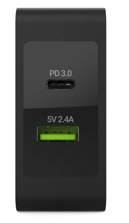

Btw, I wanted to test how would the p-nucleo-usb002 act after I connect a generic USB charger to it, like this: https://allegro.pl/ladowarka-gc-usb-c-45w-laptopa-acer-asus-dell-hp-i7527595704.html (frogive the polish language). Anyways, the specification says that it should support the following profiles: 5V-3A, 9V-3A, 12V-3A, 15V-3A, 20V-2.25A.
After I connected it to the p-nucleo-usb002 connector, I havent seen any event in the terminal nor on the leds- like the p-nucleo-usb002 didnt notice this charger at all. What could be the case here, since it is possible to charge a mobile phone using this USB C charger?
Nov 16, 2018 2:48 PM UTC
Hi Lukasz,
no reason, it should connect properly. Have you tried connecting ​the STREF-SCS001V1 to this USB charger? it should connect at 20V automatically if I cross properly the PDO from both devices.
benoit
Lukasz Przenioslo
Nov 16, 2018 2:49 PM UTC
Yes I did,
Nothing happens as well (no led)...
Nov 16, 2018 3:06 PM UTC
​so, if both boards (which use different devices) reject the original attach, it means there could be an issue with the SOURCE (VBUS different from vSafe 5V, discharge issue, not cold socket etc...) or with the Type-C cable (please use the one from P-NUCLEO-USB002 pack when possible). Do you confirm both  boards still work with STEVAL-ISC004V1? If you can't find the issue, I'm interested to borrow your AC adapter to have a look at it (and ship back of course). Did you perform some trials with your DELL laptop?

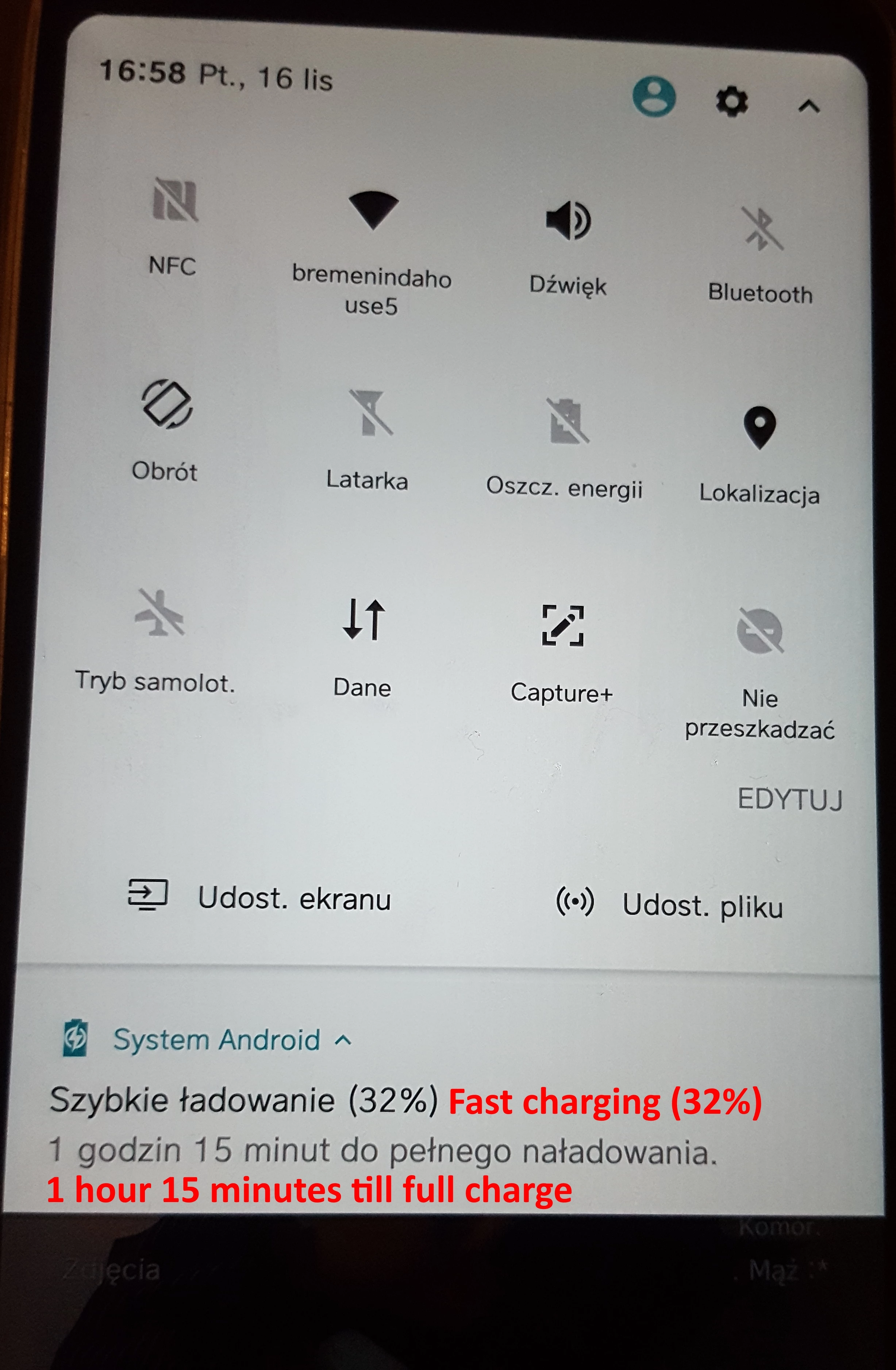

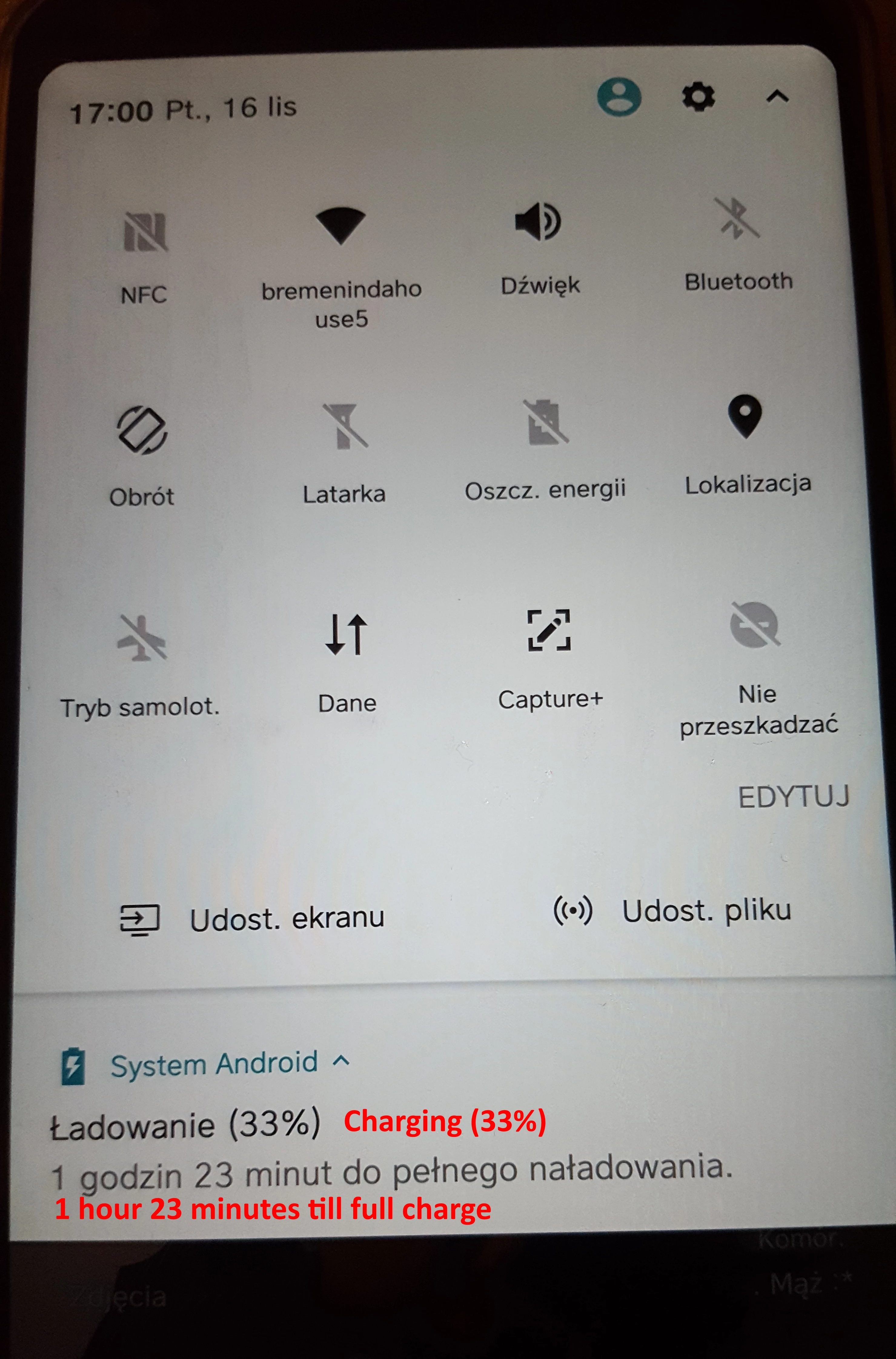

As for the mentioned charger, it consists of 2 ports: USB A and USB C:
If I connect my android phone to the USB C (USB C ,-> USB C cable), I get a system message that fast charging is in progress:
While if I connect it to the USB A ports (using USB C to USB A plug cable), I get regular charging:
This would suggest that the phone made a handshake with the charger over USB C. I wonder why didnt this work with the eval boards.
