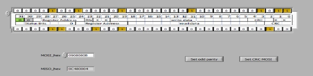

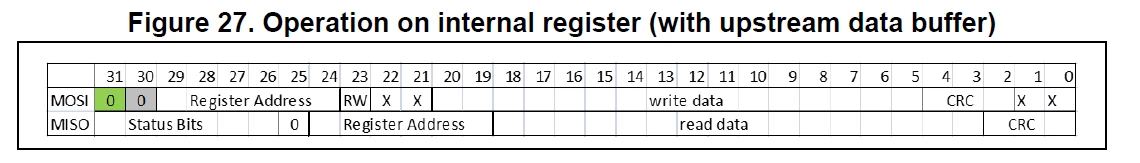

We are sending 32 bit frames to the device formatted as specified on the datasheet (Frame definition section, pages 84-85) .
However, the IC is not responding to any SPI commands, and the MISO line stays always high. We have verified that the SPI module of the STM32 board functions properly, by interfacing a MCP2515 SPI CAN controller successfully. i.e. getting an SPI response and activity on the MISO line.
We have also verified that the number of clock cycles for each SPI transaction is correct (32 clock cycles as specified on the datasheet, page 87).
