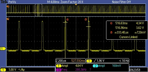

    I've tried to send something with both channels (0 & 1) also the following trames on the mosi line : (0x88000014 & 0xC8000010) but I still have nothing on the miso line.
    I have tried to mesure the voltage and the current on the PSI5 line 1 with an oscilloscope and a current probe.
    I have a signal like on the figure 17 page 32 at 7.8V but i see nothing with the current probe.

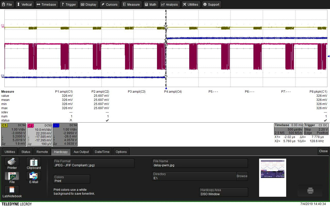

    Jul 4, 2019 4:10 PM UTC
    Hi Tom,
    I put VAS to 5.2V and disabled the adress multiplexing mode that I forget and it run well.
    I'm checking the value of the register with a sniffer. (Saleae logic analyzer)
    I'm not sure if i'm reading the value the right way.
    I first send the following trames NO SID, payload 20 bits i wrote 0xC8000014 and I read 0x0F3E0006 on the miso line.
    It correspond in one case : page 31 table 6 1F0 Databuffer empty and the lower 10 bits are filled with 0.
    but I also see on page 32 : In both synchronous and asynchronous mode, when a valid data is read, the buffer empty
    code 1F0 is written in the buffer.
    The question is where are the data ? I mesure that with my oscillscope :
    C1 is the voltage on the PSI-5 line
    C2 is the current modulation on the PSI-5 line that I receive back
    C3 is the interrupt line which say for a asynchronous operation : Asynchronous operation:
    The interrupt pin is set to high when the number of received data since the last reading of
    register is as large as the size of the receive buffer. The interrupt pin is set to low when all
    the buffers are empty.
    I try to read UDB1-1...4(because it think UDB1-1...4 is the fifo in asynchronous mode) but the data are read data are filled with 0 (default value of UDB1-1...4).
    Can you help me with this problem ?

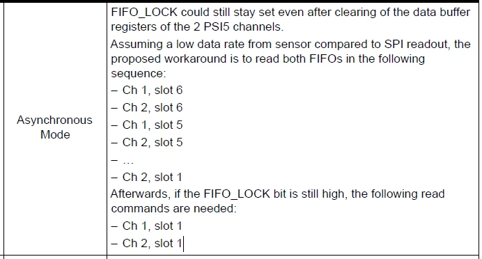

    ​Hello Fabrice,
    As it is mentioned in data sheet, the contents of UDB1 determine the SYNC pulse length and it doesn't contains the sensor data. In asynchronous mode sensor data registers are working as a FIFO buffer with 6 stage.
    So in order to read the sensor data in asynchronous mode you need to read the sensor data registers through SPI frame as shown in Figure 29 (page 86).
    Please pay attention that SPI communication is out of frame, so you need to send 2 times the read SPI frame. the received MISO of second frame will be the sensor data you expect to read.
    also consider the following procedure for reading sensor data:0690X000009YZsHQAW.png
