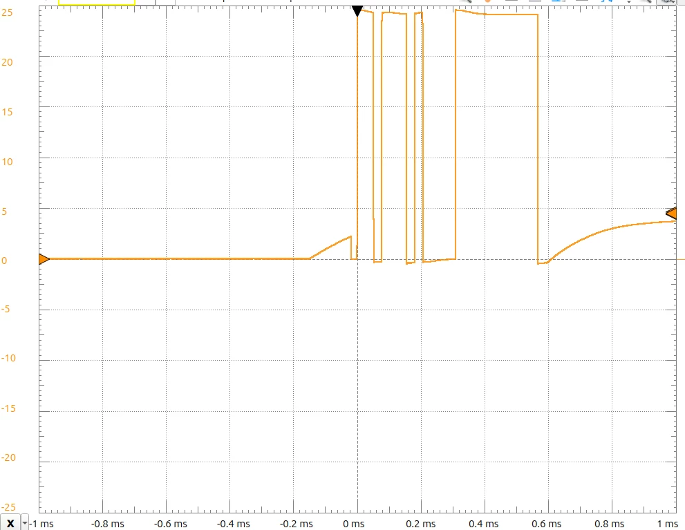

    Hello, after many attempts, I think I have managed to generate a signal similar to the WURQ, but I still don’t get any reply from my sensor (Festo SFAH-10B flowmeter). Do you have any suggestions?Screenshot from 2025-10-31 14-01-20.png

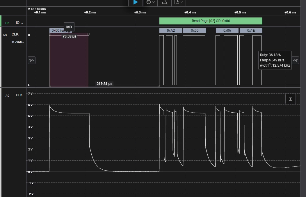

    Like many of you here, I have had great difficulty creating the elusive WURQ with the L6360. I’ve given up on triggering the WURQ and have tried simulating it, similar to TinLethax’s solution. In order to generate the WURQ, I’ve set the UART baud to 126000, then sent a 1 byte transmit of 0. This creates the ~80us pulse. Then I reinit UART with the correct baud, in my case 230400, and I am now able to receive messages back from the sensor. Hope this helps someone.
